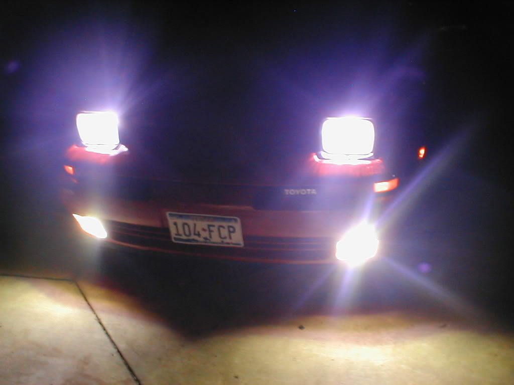

best pic I have right now, doesn't show cutoff, but there is a thread on here with them. I have 3000K fogs and 4300K headlights. Crappy camera, the glare is really nothing like this...
