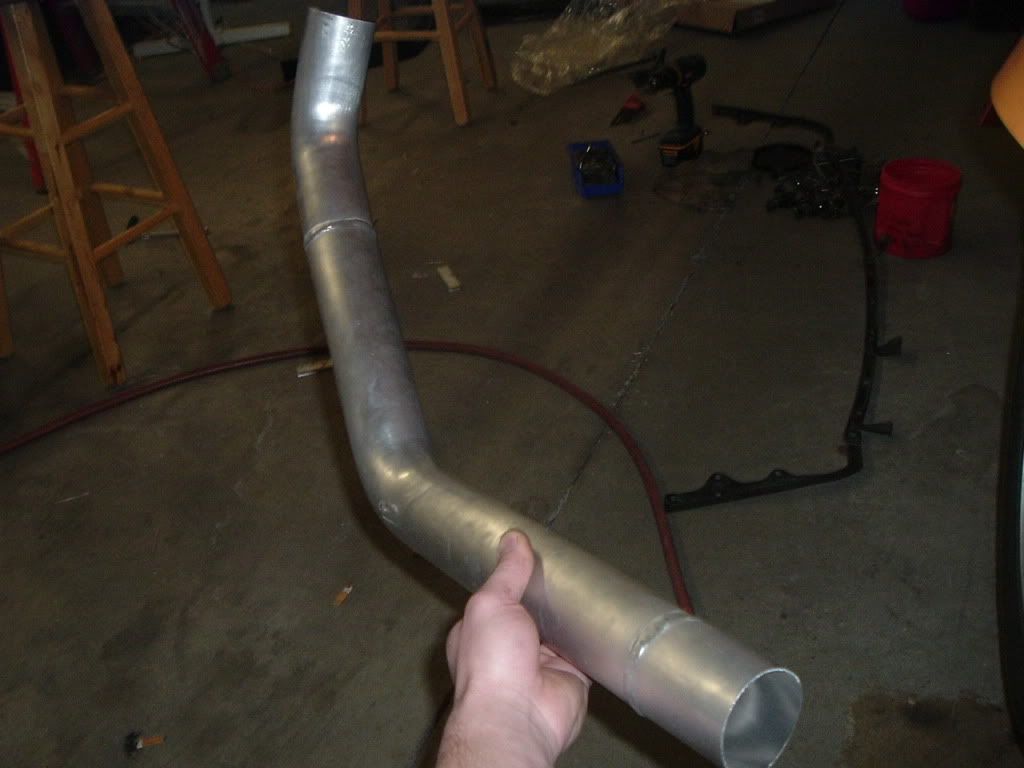

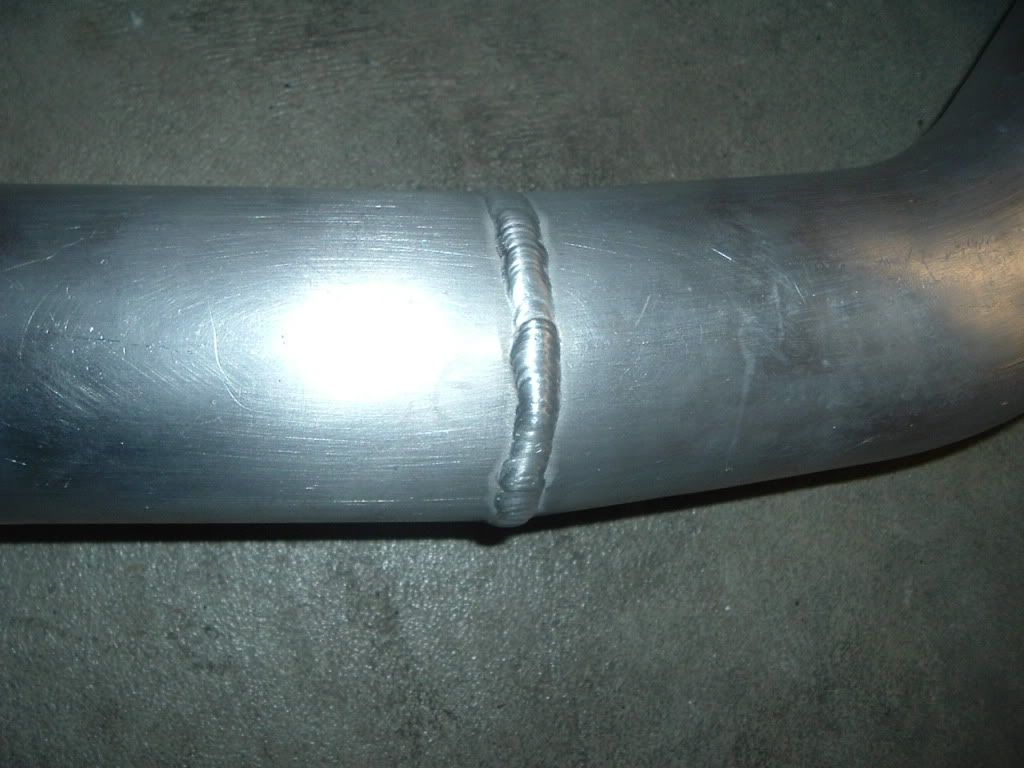

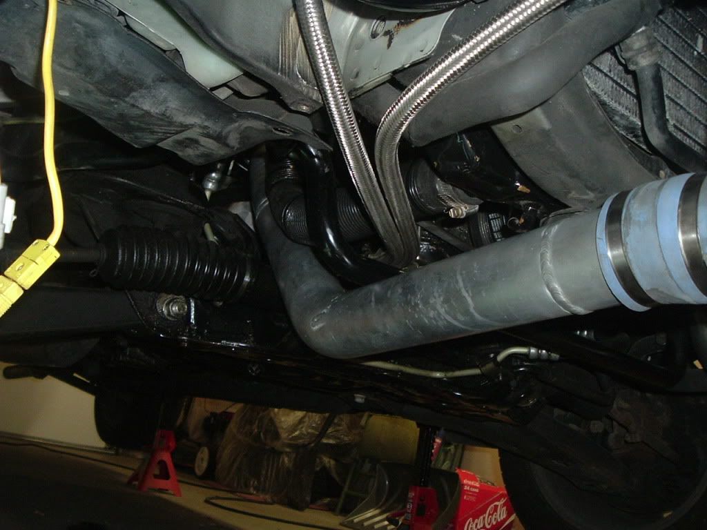

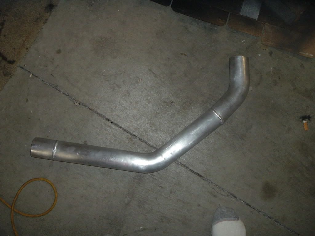

I also mocked up the hot side intercooler piping and had Pappy bring it home with him to weld up. We were going to weld it up yesterday / last night, but the beer was tasting good and ran out of time :rofl:
92nsx
Sep 30, 2005
2,957
Clearwater, MN
pappy can weld pretty dam good! A lot better then I could do.

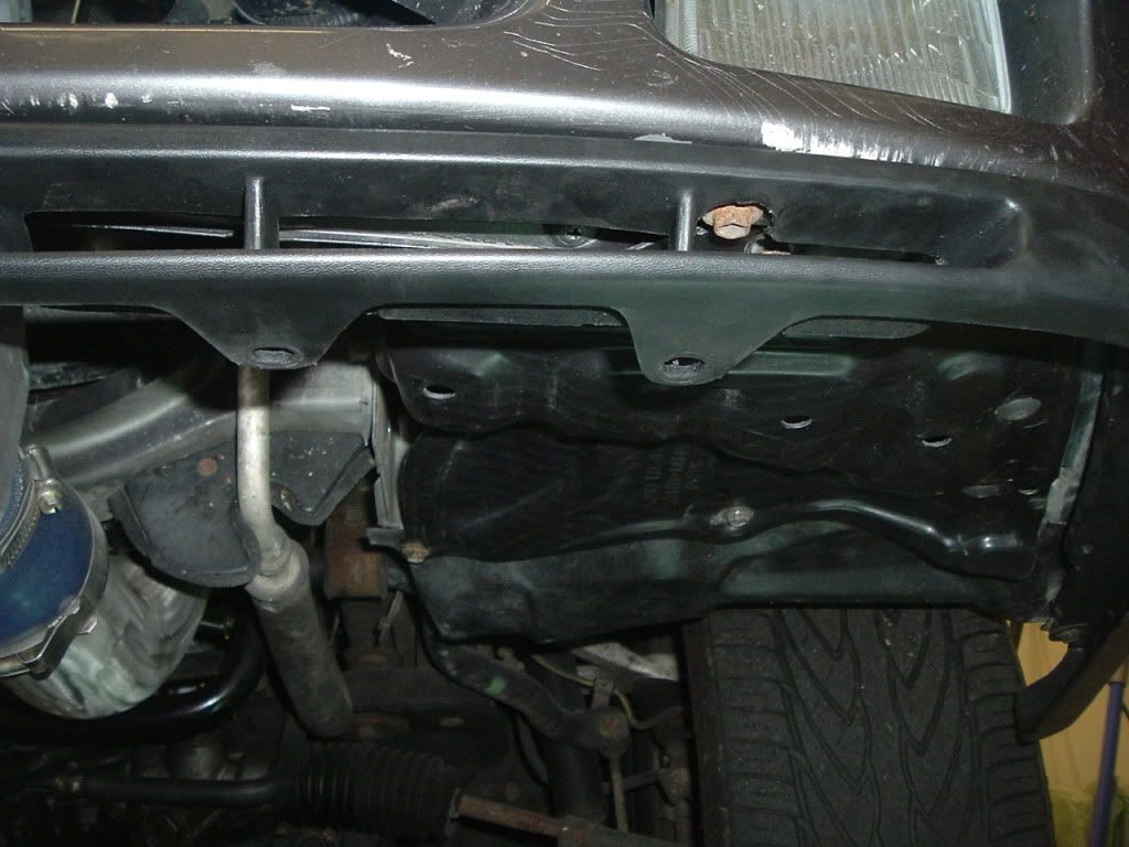

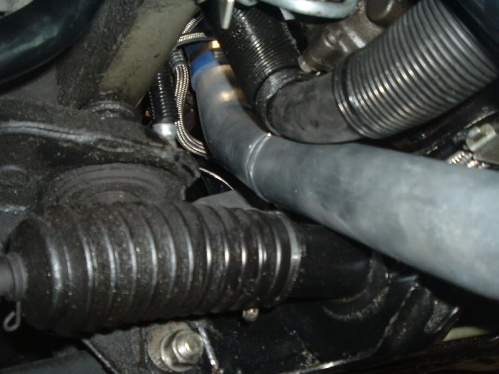

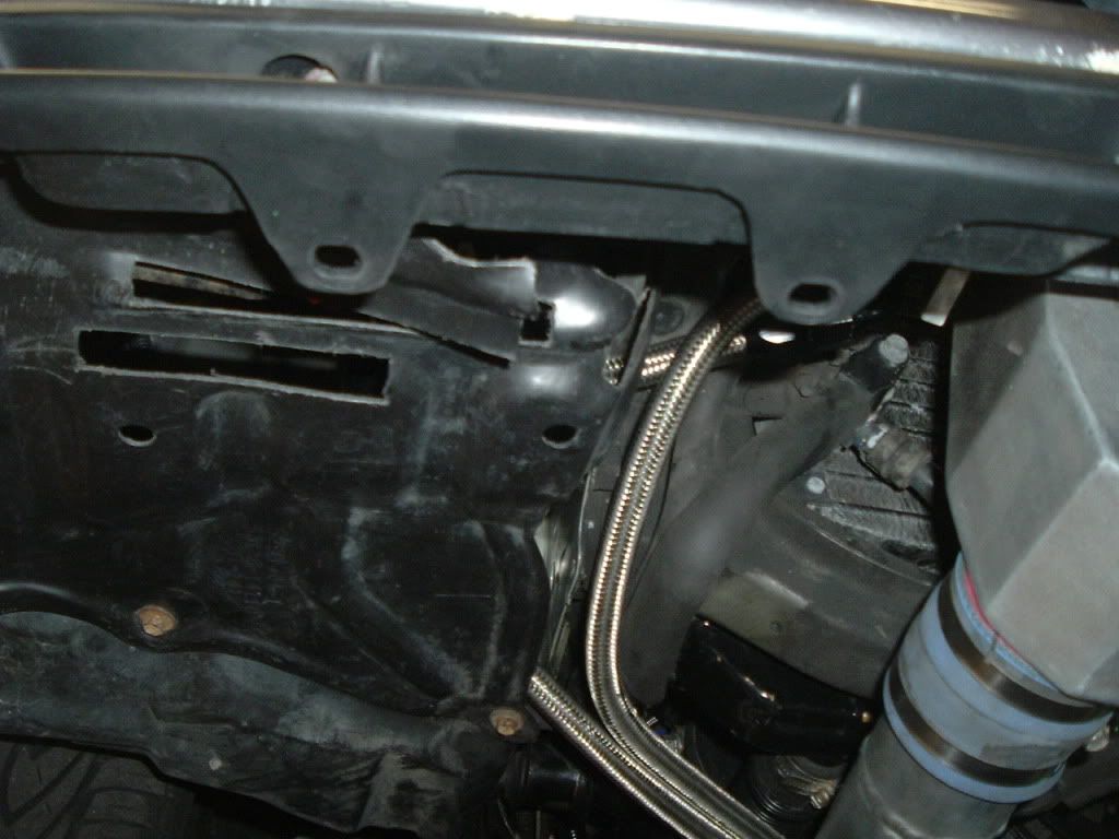

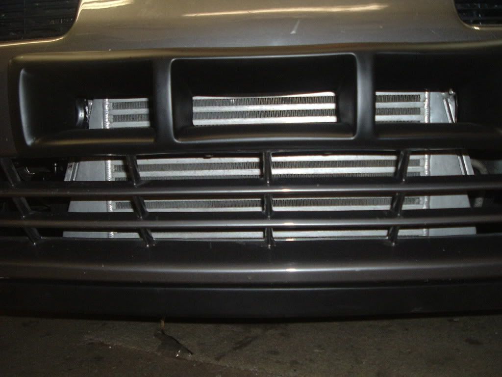

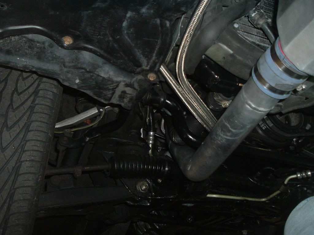

Here is some pics. IC piping from the turbo to the Intercooler all welded up. Im crossing my fingers I marked the pipes correct and still fits. Im hoping I can get out to the garage later today to get it installed, re-install the front bumper, and the splash shields. Then hopefully take the sup off jack stands once again.

Everything re-installed, started her up, warmed it up and went for a short 19 miles cruse tonight. Had to add another 1/2 qt of oil, (now up to the system holding a little over 8 qts.) but Huston we have a problem, I can only get 6 lbs of boost MAX( this is with the EBC turned all the way up). All of this and no fuel cut, so I dont think there is boost leak rather the EBS needs to get reprogrammed or the waste gate is stuck open. Feel free to share your ideas as for what the hell is going on there.

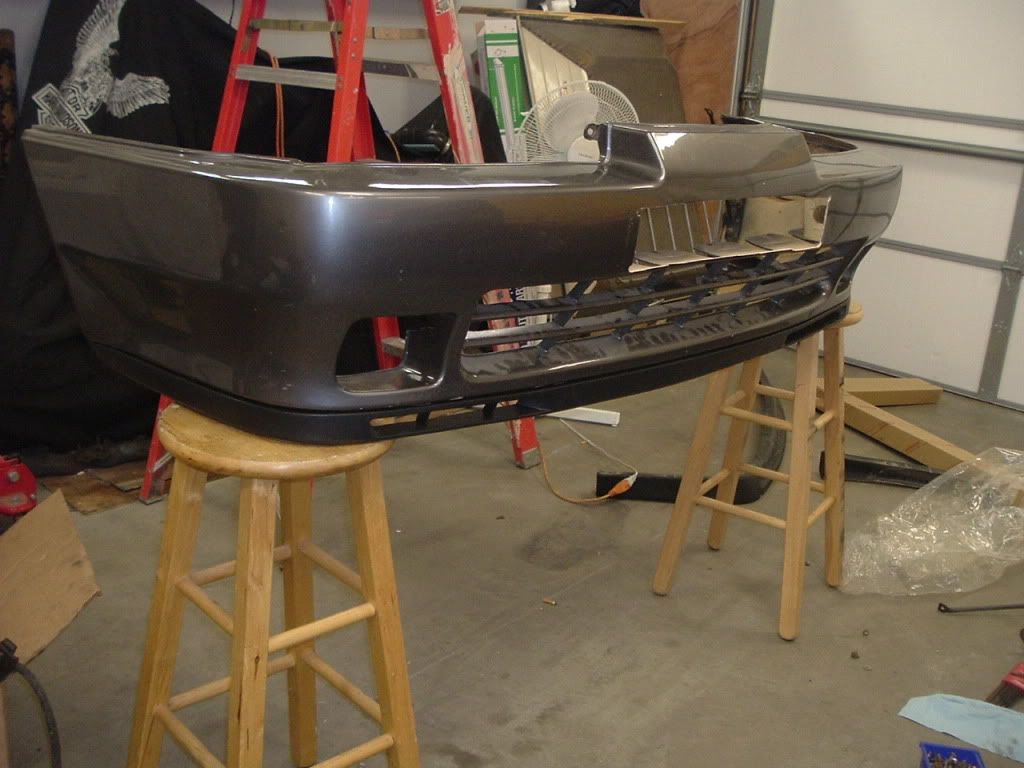

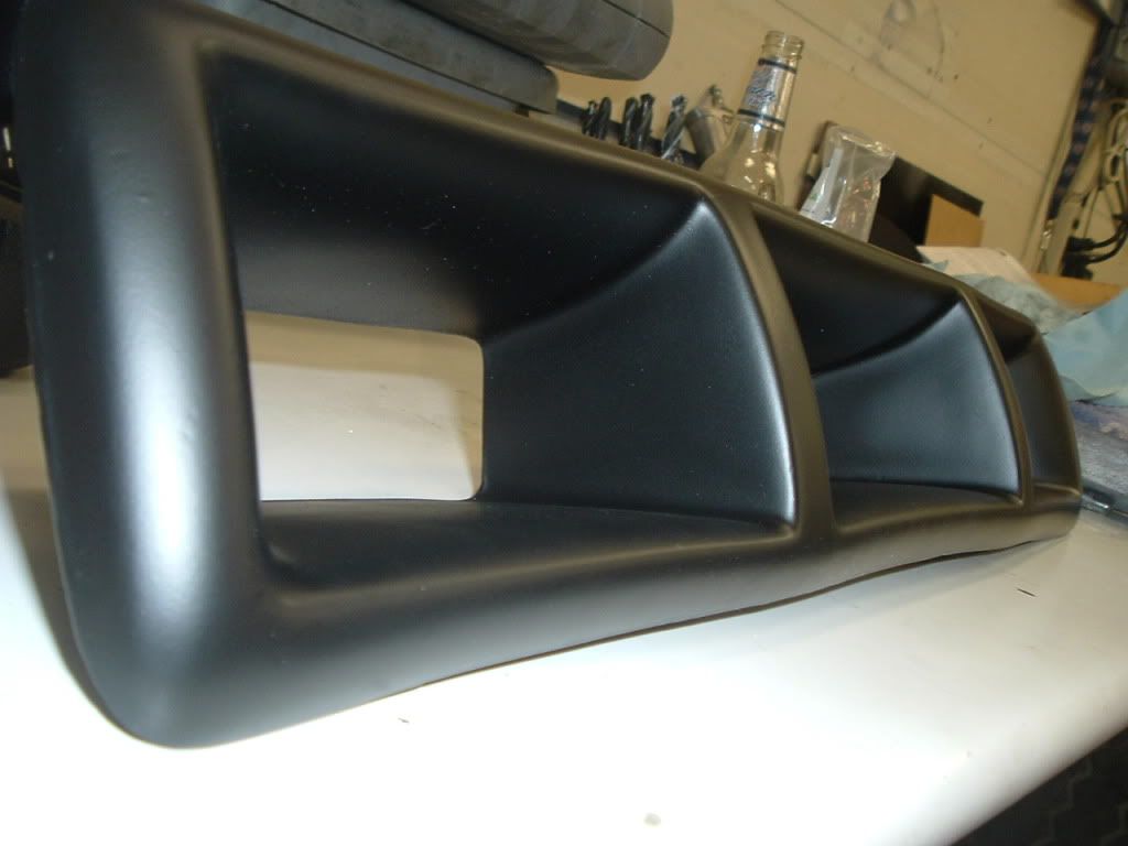

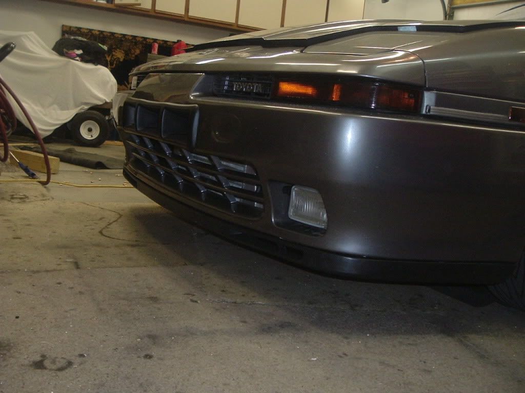

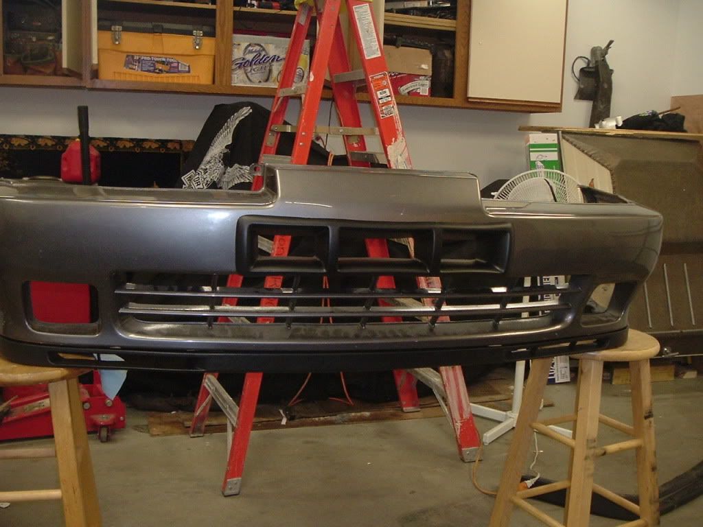

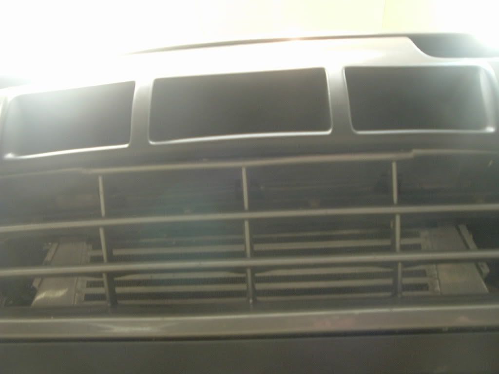

The jury is still out on the new front lip, not sure if I like it or not.. The oil temp held about 185, but it is cool out tonight so we will wait to pass good or bad till a warm day, More pic tomorrow, now time for some COLD BEER.

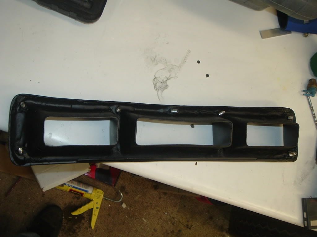

BTW you dont need washers on the carbon panel. When the hood is closed, the latch keeps the panel from going anywhere

Thank you!!! BTW the CF panel fits pretty good.
I figured it wouldn't but with the hood open it rattles, shakes, bounces around. I just wanted a more secure fit. I'm crossing my fingers that my head light motors don't go out on me. I wouldn't be able remove the the rubber caps any more with out removing the washers.

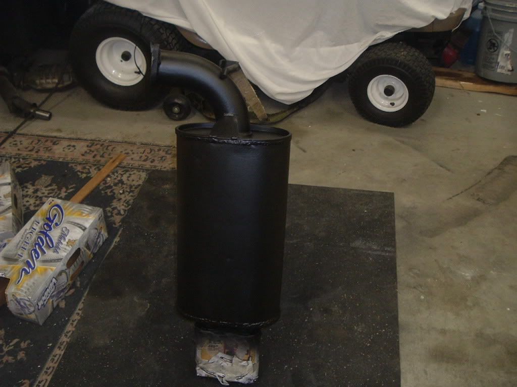

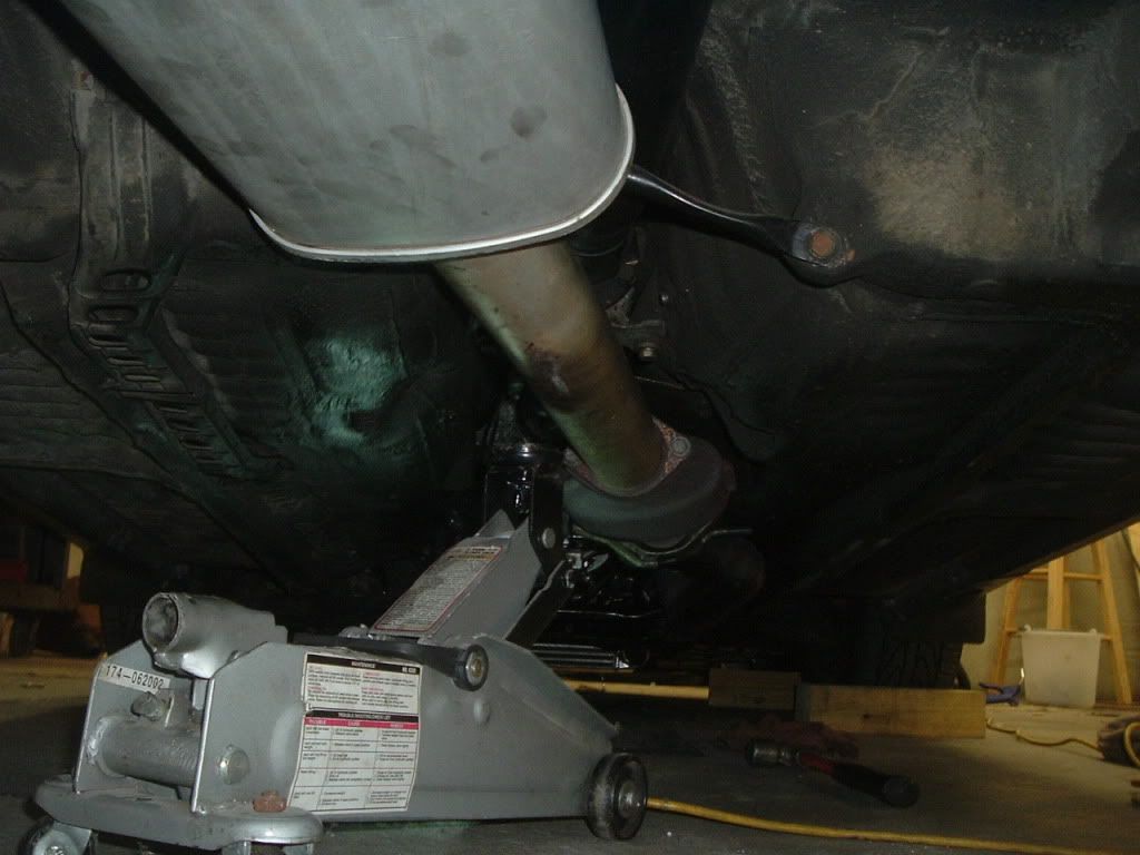

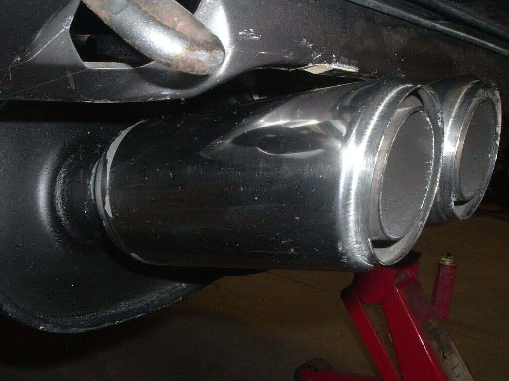

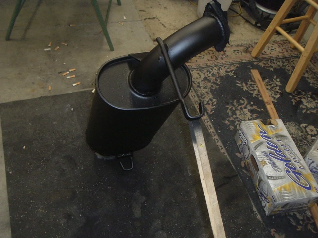

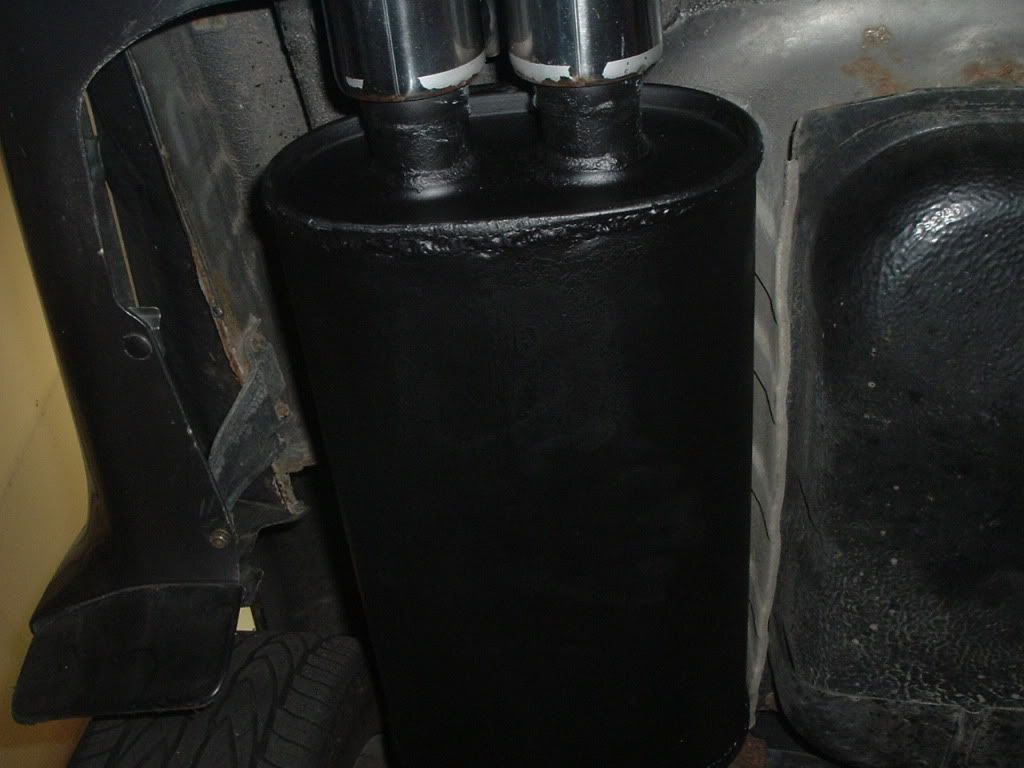

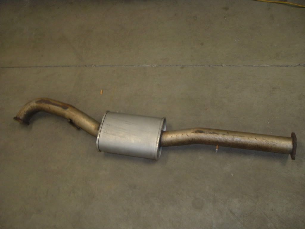

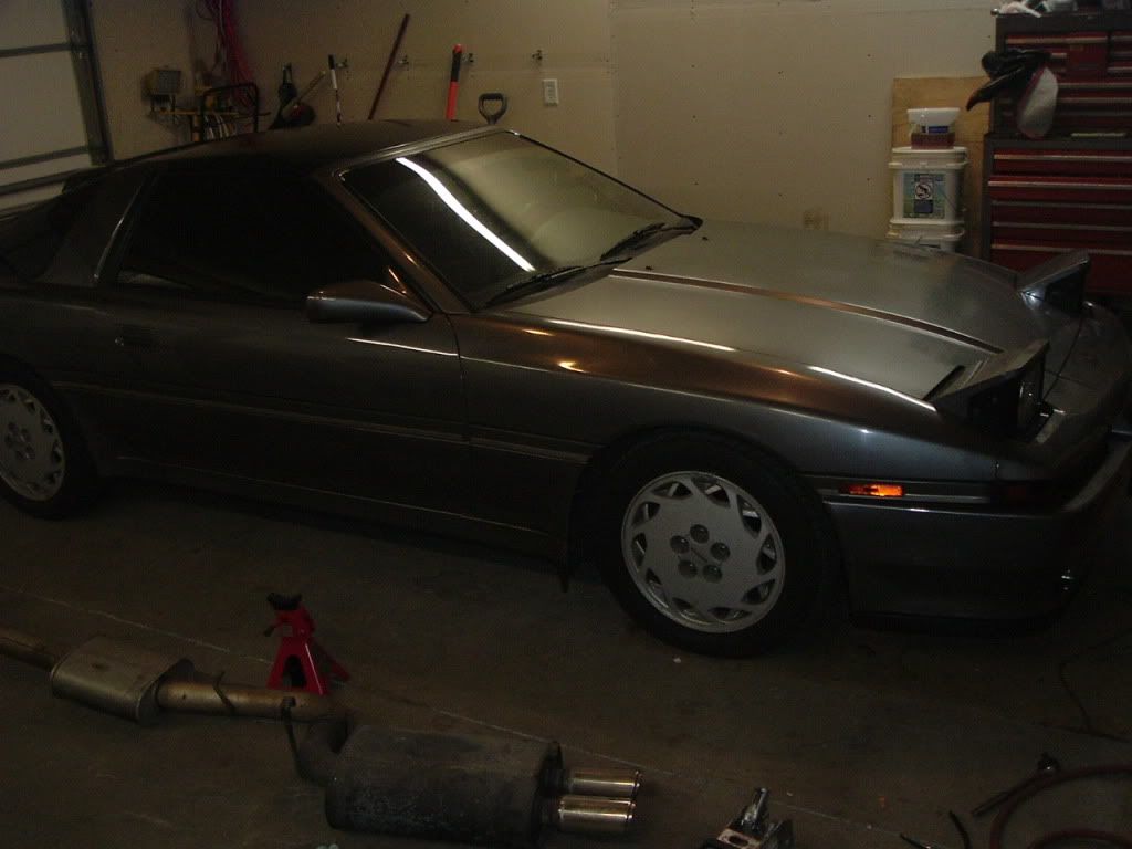

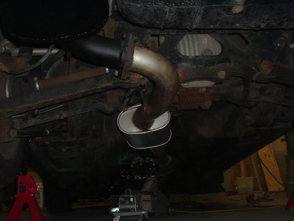

Well today after my interview I figured I would finish installing the HK$ exhaust and polish up the tips. A couple days ago (in preparation) I re-primed then re painted the rear muffler. The original paint was chipped up, and look like poo. Also before I installed it I weighted it because this mo fo is HEAVY! The mid section came in at 21 lbs, and the rear muffler came in at a whopping 25 lbs. One really nice thing about it it looks OEM, and is nice and super quiet.

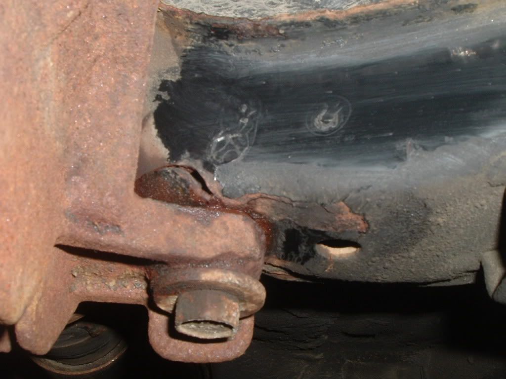

One bad thing I did find wile under the supra, a crack in the rear sub frame. On the right side where the rear end bolts up, pic below.

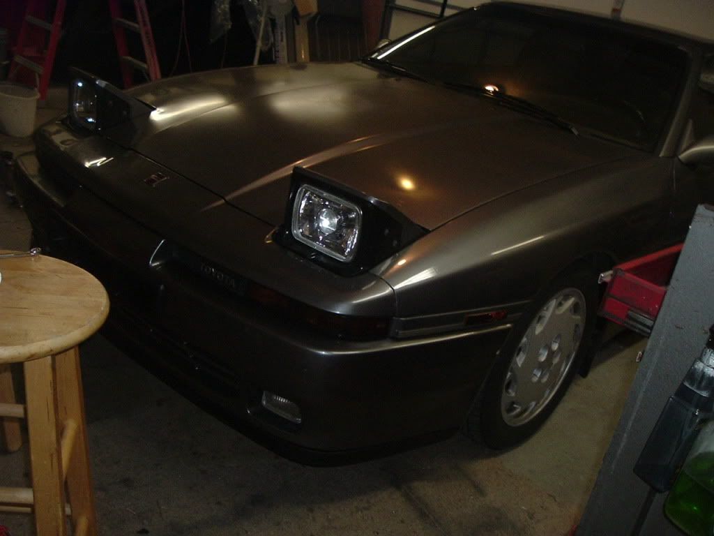

And since I was in the picture taking mood I snapped a few wile in the garage of the new stuff. (I couldn't get any decent one of the turbo :cry: ) Well enough reading on to the pics. More to come once I bring her out side again. The wall is in the way for a good pic of the muffler / tips.

What's the plan for the subframe then? I got under my car this winter and my diff bolts were finger loose, I didn't check for cracks, but I'm worried.

Im leaving it for now, driving season is among us. Maybe some day (next winter) drop it , reinforce it, then weld it all up. But not really sure yet.
