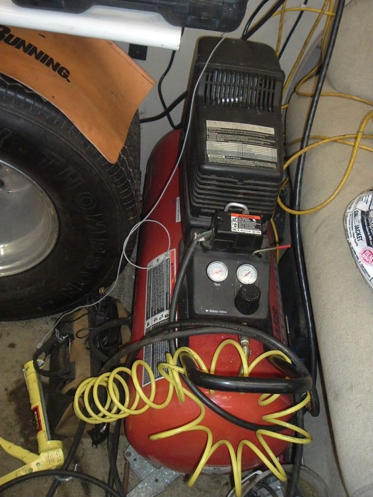

EDIT: forgot to post a pic of the compressor, 4 HP, 25 gal. whoo air tools when I want to use them now.

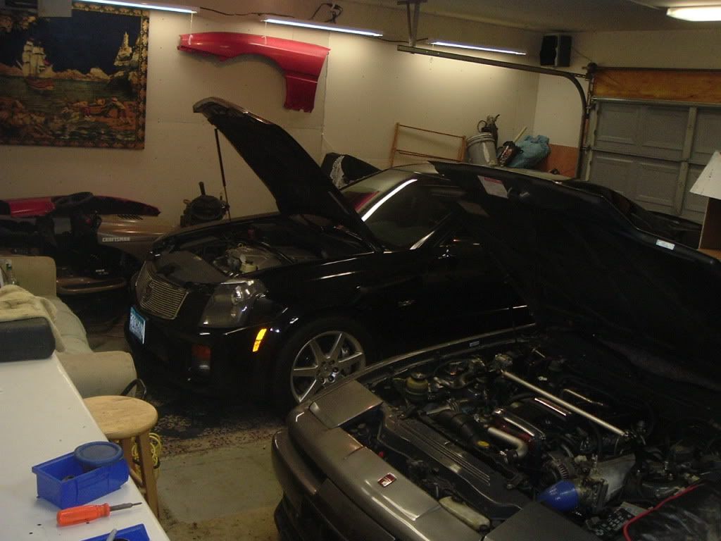

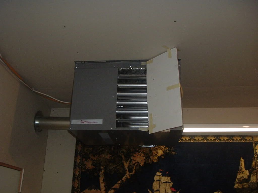

Yesterday I finally installed the heater and the rest of the lights in the garage. It heats the garage up to 70 degrees in about 7 min!! (starting temp of 40 ish) WHOO!!! nice and warm just in time for the winter.
I also added a piece of cardboard to direct some of the heat towards the back of the garage. (if you are wondering why there is a piece of card board in front of it.)

Maybe but it works until I can bend one out of tin.

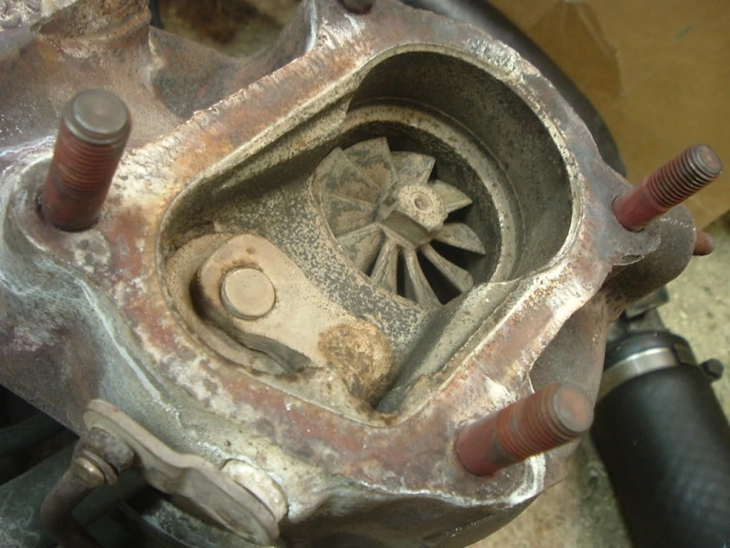

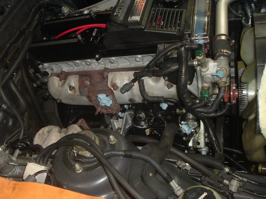

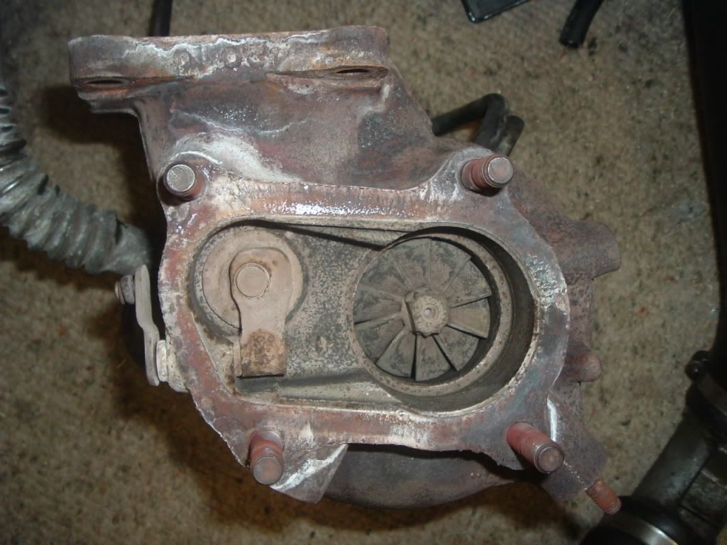

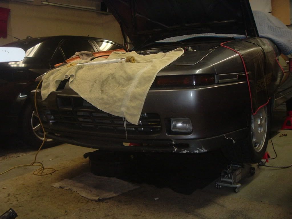

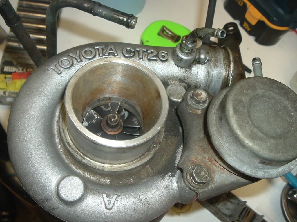

Well this morning I was feeling ambitious and decided to put the sup up in the air, and start removing the turbo, and what not. Well I will let the pics to the taking, :)
Poof turbo, is gone
This will be the last day this sup & 7m will see one of these

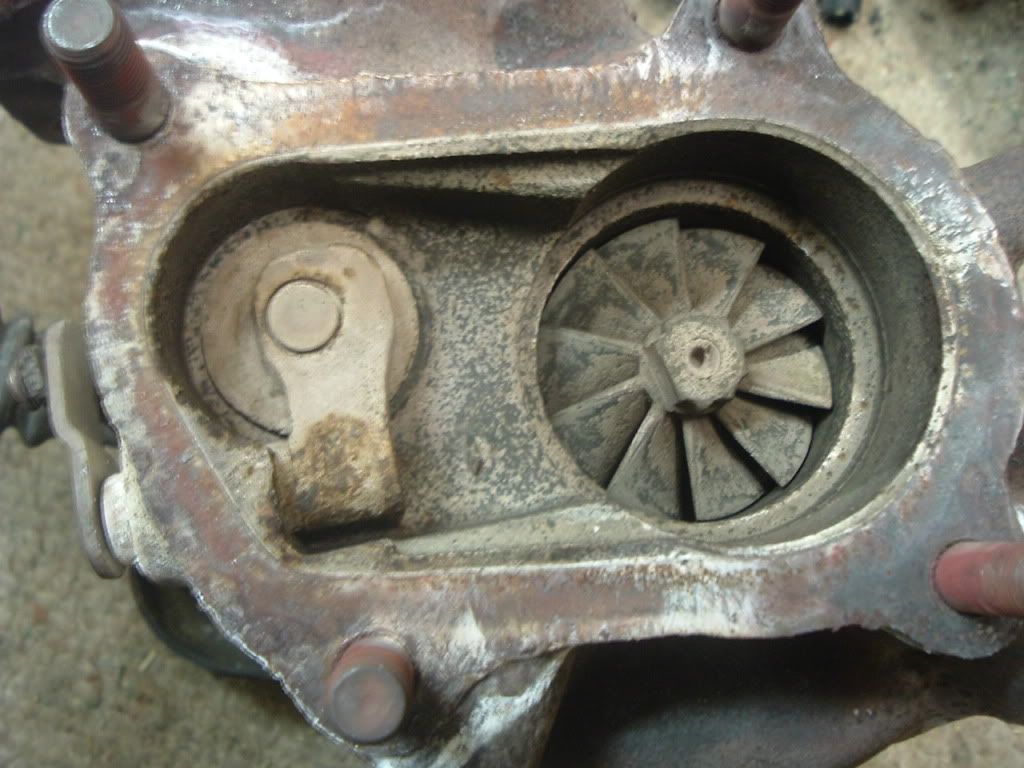

This is what the exhaust side looks like. Seems like lean, but on the dyno the car was pig rich.
What do you think?
Never the less still very min. shaft play. It will be in the F/S section soon.
You can also see where the turbo to downpipe gasket was leaking :(. Time for new exhaust side gaskets also.

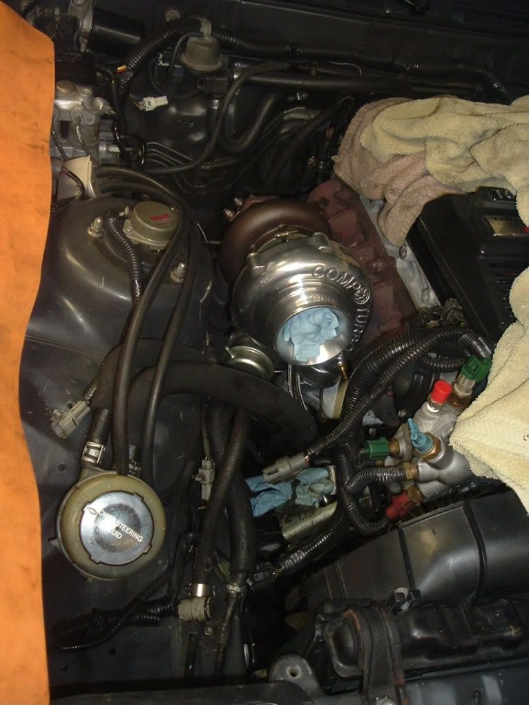

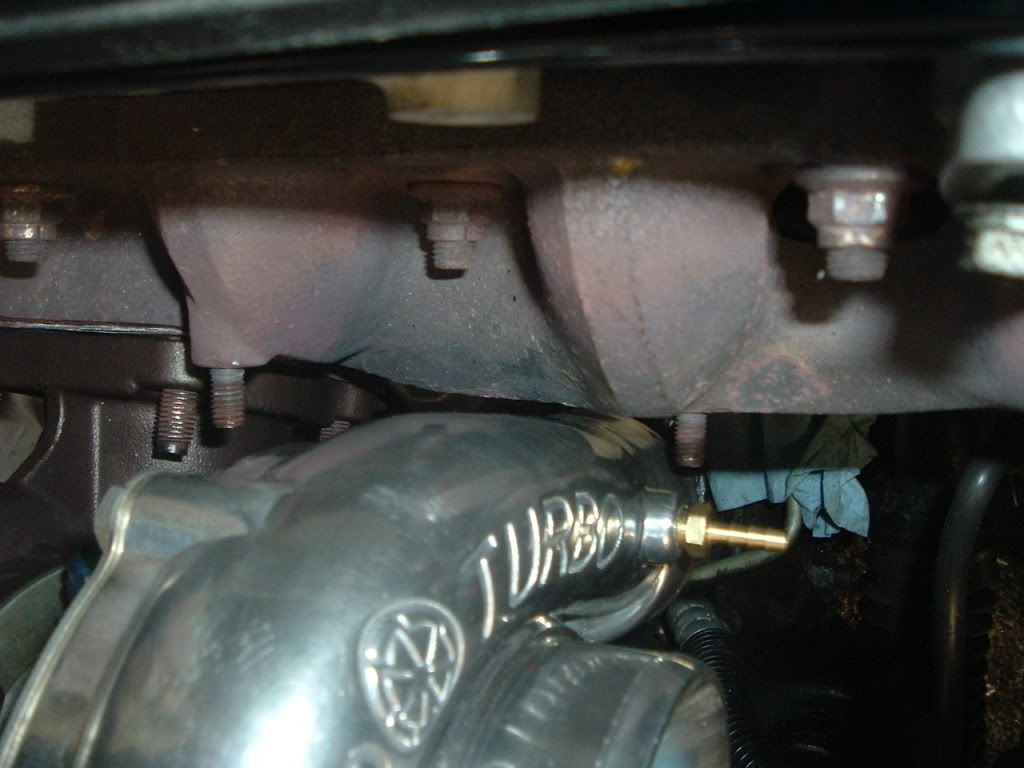

Well the past week I have been putzing around with the sup. I got all the oil and coolant fittings installed. And yes the CORRECT fitting for the top of the coolant neck (bst to 6an), not any of this "make a NPT fitting work". Just spend the $10 and get the correct one!!!!!

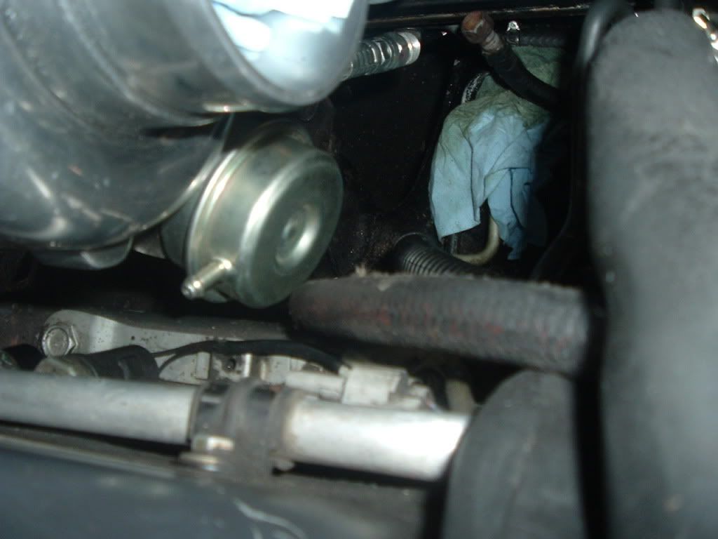

Well today I figured I would put the Boss Sr. in, quick since Im waiting on more fittings, to check the fit. Well it fits, but I need to change the power steering line from the cooler. Its a little tight, hitting the waste gate actuator. Also the Boss Sr. to the manifold flange is a little off/tight. I had to give it a couple good shoves to get it around the studs on the manifold :cry: I really would like the bolt pattern to be a little larger on the turbo, but it fit.
