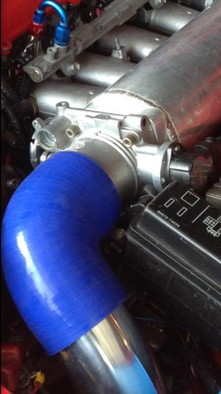

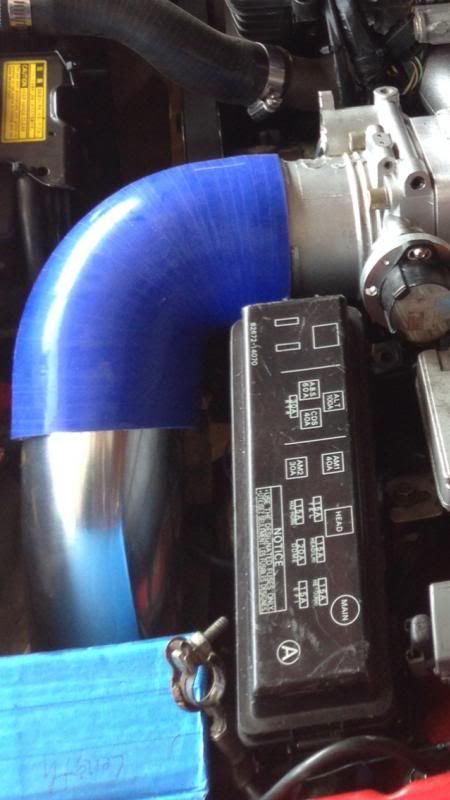

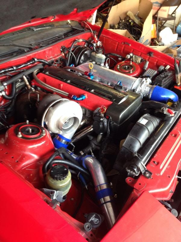

Heres how im gonna route the intercooler pipe to the q45 tb. I cut a hole where the battery was at for the 3.5 inch intercooler pipe. I then use a reducer couplier 3.5 inch to 2.5 inch where u wont see after the cut hole. I personally dont like a reducer couplier 3.5 to 2.5 right at the throttle body. I just dont like that look. Fuel rail, injectors, earls fittings and ss braided fuel lines are installed as well.

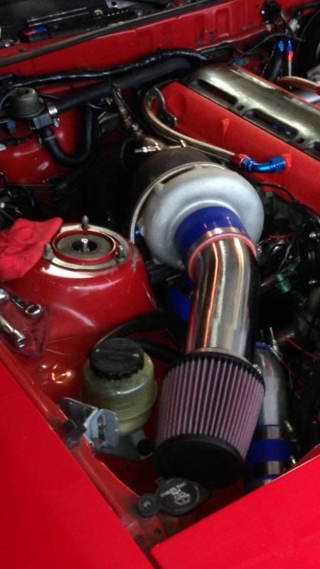

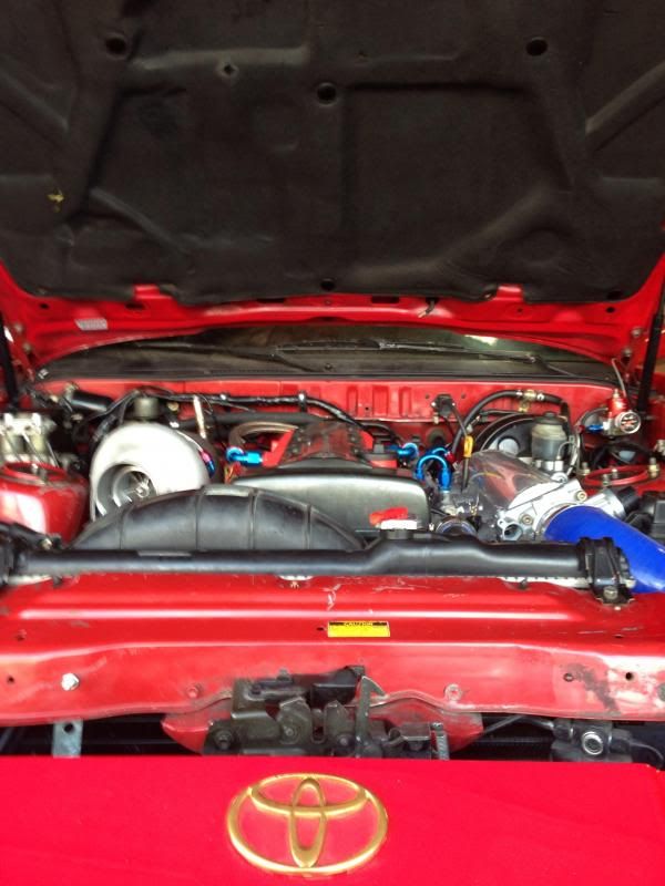

Installing the intake pipe and short k&n filter. I did the rest of the intercooler pipes from tb to fmic and turbo to fmic. Hks ss bov is install between tb and intercooler, didnt take a picture of that.

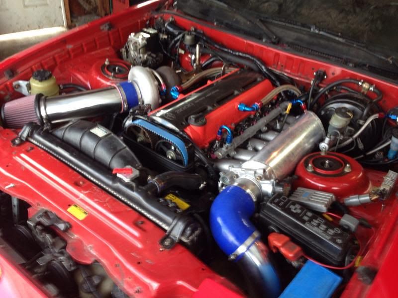

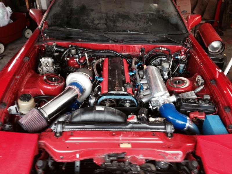

Pretty much almost done. Cleaned up the engine bay a bit. Im pretty happy with the results of the outcome how the engine bay looks. I cant wait to drive my supra, its been a long time sinced the last time i drove her. Im glad everything is coming together well. Theres still a couple more things i need to do to the supra before i can start it.

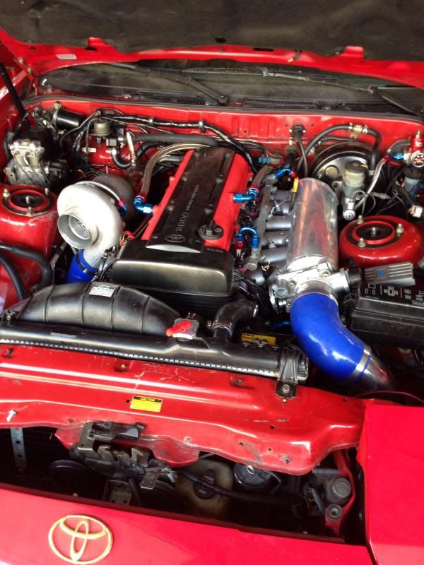

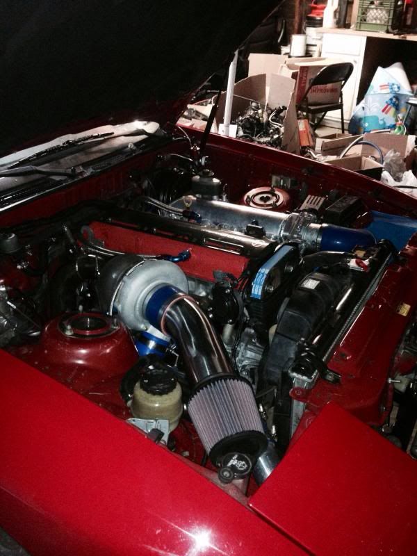

Heres a little update on the supra, i got another spark plug cover without the cut out cams. Here some pictures of the intake off. Everything is finished on the motor, just need to put oil, coolant, power steering fluid, clutch fluid, bleed the clutch and fire it up.

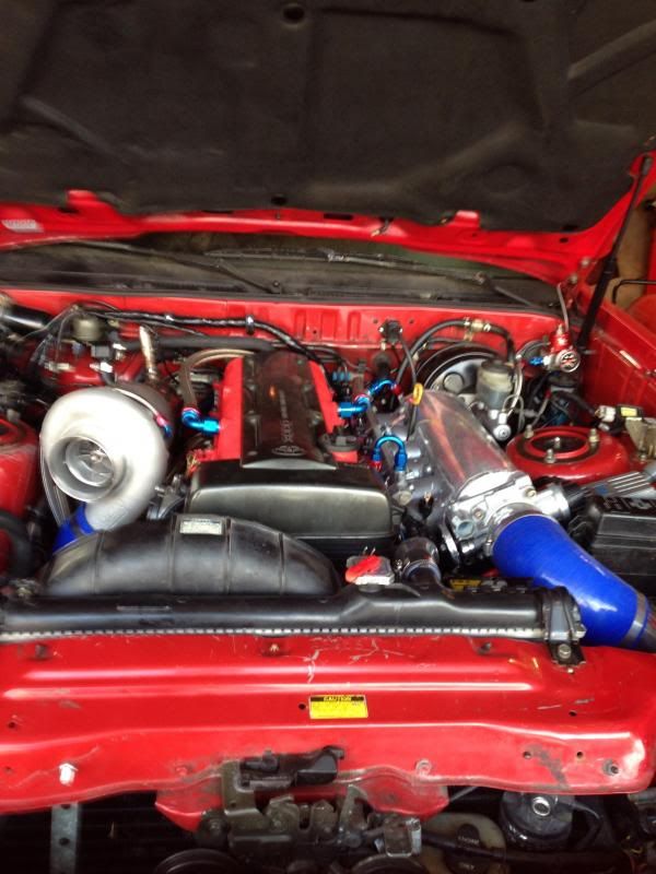

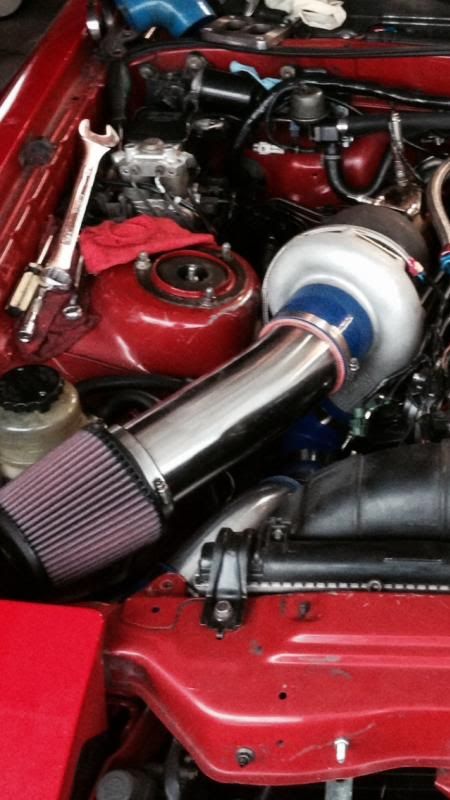

Its alive!!!! The supra started. It starts and rev to 5,000rpm fine, just a little rough idle when its cold, once its idles for about a minute or 2, it idles smooth. This is from not having the cold start in with the ffim and vpc temp sensor cold start up. But i am throwing two codes. Code 22 and code 51. 22 is coolant temp sensor signal and 51 is switch condition signal. My coolant temperature gauge is not working. Its either the temp sensor is bad or short somewhere. Gonna look into those codes.
