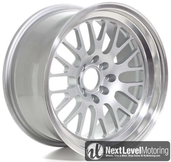

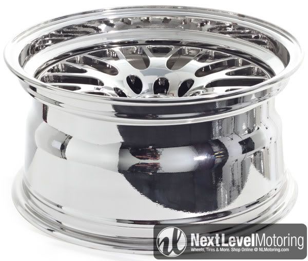

Joe__G
Dec 6, 2013
69
MS
CCW's aren't in the budget right now. I've already spent more than I expected on random hardware, hoses, gaskets and stuff...
Ended up ordering these:
They were pretty cheap CCW replicas. I'll see how they work out. If I'm not happy with the quality I'll end up getting something else later.
How much did the run you? Details on them?
