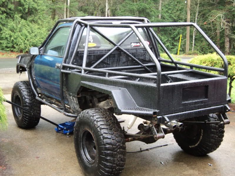

well i have mroe then one project

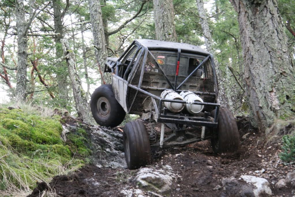

this is my other one i just about finished and the cage work but there still more to do lots more
lower my fuel cell down
re do my shock montes since i just swaped in new rear axle and spring perches
i plan to make anty wrap bar but not tell i take it out for it's frist test run
for the front stuff that i have to do is relocate my steering box and change up the front caster to make turning easier when i locked int he front end
and fi i find time i am going to be ditching the 22re for a ka24defor s13 wheil still useing the w56 trans
well here are so pic's
new 4 runner seats
new rear 4 runner rear axle whit cable based ebrake
axle parts
new trans tunnle for dual t cases had to be made since this is 2 wheel drive truck at one time

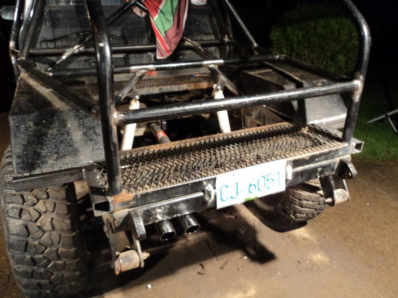

will be covered in stainless

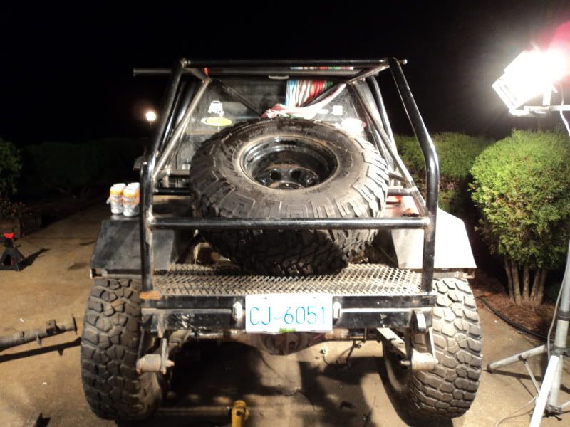

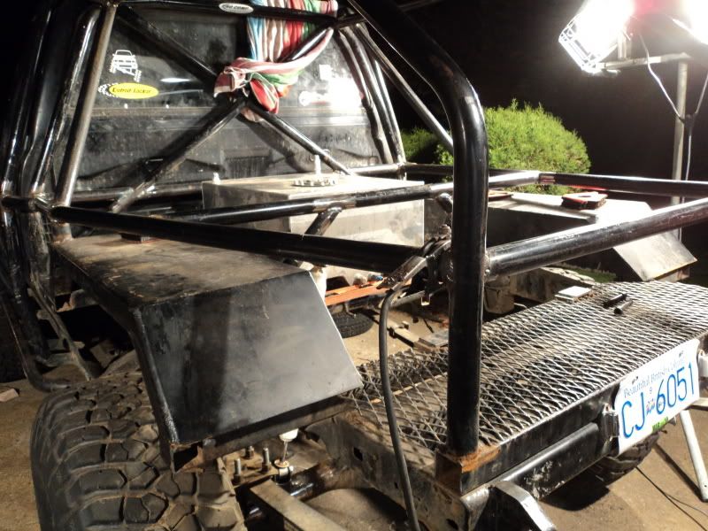

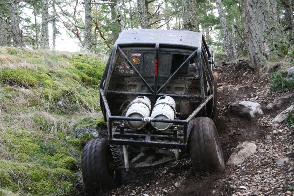

cutting the back shit off sick of hitting trees with teh rear end going kinda for the the dove look but still have tire coverage
more cage work

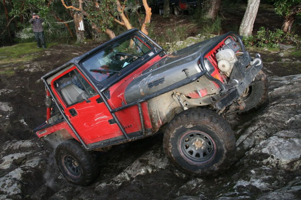

well this is my truck :evil2:

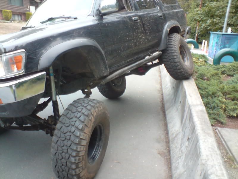

but thsi is what my truck looks like right now not fully done or the latest pic's
had to add in some bling

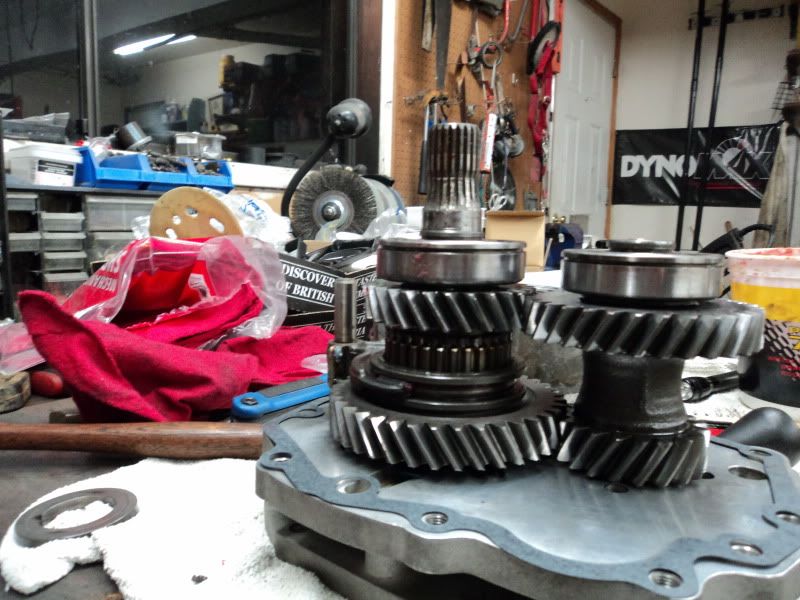

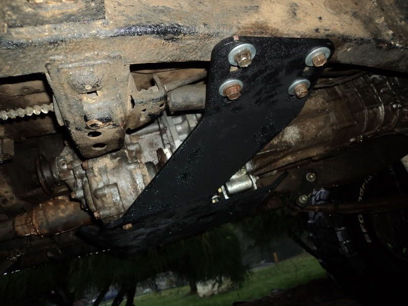

been a wail for an up date but this what has been done

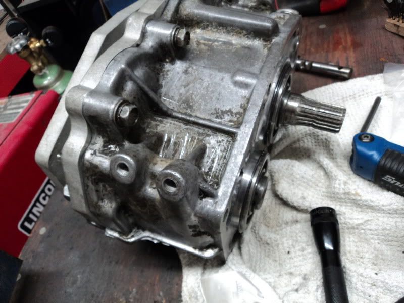

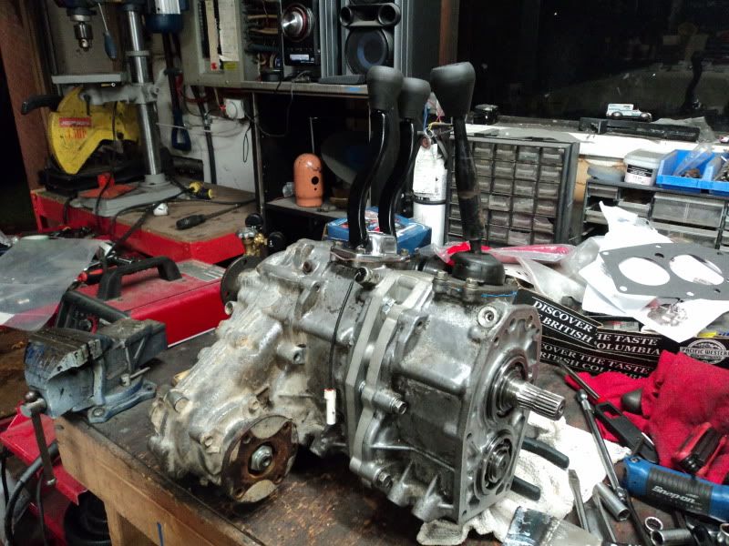

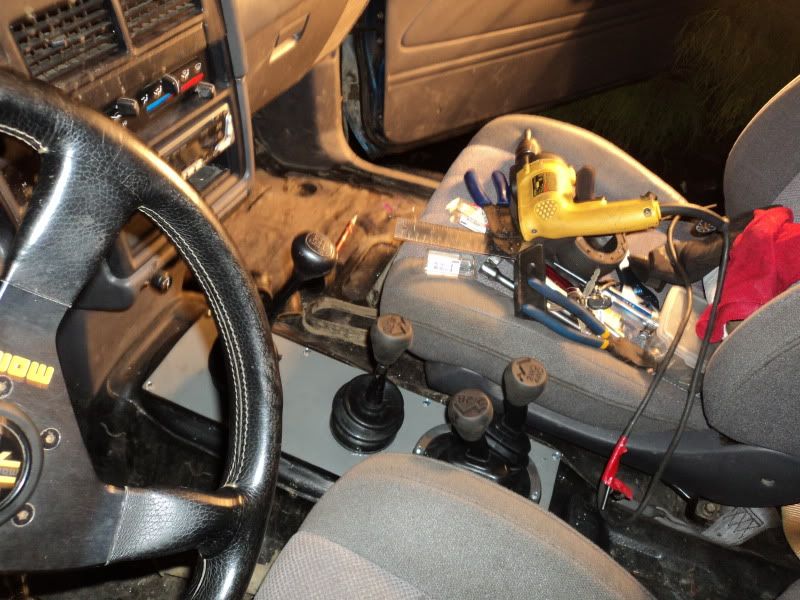

t cases done (say no to ramming and hello to crawl)
ps that stuiped lock out pin for the tiwn sticks, who the hell has magnetic punch that long ? I was going to go buy one but fuck it BFH time
so i used my brass hammer and pounded the other side of the cases tell it shook loose and fell out
WIN

Obviously w/ the 22re you've got a gear driven transfer case, what gears and adapter did you use? Marlin? Trail Gear? And what ratio did you end up with? The 4.7's, or dual 2.28's?

i use trail gear manily, marlin stuff is good and all but there stuff over priced and the same as tg (both have there ups and down)
as for gearing i useing dual 2.28 for around here that is nice gear setup to have since wheel speed means alot out here
plus i have 5.29's in my diffs

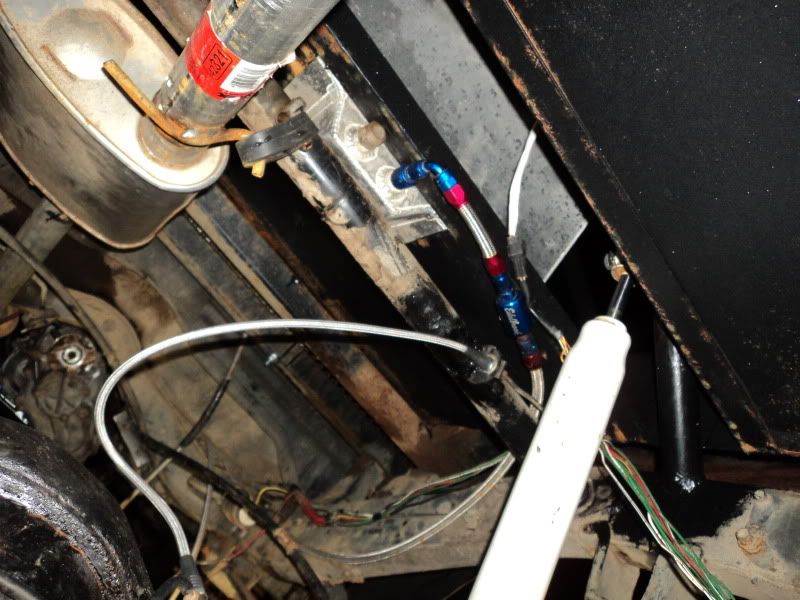

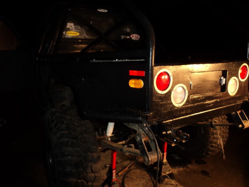

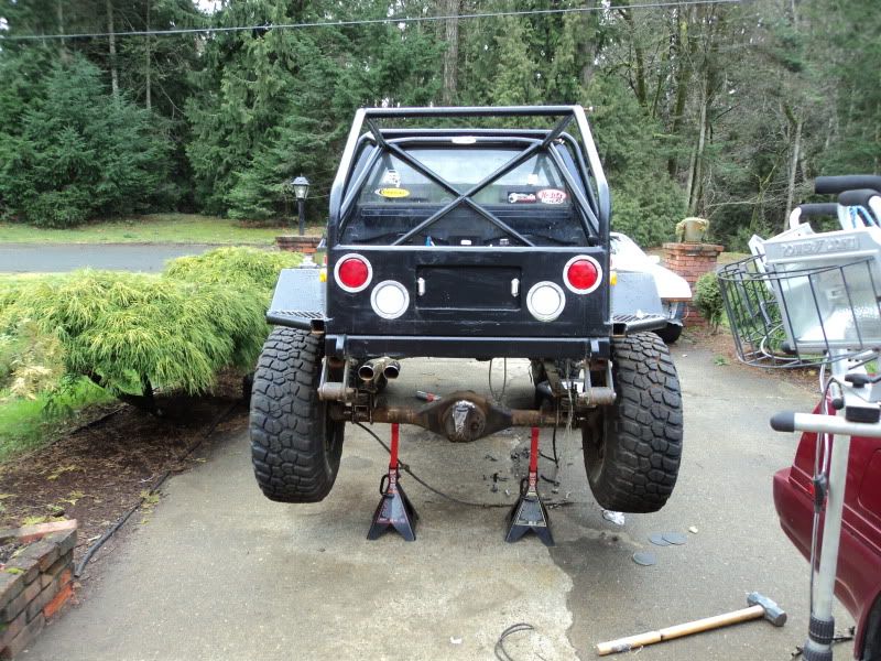

got some stuff done
monted brakes line's
added diff armor

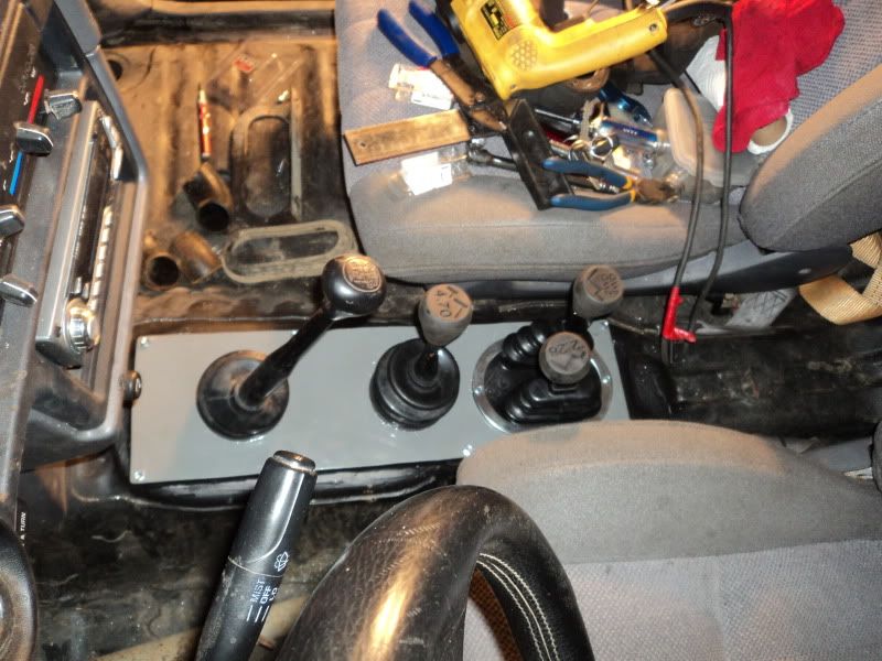

shifter plate thing use cv axle boots as shitfter bag nice and cheep and easy

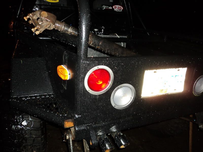

and installed my light's

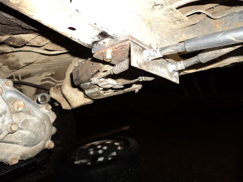

made my 4runner e brake cables worth witht eh truck e brake system
very much diffetn but i made them work wiht some cuttign weldding and all that junk
next is to make stinger and finshed wireig my truck lights and make drive shafts

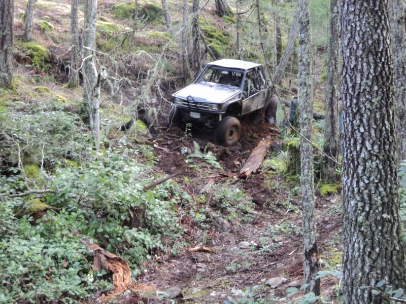

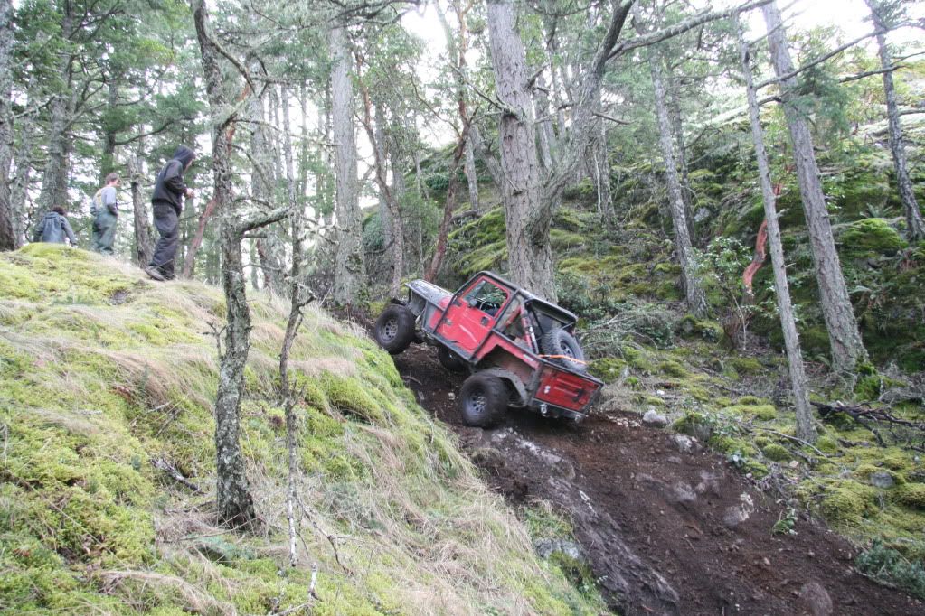

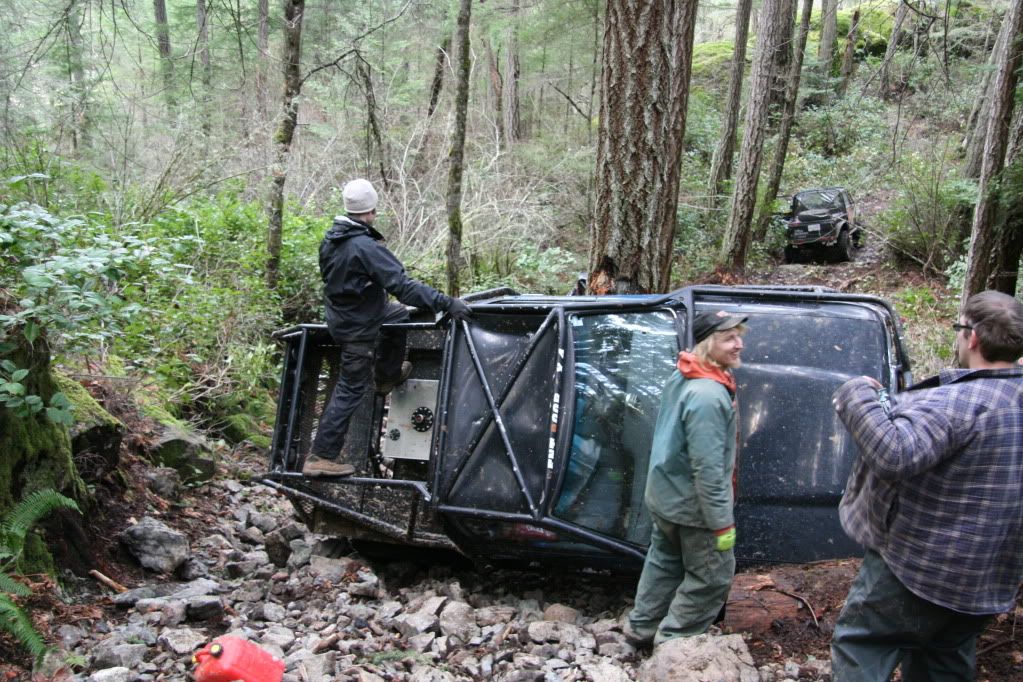

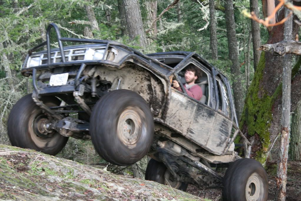

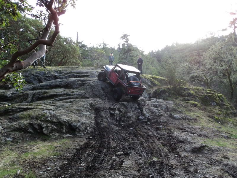

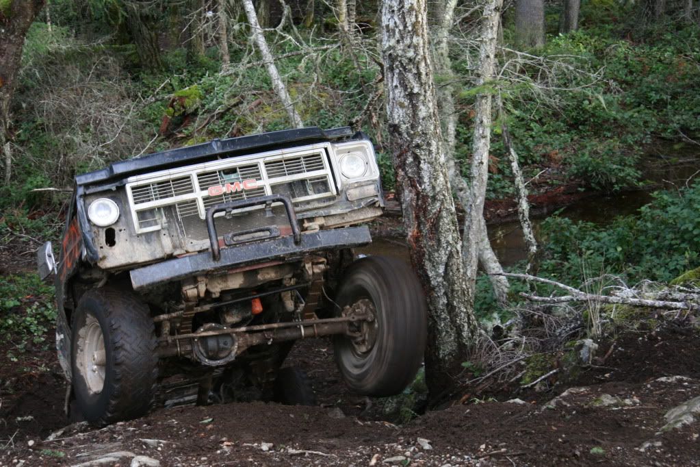

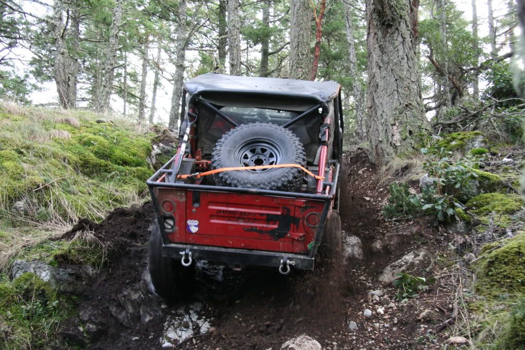

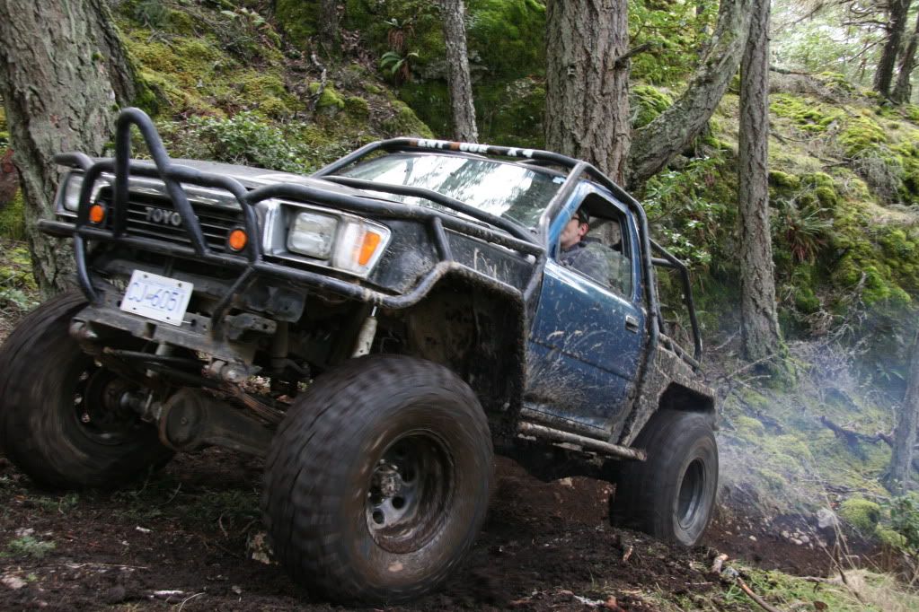

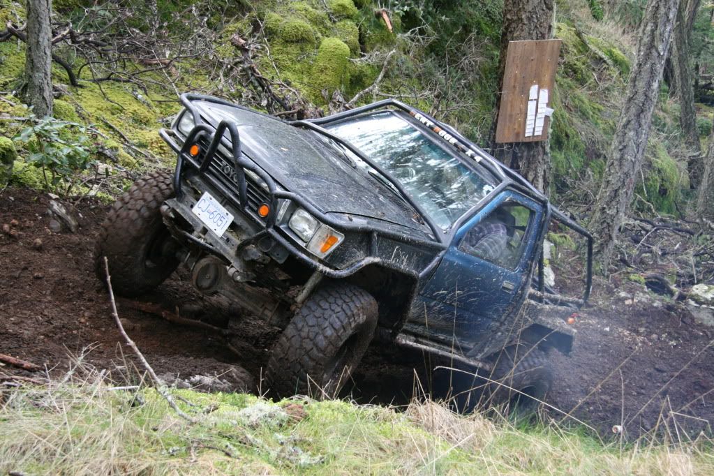

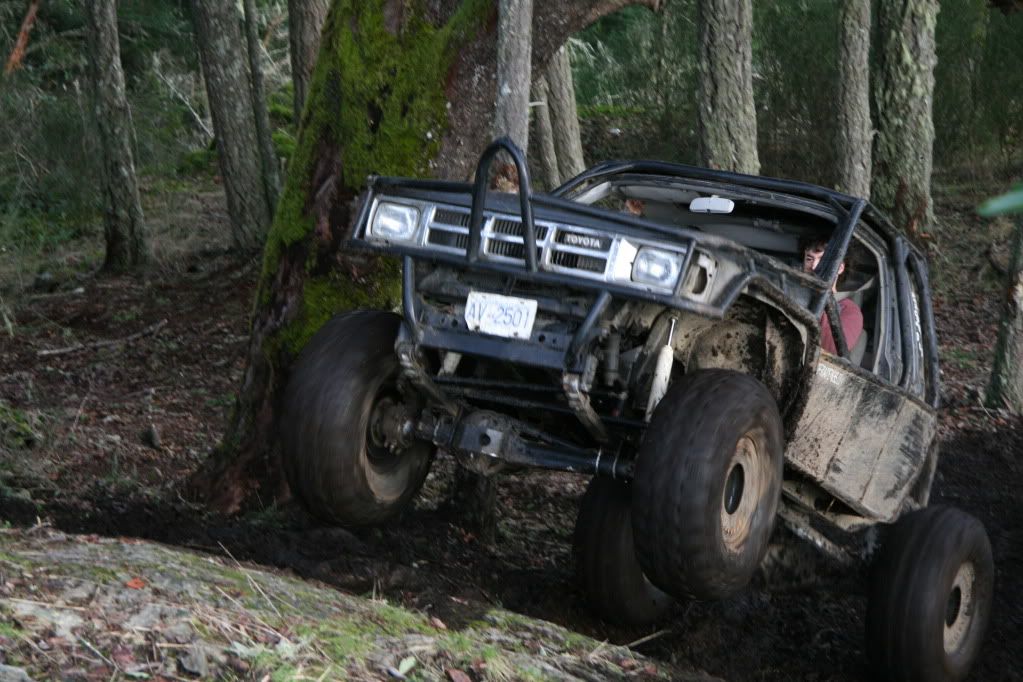

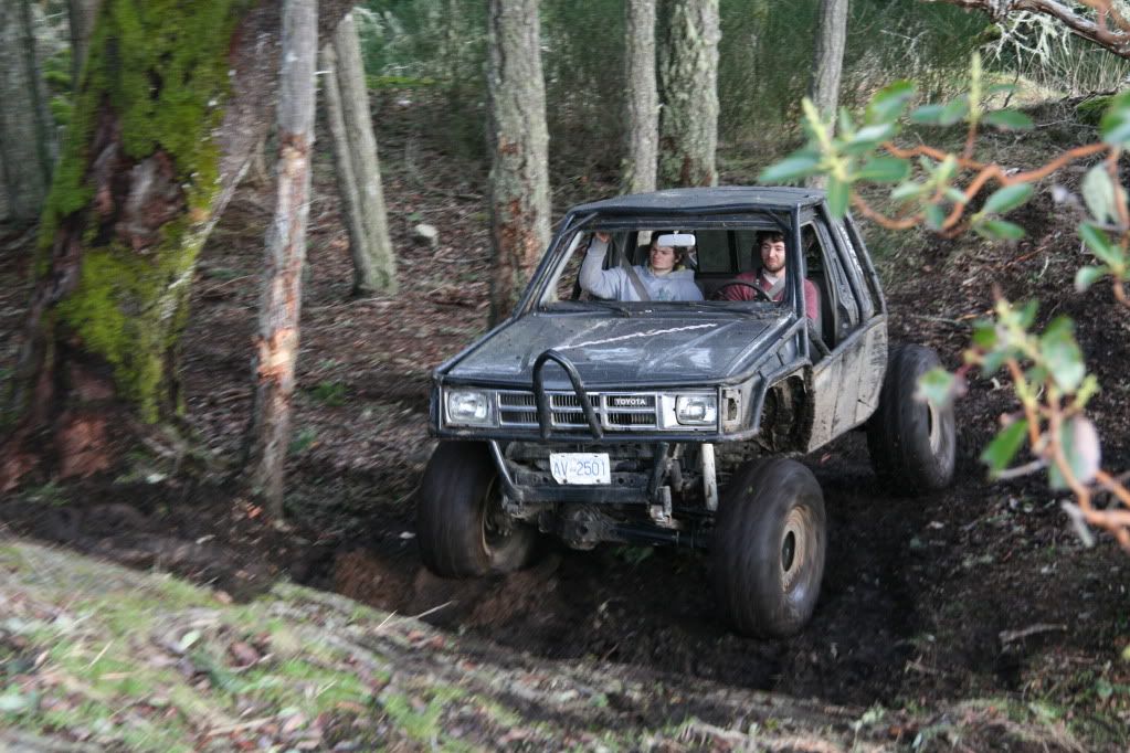

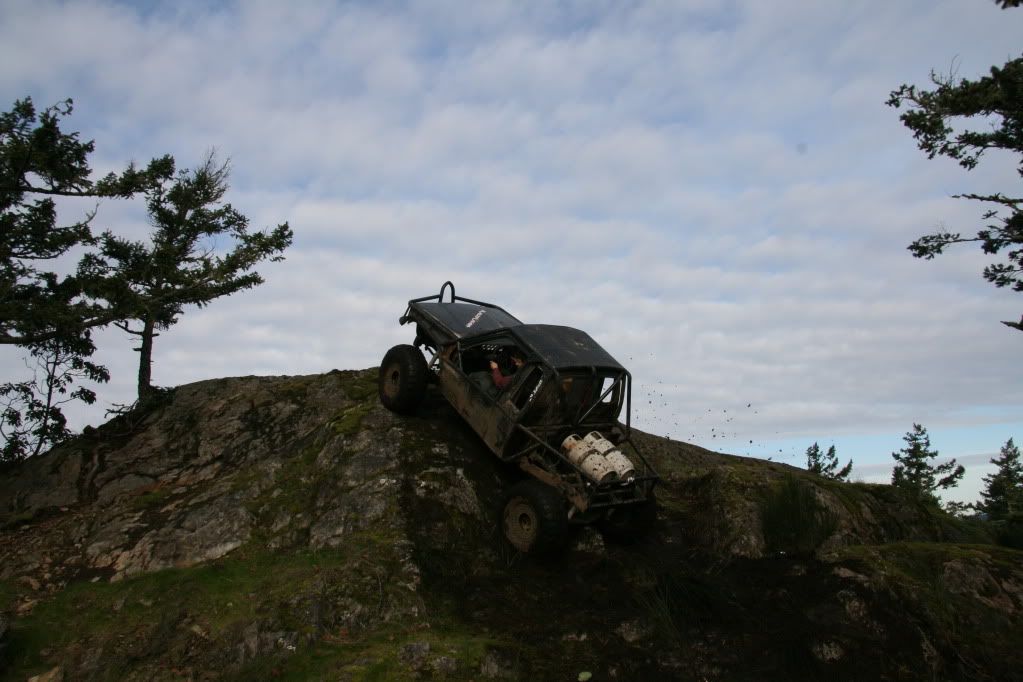

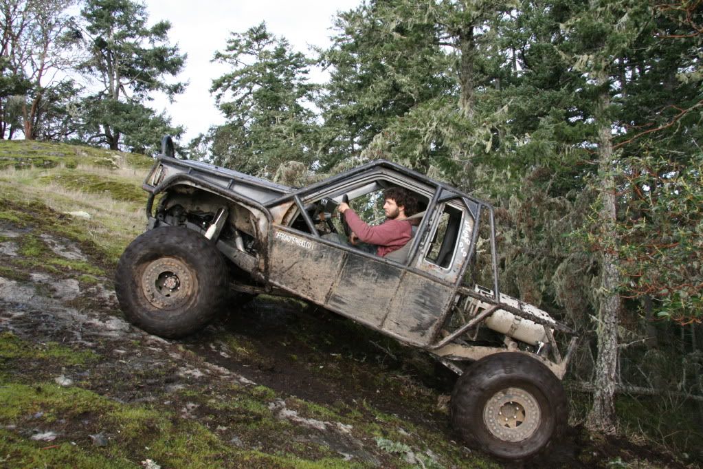

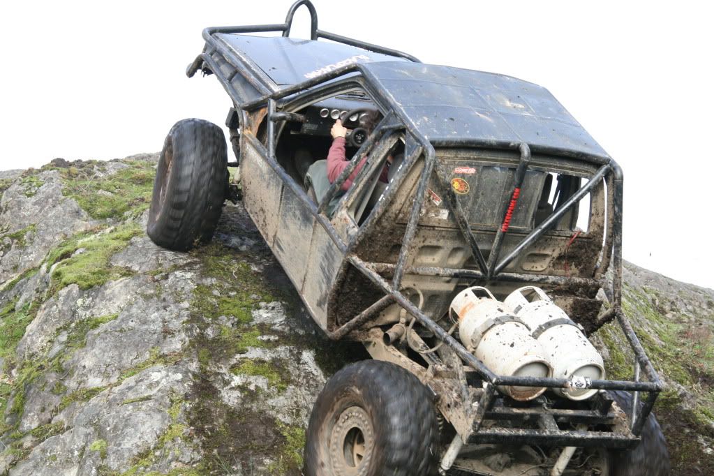

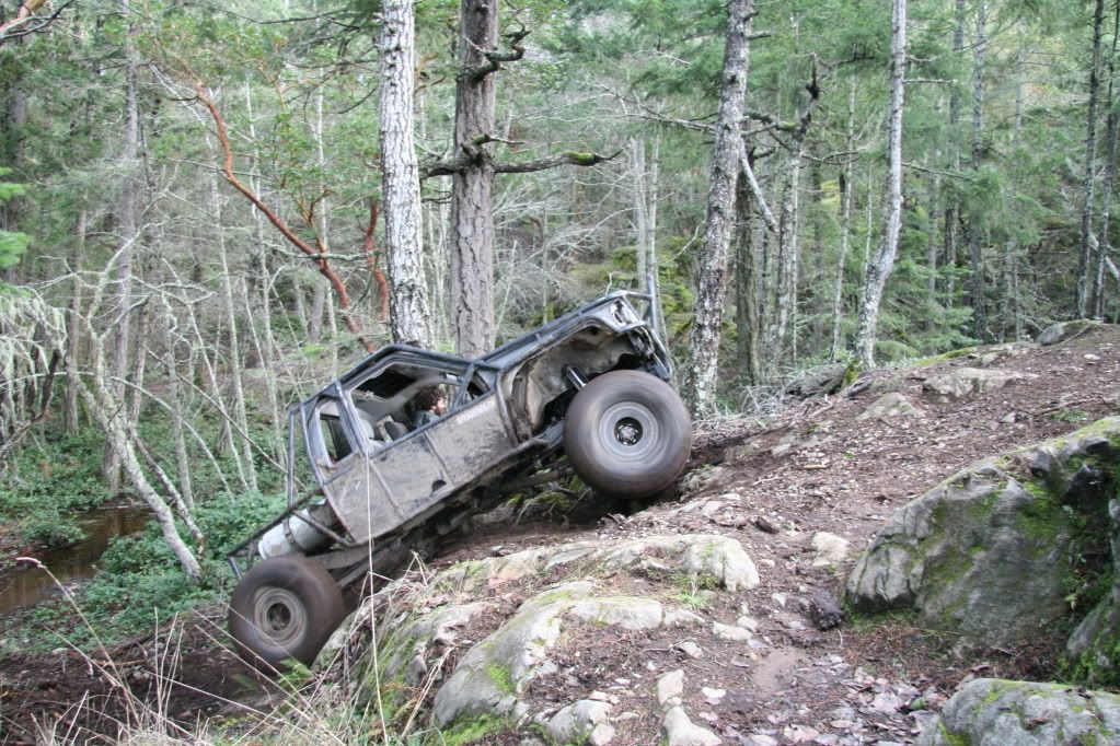

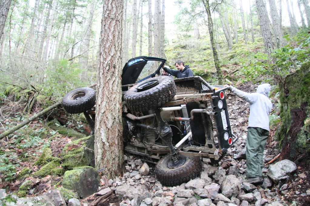

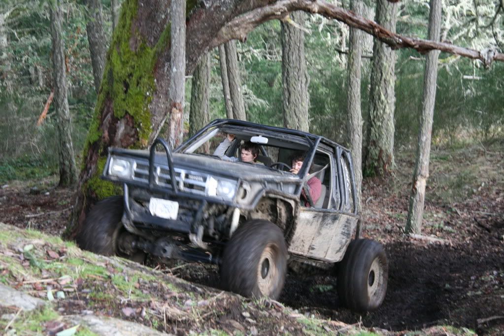

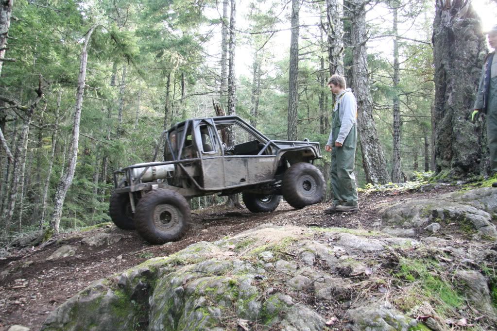

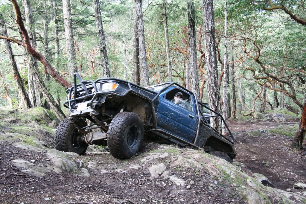

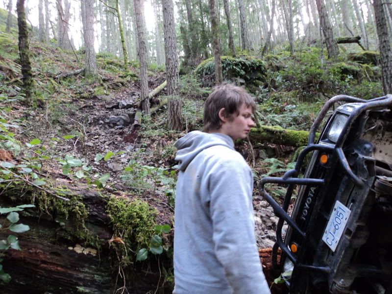

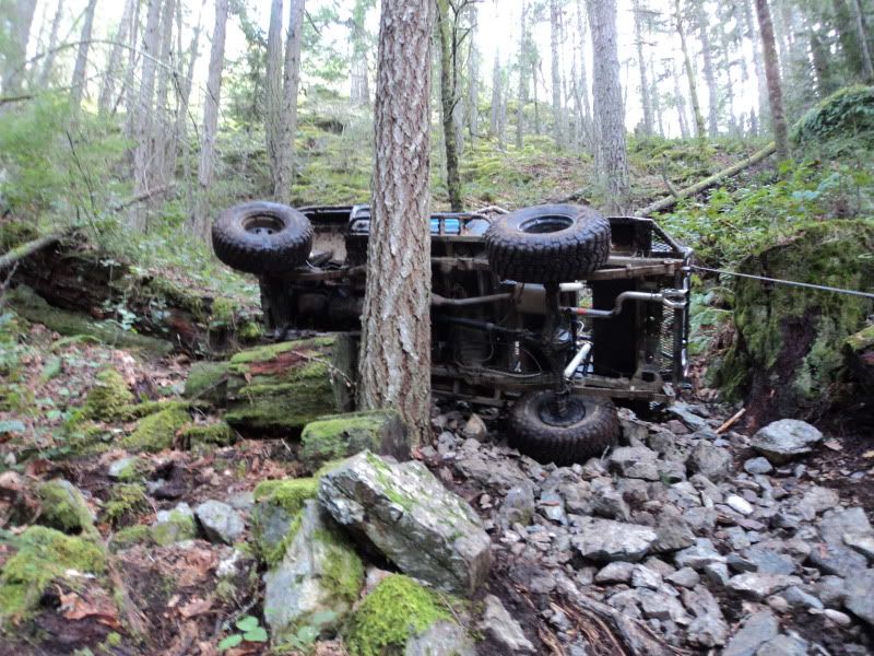

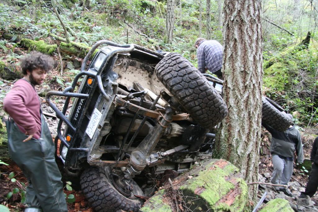

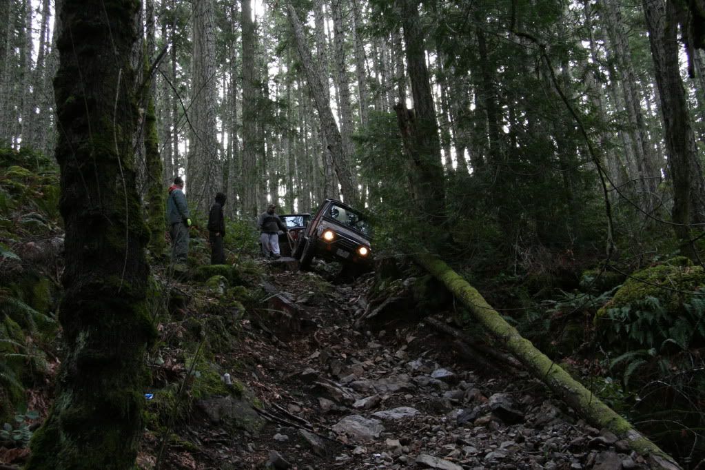

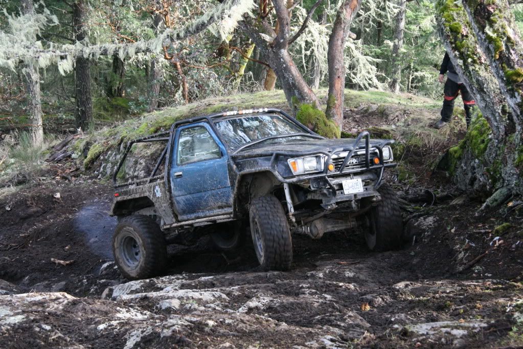

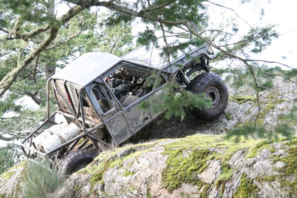

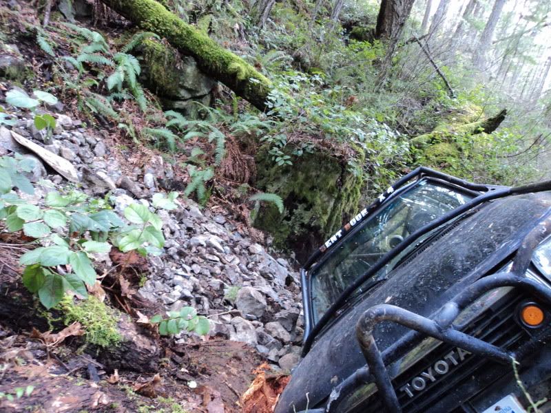

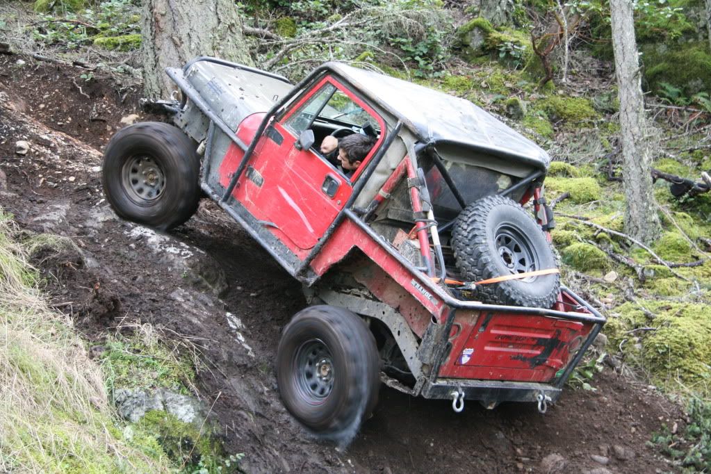

well truck is on the road not fully done but on the road
took it out and broke it too hahhaha and tested out my cage as well
2 end over enders and 2 barrle rolls tell a tree stopped me
damge big hole in my roof were rock ppunched though and bent rim and snapped a set of chevy 63's in half all 3 leasf
i guess a 200 foot high hand stand might do that and wrape then in to death

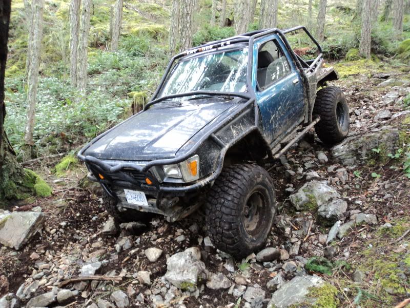

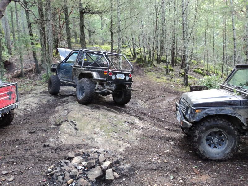

damn you werent playing bout rollin into a tree. thats crazy, it a good thing you had that cage there. the trucks lookin good. i see a friend of your is running a propaing setup, nice.
and those trails your guys are smashing on are very nice as well. canada looks fresh.

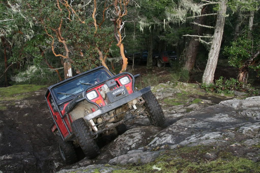

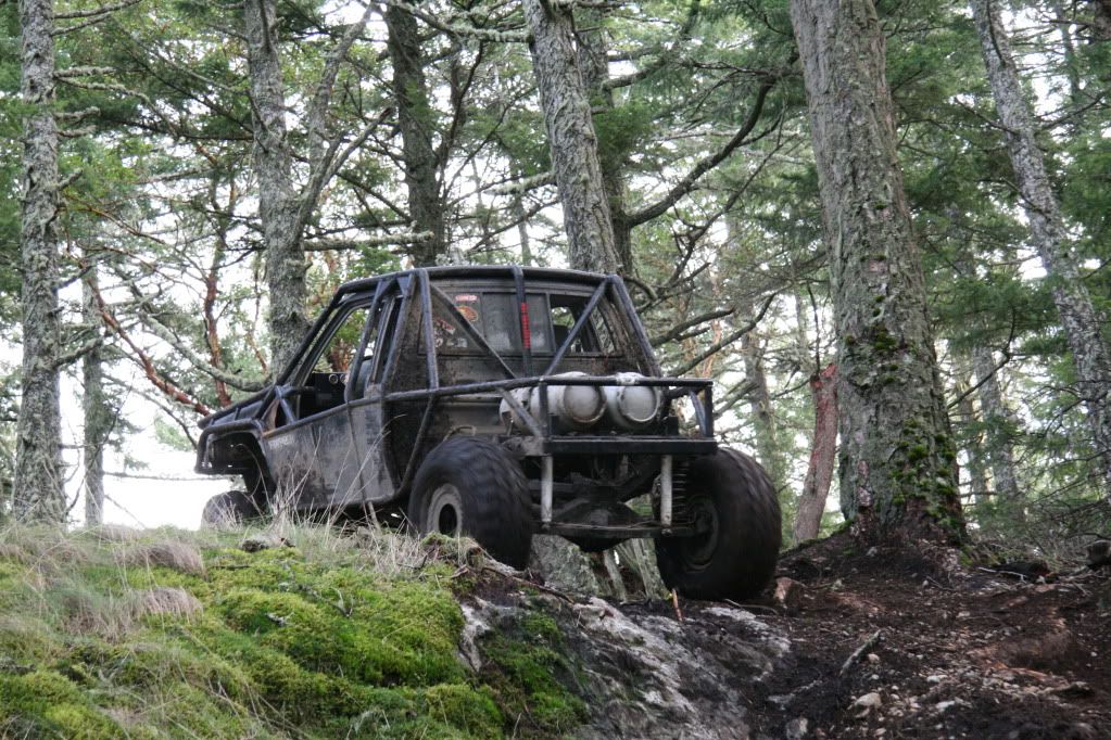

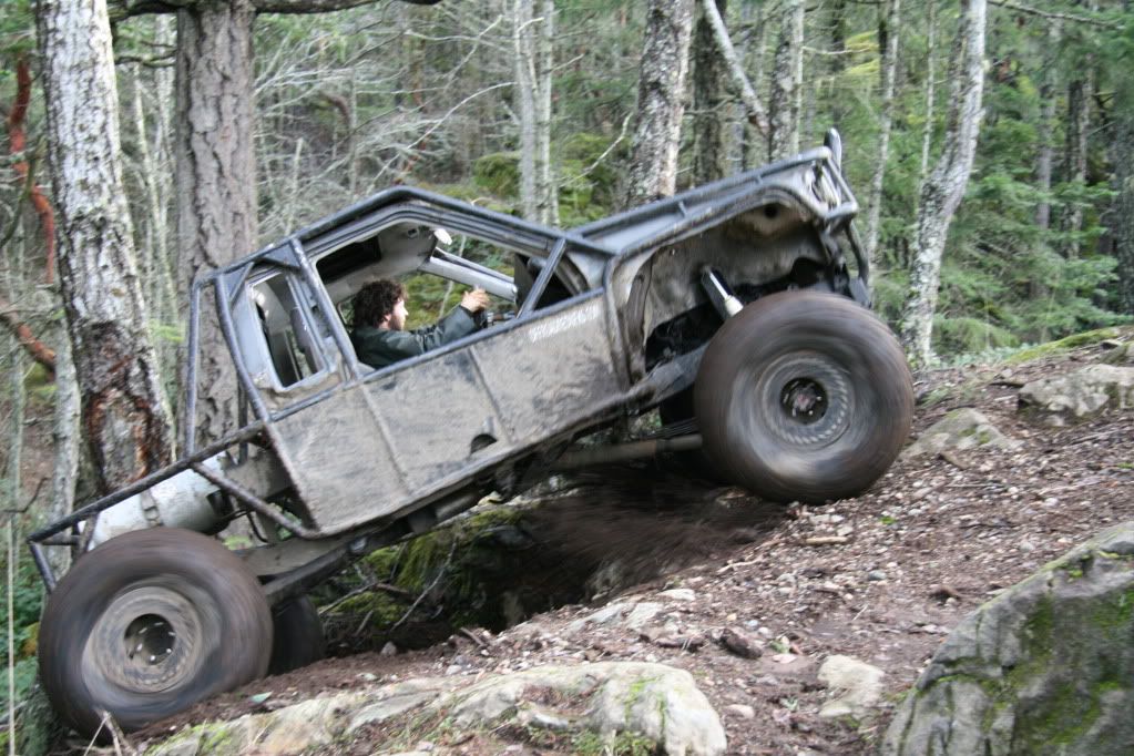

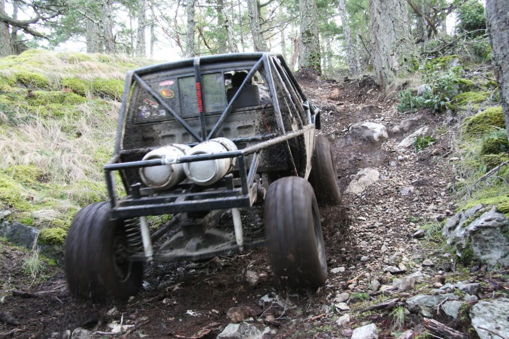

ya it's alot of fun
only thing that sucks abotu wheeling is you break stuff but my rig is pretty good now for not breaking

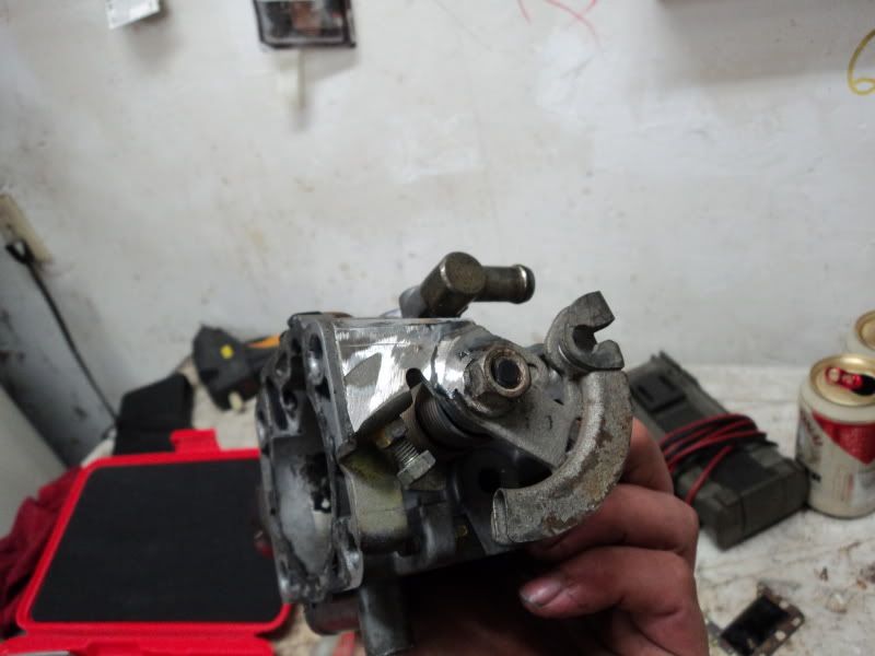

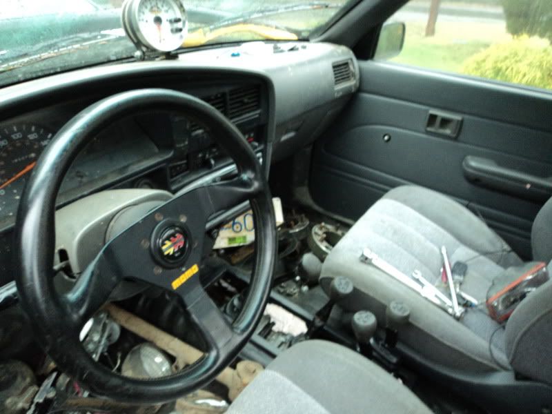

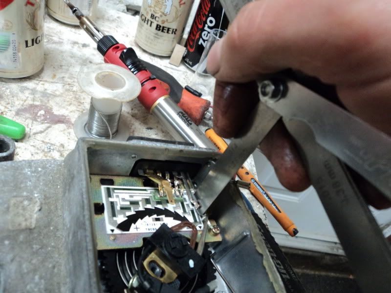

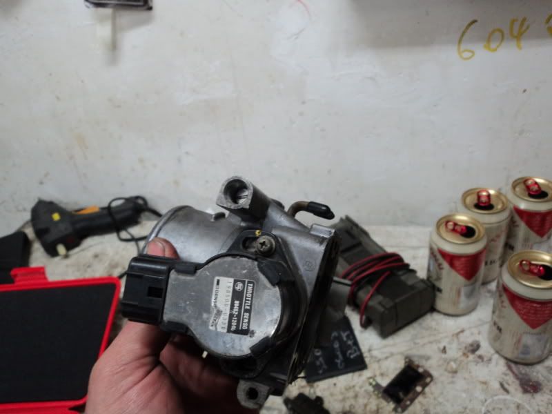

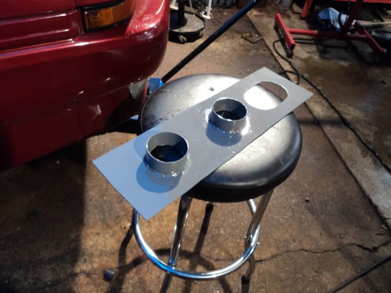

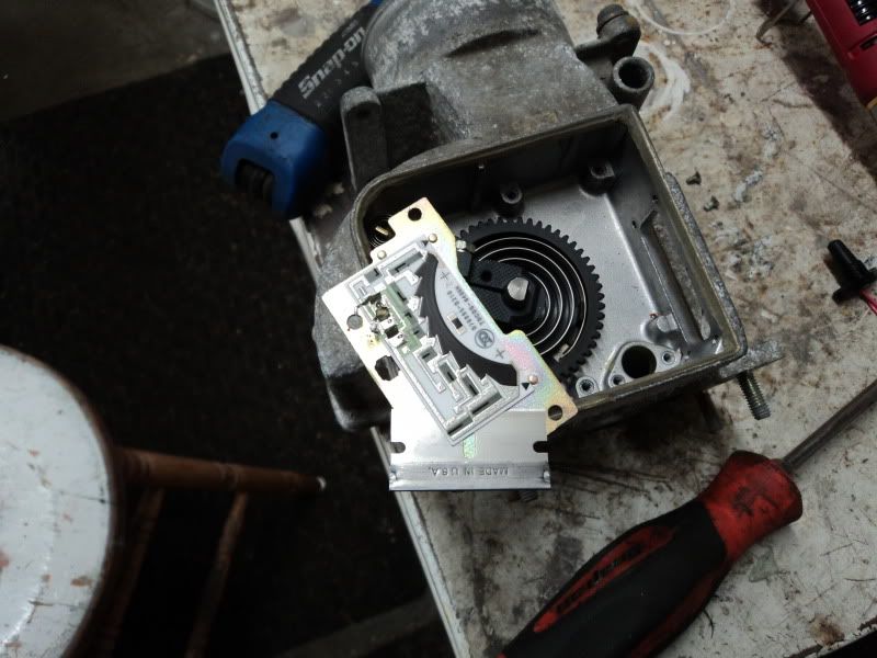

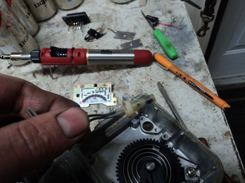

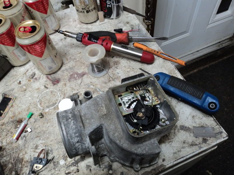

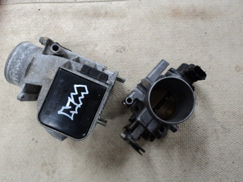

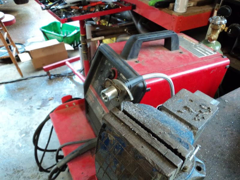

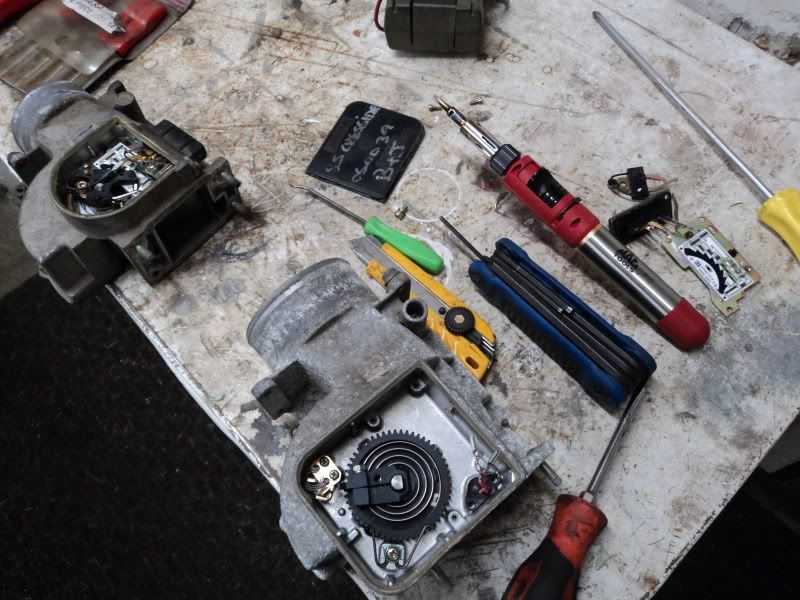

but i got bord today and made the NM power package
custom 5mge afm (bord swap)
87 to 88 7mgte thottle body swap 22re tps and re did the linkage
apexi sfac 2 if i can get it to work wiht this wacky scaleing
here some pic's
