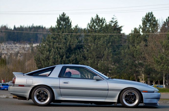

Hi there!! I don't have the same wheels as you, but they look kind of similar...
Panasport G7s.
Funny we had the same idea there.
Just stumbled upon your build thread - its been a great read so far! (though I am only about 1/3 of the way through....) Nice to see another Ice Blue Pearl Supra being taken care of!!! (and not painted another color haha)
Keep up the good work!!
-Faye

Thanks man!! Those wheel do look good!!
I plan on using 295s in the back and 255s in the front. This may or may not change depending on how much clearance I have after installing the coilovers.
