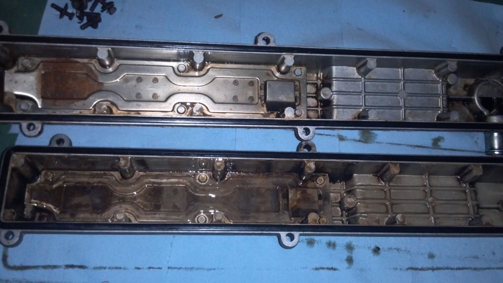

The valve covers, top one is the one I cleaned, the bottom is the other before I cleaned it.

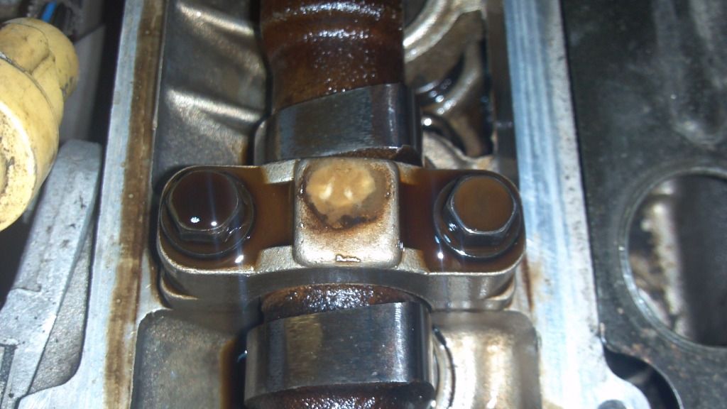

Can tell coolant has been here lol

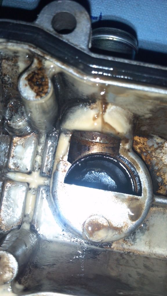

Looking into the plug hole, pretty grimy

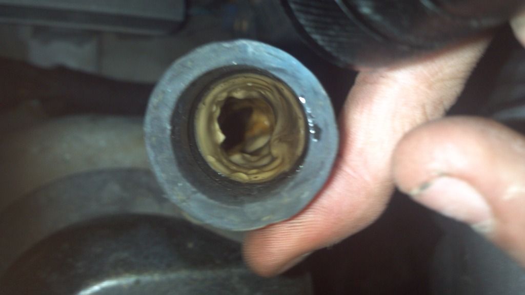

The oil return line, It was pretty clogged up, I pulled it and flushed it out with a water hose.

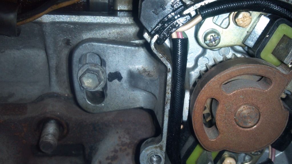

The CPS before I pulled it out.
Maybe I'm overreacting, but this seems like a huge mf deal here.
