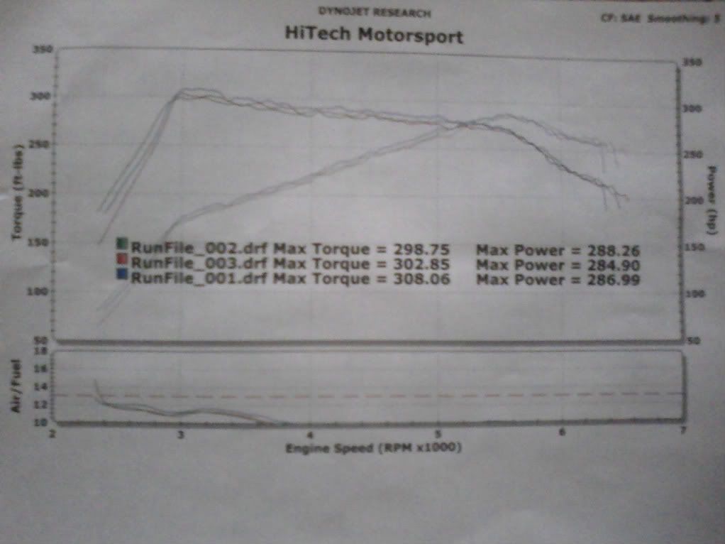

YEP. In fact here is the dyno sheet on 100% OEM electronics, fuel system and turbo (and still to need to take fuel out). And If I would take the 272 cams and reinstall the factory turbo cams the HP #'s would be considerably higher ;) 272 dont like low boost.
The A/F ratio is on the bottom of the sheet. Well under 10 as soon as boost comes on. Boost levels are 10-11 lbs on oem CT-26
Dyno sheets dont lie so here it is

Awesome numbers!! I cant belive thats just with more boost. No other mods at all, intake, exhaust?
