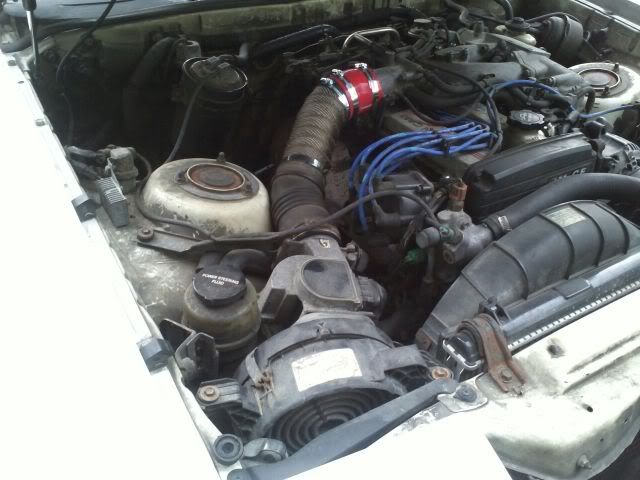

You can only remove the AFM if you go with a standalone ecu and switch to a MAF or MAP sensor setup. That is not necessary unless you're building your engine with some significant mods (cams, higher compression, or turbo etc...).
Don't worry about the stock AFM. A stock GE will not outflow it, so it's not that much of a restriction.
If you can find a stock air box from a 7mge, it is a cold air intake to begin with. If you go with an open pod or cone style filter in the engine bay with no heat shield, you will loose power as you will be ingesting the hot engine bay air (it gets quite hot, especially with the intake being on the exhaust side).
So, this is what I did:
3" aluminum pipe and new coupling at the throttle body to replace the old one with a sharp bend. Pipe is heat-wrapped to keep the heat out. I also kept the stock air box but removed the front face of it. In leaving the rest of the air box, it still shields effectively from the hot engine bay. Also installed a K&N drop in filter (done after this pic was taken).

Awesome thanks for the response, I was thinking about this yesterday I may do hard piping to the AFM then get an after market pod filter and adapter plate. Then make an enclosure for the pod filter.
How does that sound? is there a certain length the piping needs to be? I assume it is 3" pipe through the entire way? and filter size, I'm unsure if size matters for the 7mge?
So from what I see in the photo I'll need a few hose bends, 3" straight alloy pipe at whatever length it needs to be, attach AFM then pod filter, build/buy enclosure or heat shield to suit is this correct?
