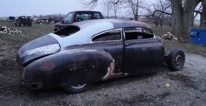

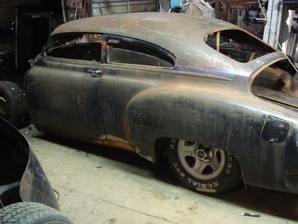

I'll have to get some newer ones, all I have are one or two I snapped of it when we were digging it out of the garage my uncle had it in. It hasn't changed much in the past 2 years since then. All I've done with it so far is clean it out, rebuild the carb, change the fluids and put some scrap tires on that hold air. It runs, but the gas tank leaks. I just don't have alot of time to work on this one.

Nice fleetline. The back end on those looks so much nicer than the styline, especially with the chopped top.
