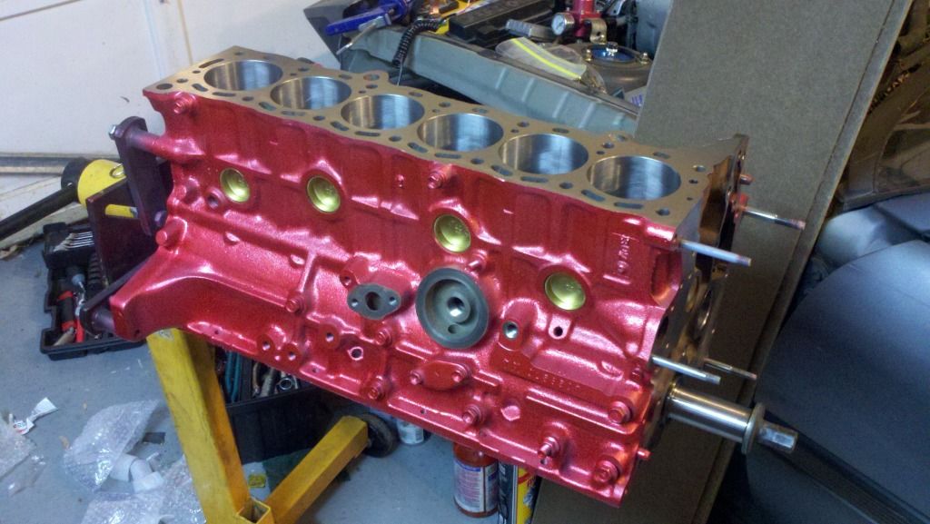

Probably by now, those stubborn pins are out but I want to share how I pulled mine's off today. This is an easy step by step tutorial.
Step 1: Get a hold of grinder/cut-off wheel + a hammer + washer + pry bar & flat piece of metal (most of us have this tools handy).
Step 2: Place the washer over the pin.
Step 3: Convert your pin into a "nail head" by grooving opposite sides with cut-off wheel.
Step 4: Place a piece of metal under the pry bar in order to protect your block.
Step 5: Hit the pry bar against the pin with a hammer to further secure coupling.
Step 6: Pull that stubborn dowel pin out.
Step 7: Look at your pin free/undamaged block.

Hmm,
Your block's the same color as mine.
