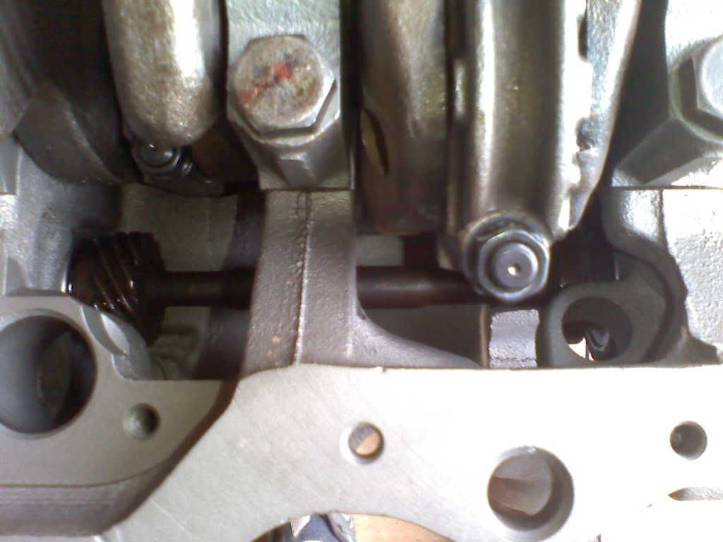

Went out again last week and got the oil pump driveshaft in. That guy was fun, but we got the bearings down to size so it's all good to go. Just waiting on a few bolts to get the oil pump on and then the front engine cover goes on, pan and then head.
You don't happen to know where I can buy a oil pump driveshaft do you?

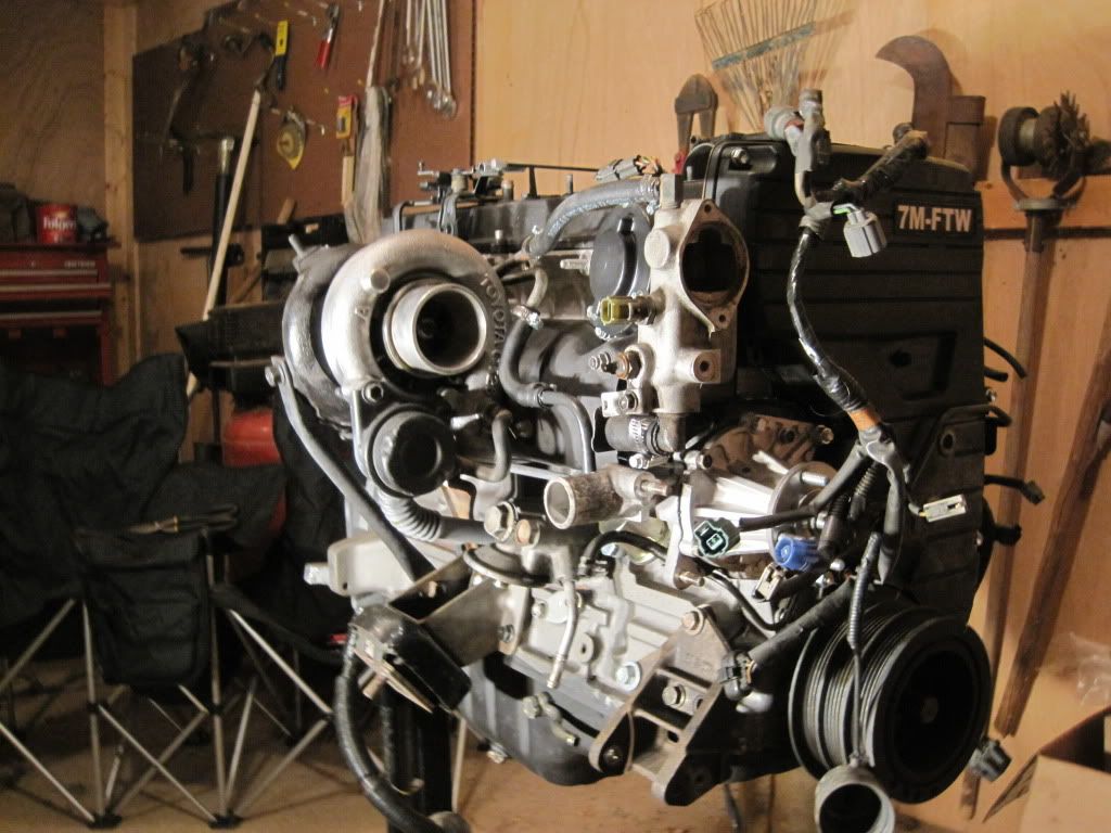

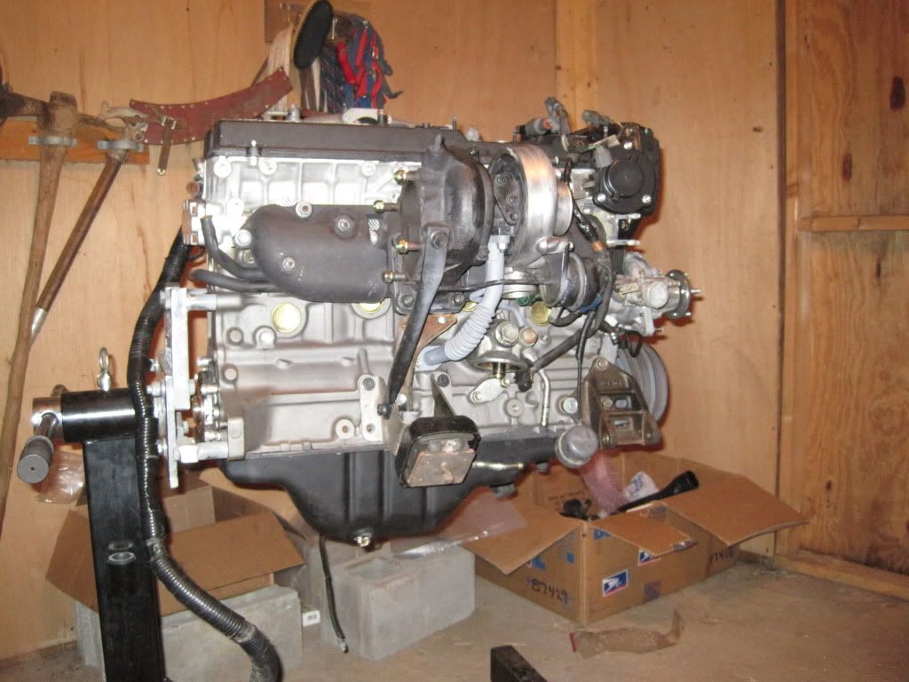

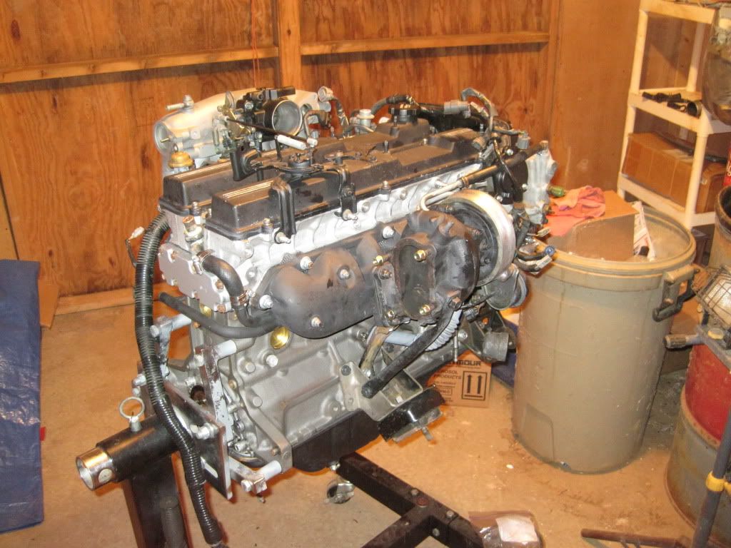

Here is the latest progress. I am still having trouble with my autometer oil pressure sending unit. It will not thread in. It is starting to piss me off. It's really the only thing holding the build back.

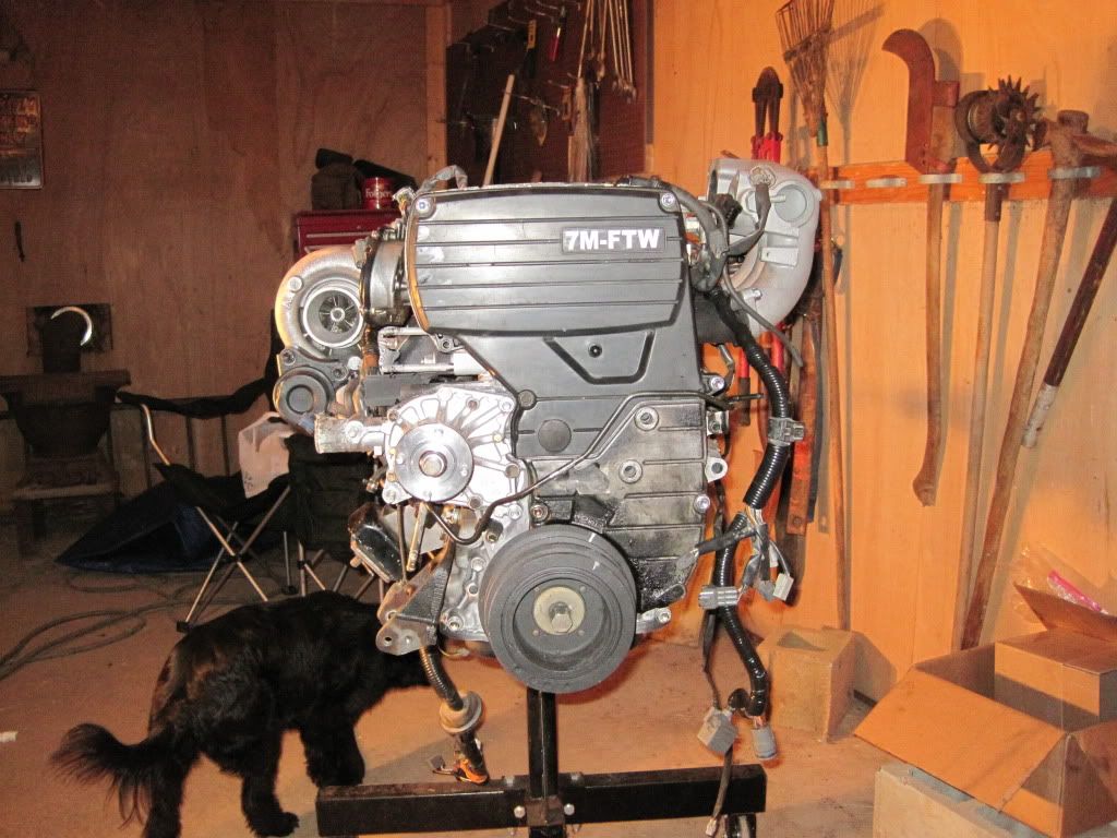

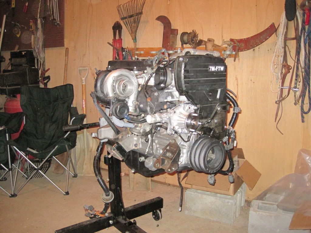

I plan on putting this in over spring break in march. Since I am in school I need a good bit of time to get it all in and broken in. I will be going out this weekend to put the plugs in, coil pack on and 3000 pipe on.

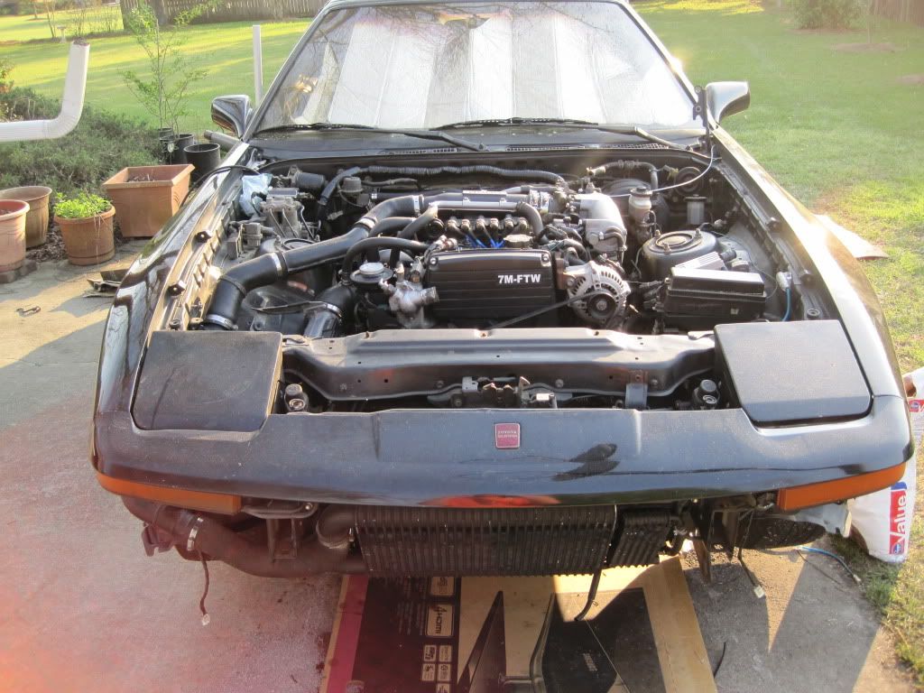

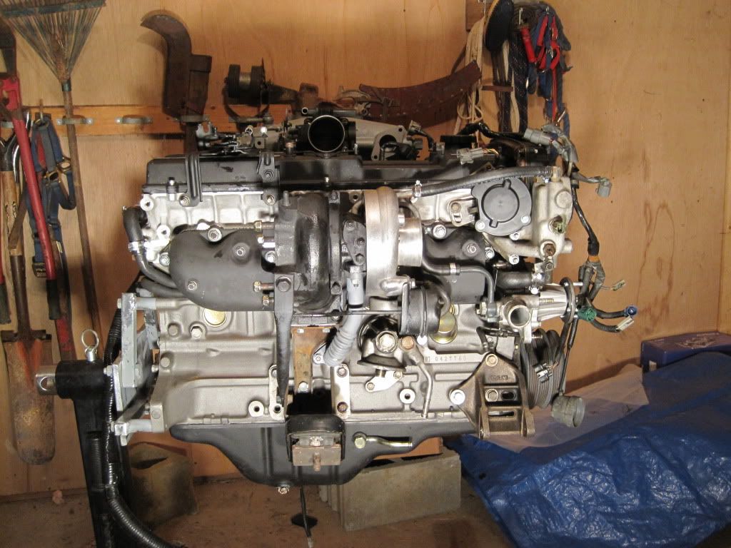

I will have to check my numbers for the ring gaps. Here is the latest progress. It's pretty much done for now. I will be putting it in the third week in March. I will put recent pictures up later. Photobucket is being a chode.
