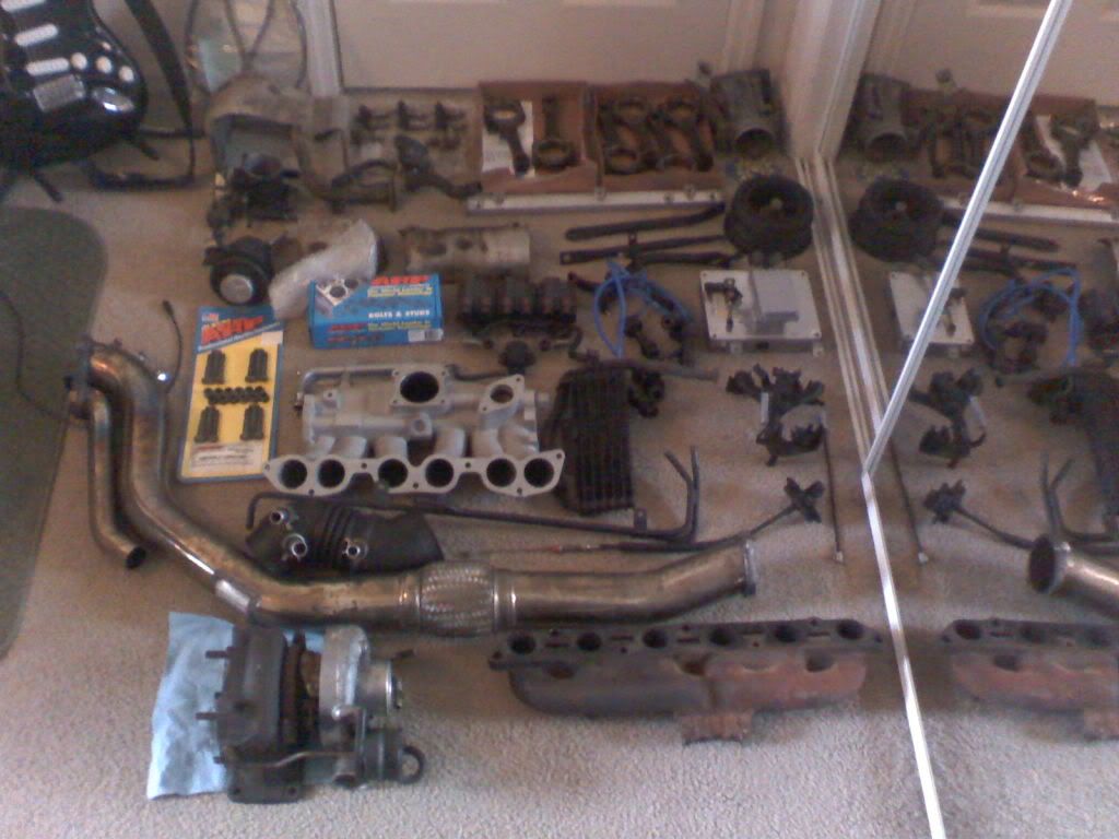

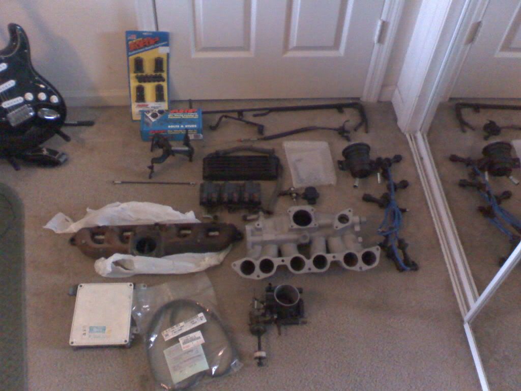

First wave of parts came in this past february
Got a few more a month or two later

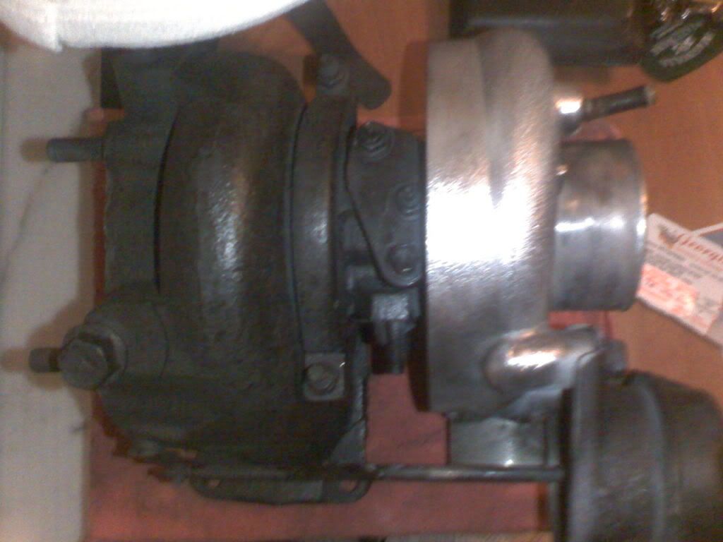

crappy camera phone pic...cleaned up the turbo a bit

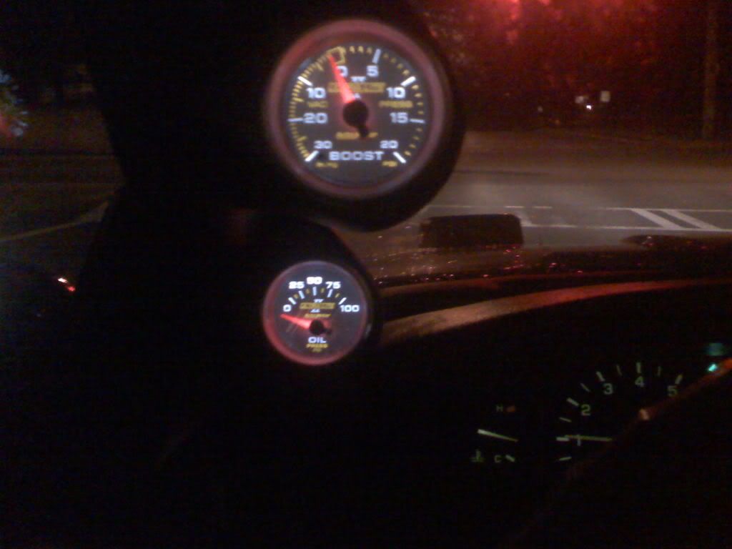

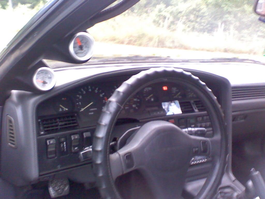

Went ahead and mocked up the gauges so it would be one less thing to do once it goes in. I left them in for a day or two and pulled them back out. It was too ricer to leave them in until the engine is done.

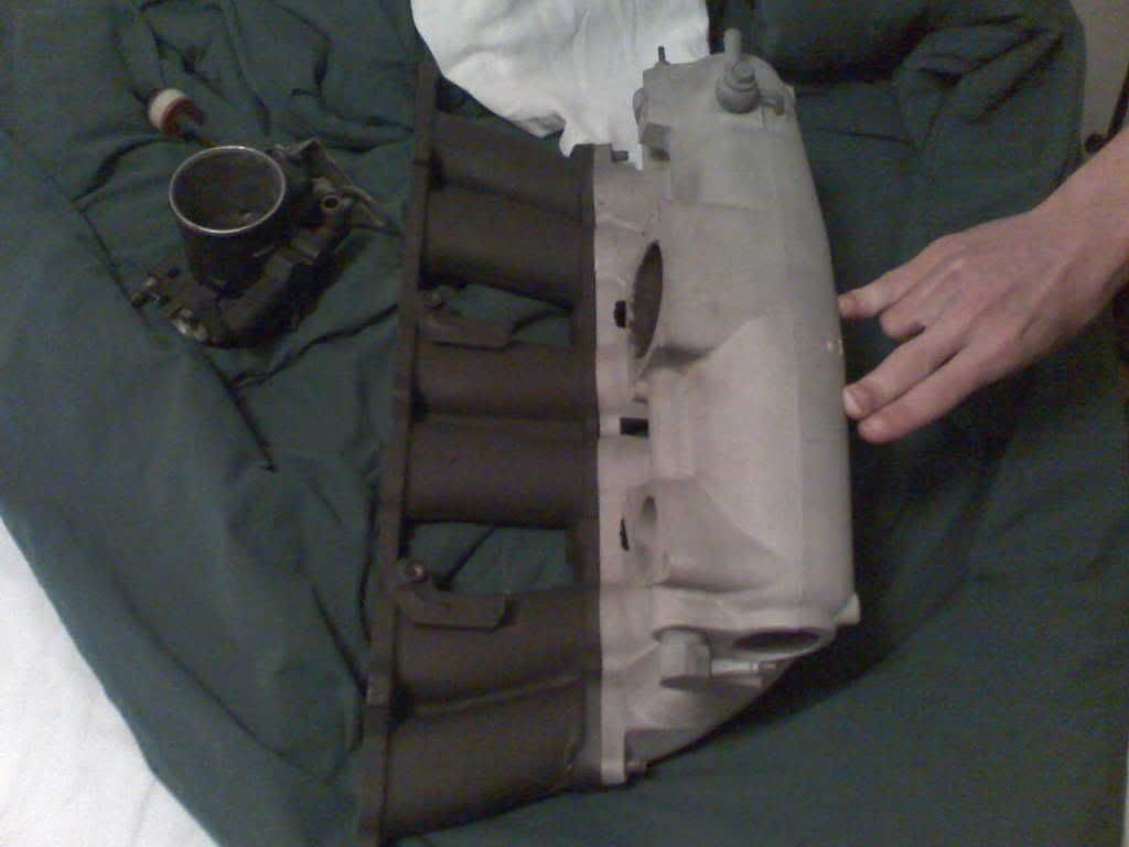

Decided to see how it would look to paint the lower intake mani black. Seems like it will look nice

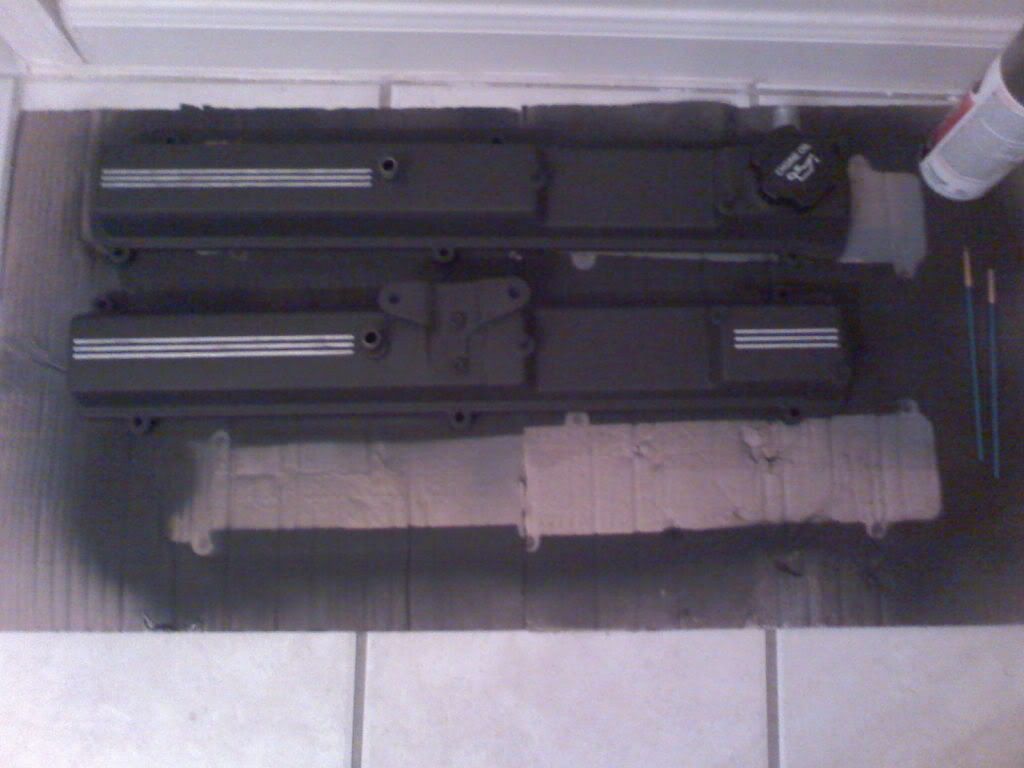

Painted the valve covers a flat black also

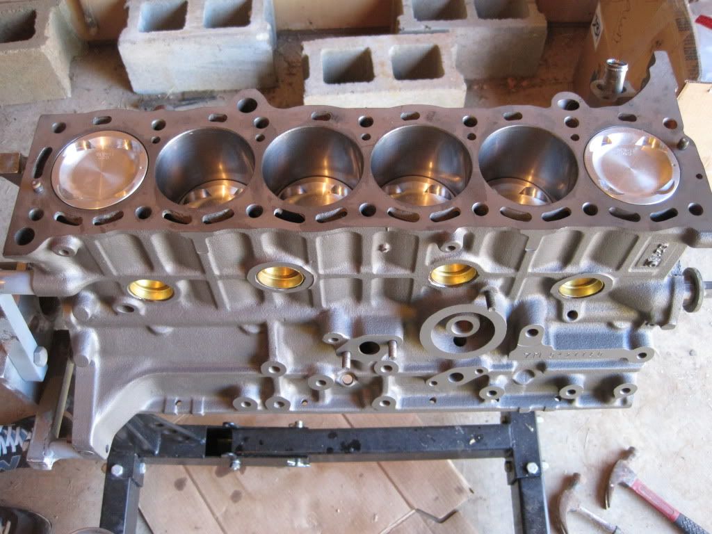

New npr 20 over pistons

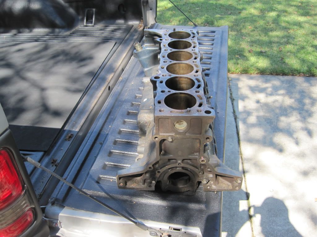

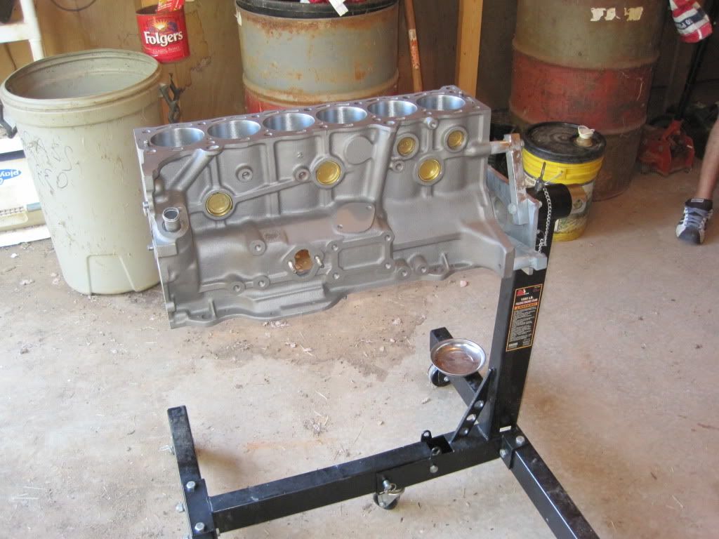

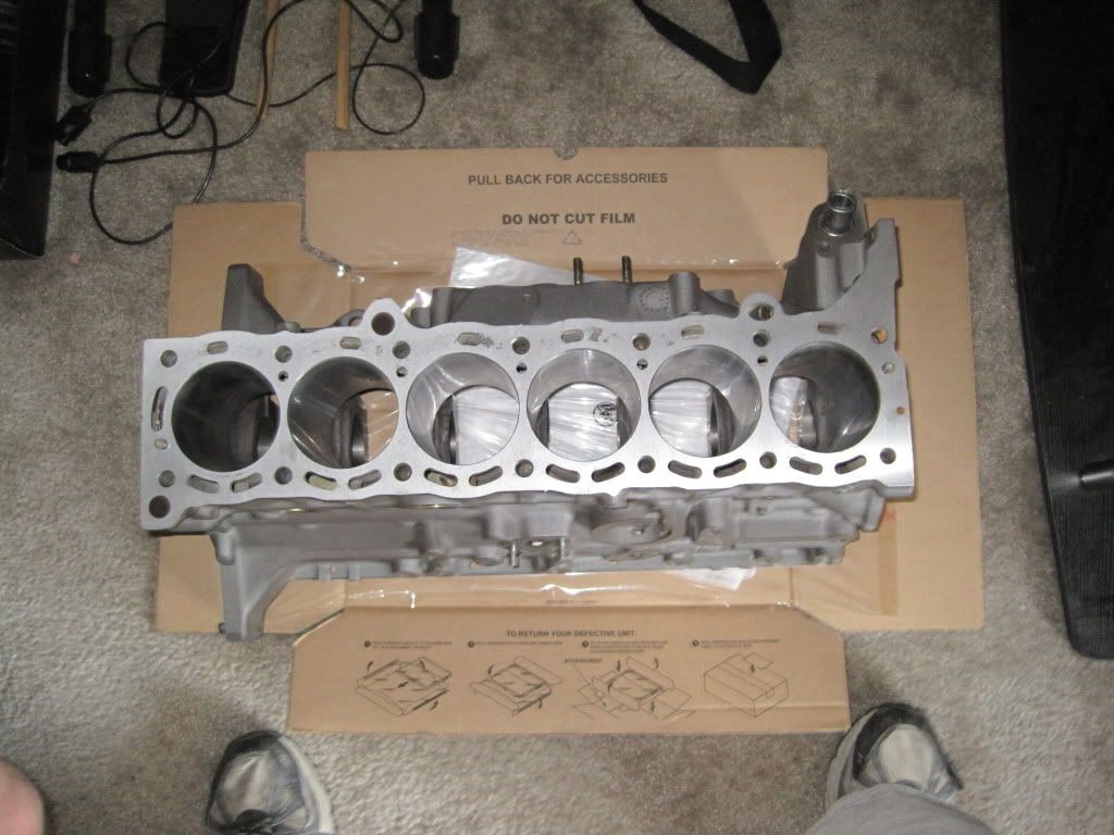

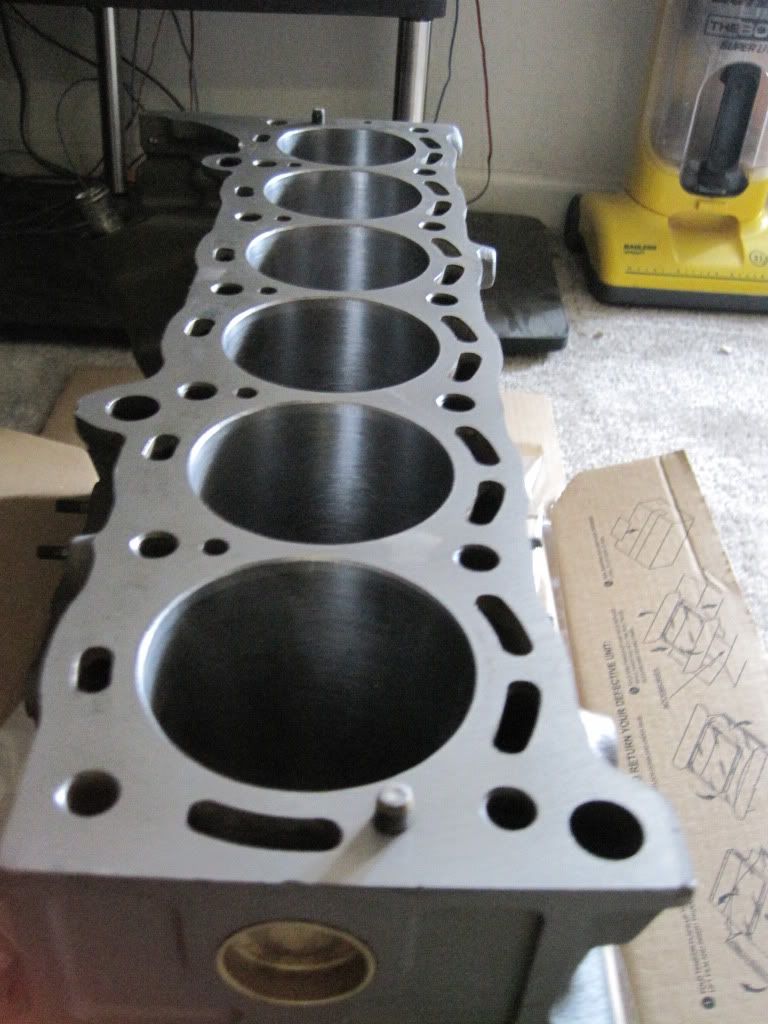

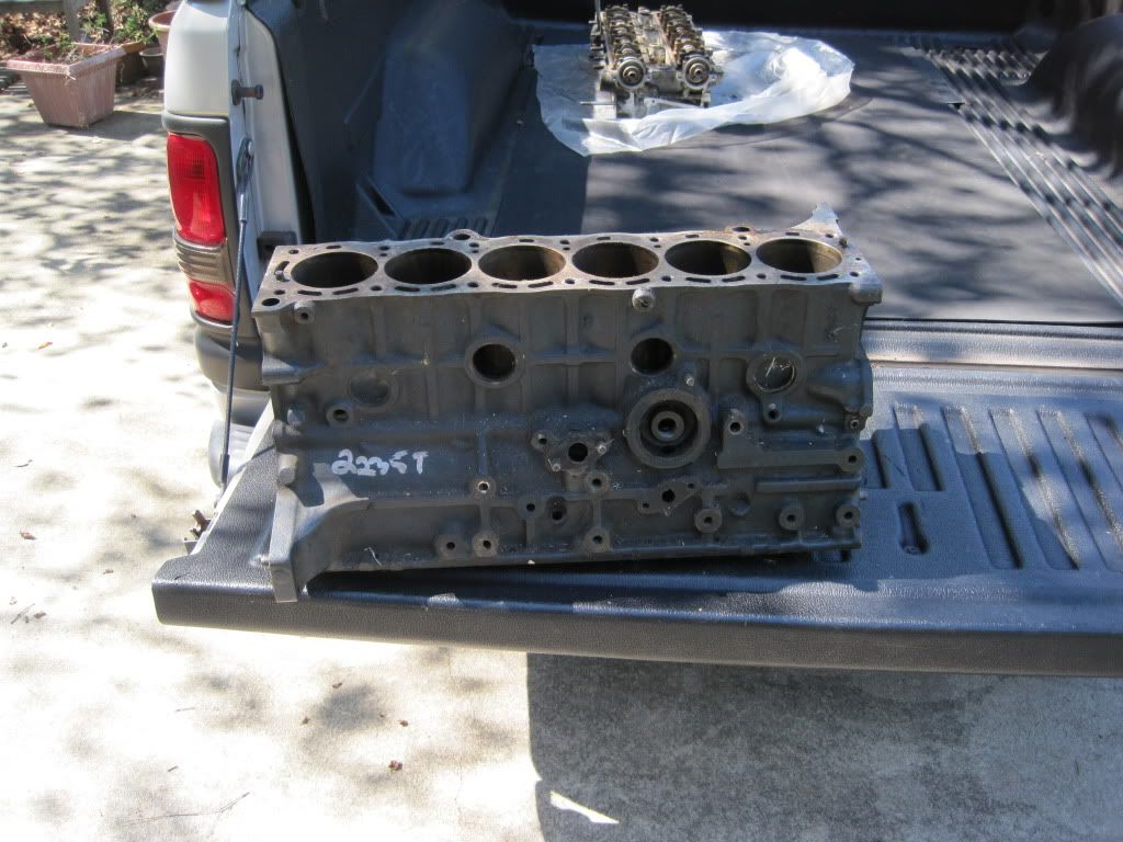

Block before the machine shop

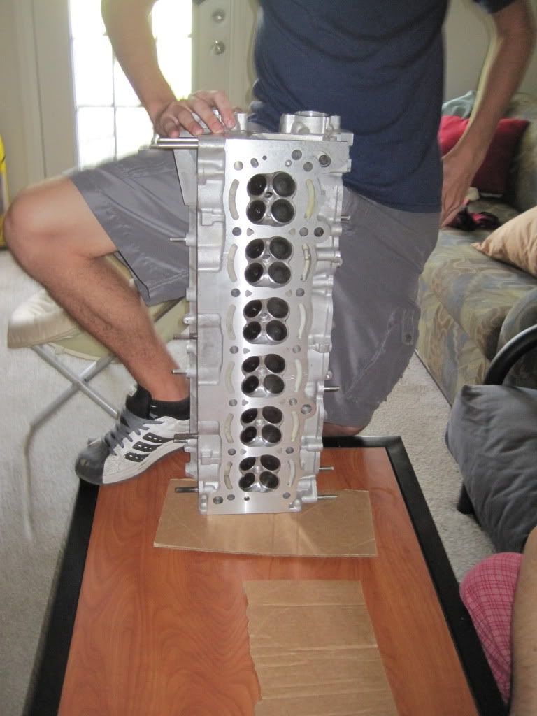

Head after the machine shop

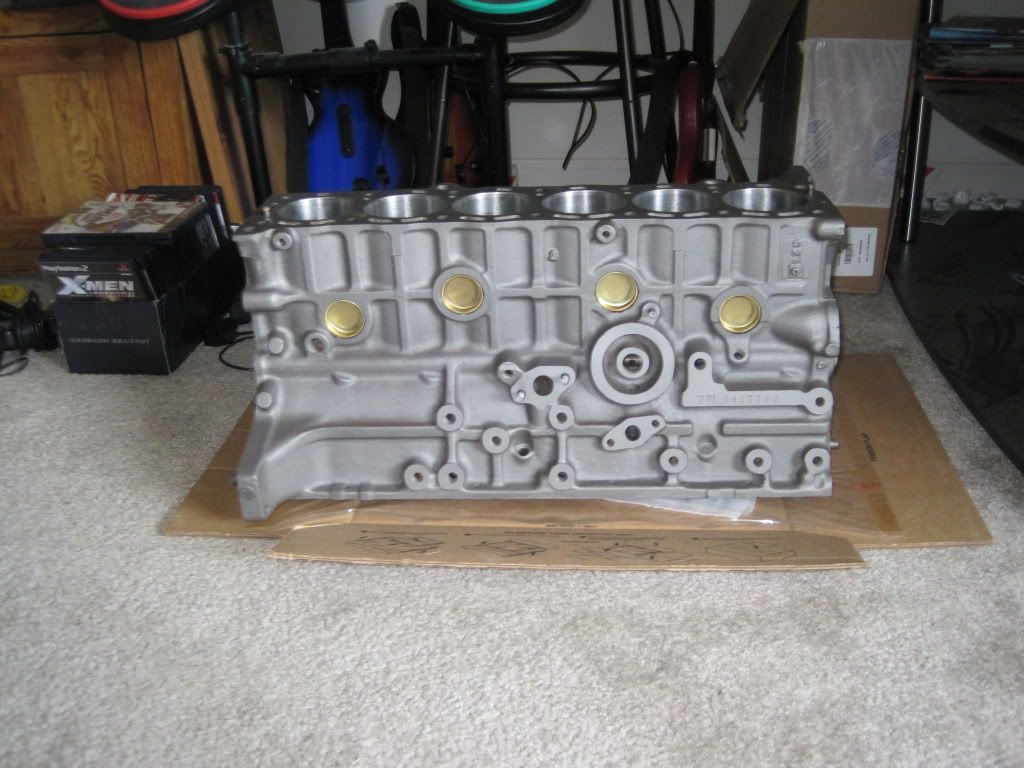

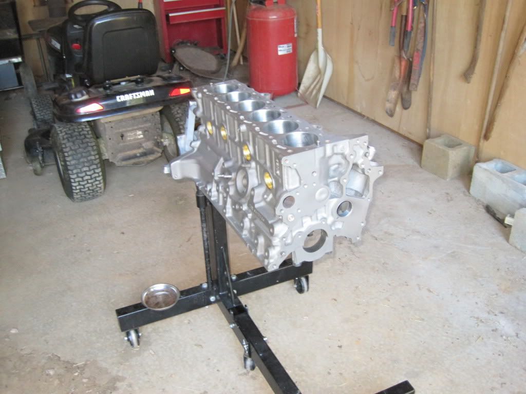

Block after machine shop

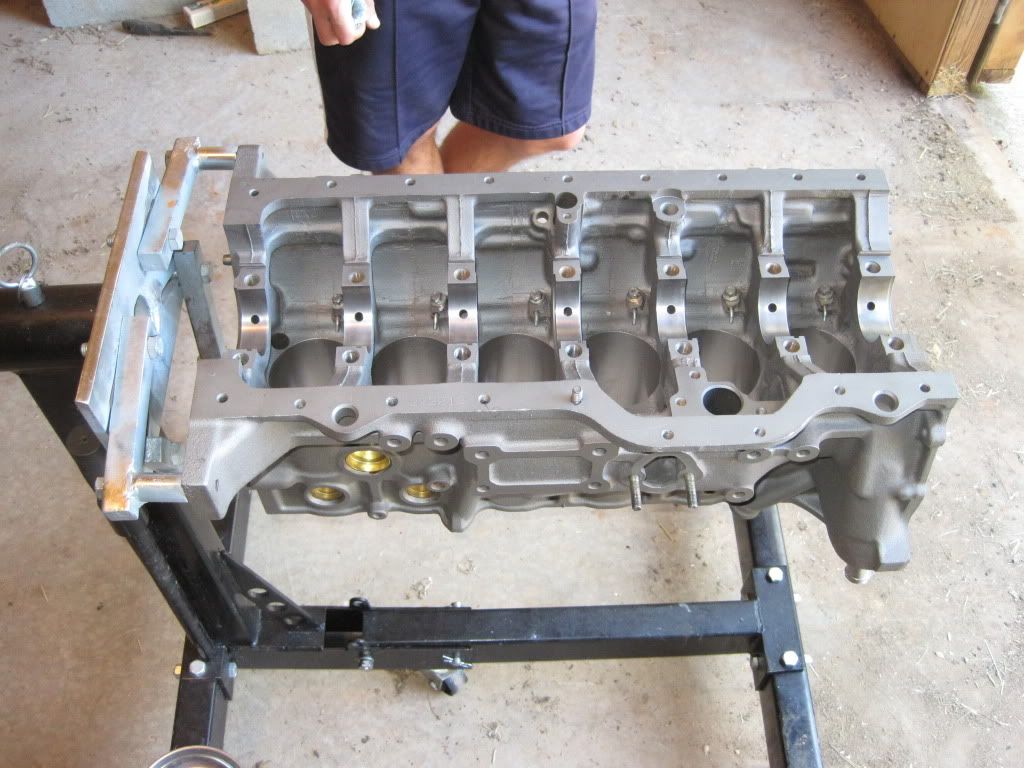

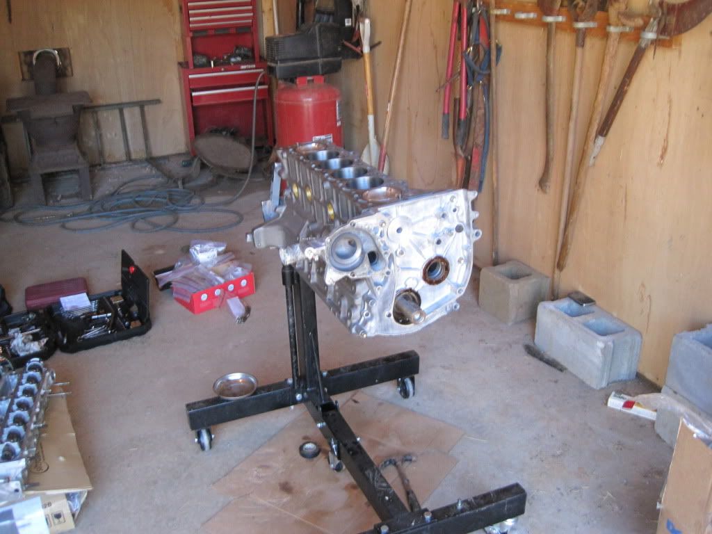

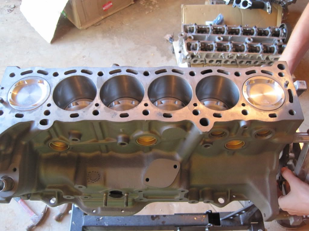

On the engine stand and ready to go
Polishing things up before the crank goes in

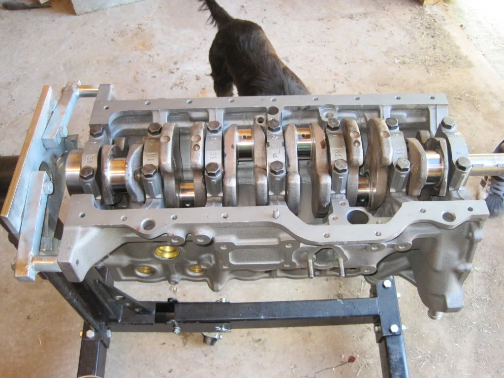

Crank in

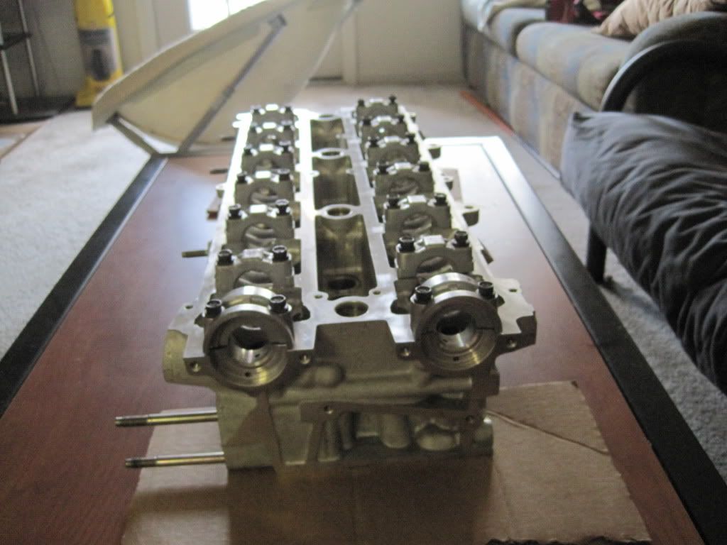

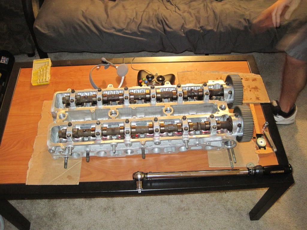

Head with cams installed after all of the awesome valve shim calculations

couple Q's...
Are you painting the block and other parts?
Did you take the plugs out of the crank and clean all the oil passages out?
and your puttin in new oil squirters right?
looks good man, lookin forward to seein progress.
I am going to leave the block how it came back from the shop. They painted it with some kind of paint.
The machine shop took the plugs out of the crank and cleaned that all out.
The oil squirters are the original ones that came with the block...I just let them soak in mineral spirits for a few hours before I put them back in. They seemed to clean up very well.

mkay. well ive seen tests on used oil squirter flow, and it varied so greatly from a trickle to full pressure cause of the spring inside just dies. but i went na-t so, no need for them anymore.

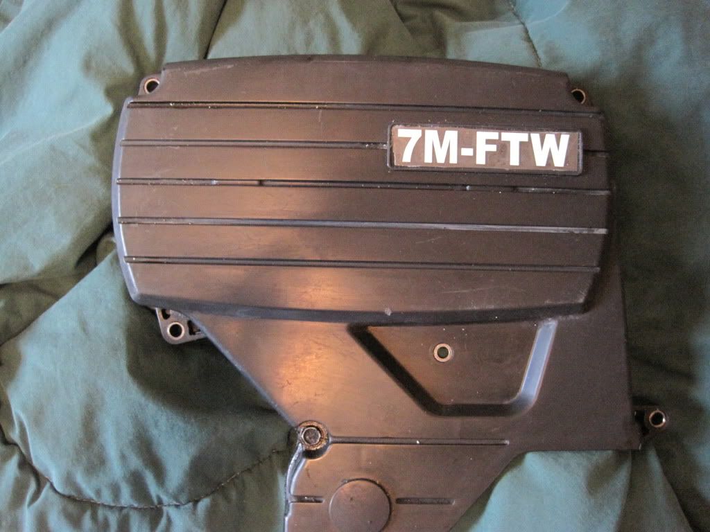

I took the white cover off to just leave the letters behind and it looks much better. I will get a picture sometime.

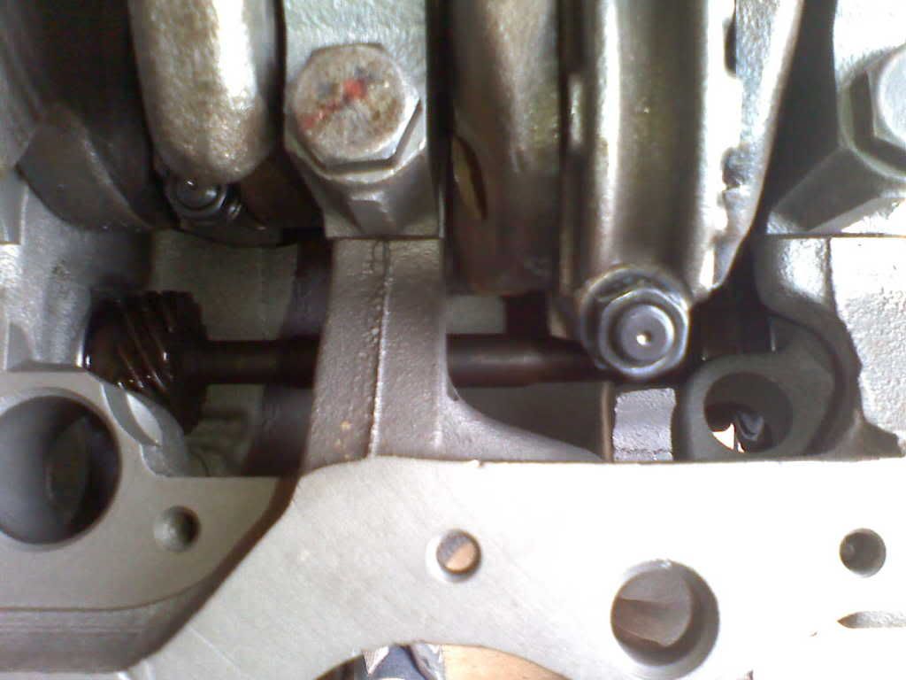

Went out again last week and got the oil pump driveshaft in. That guy was fun, but we got the bearings down to size so it's all good to go. Just waiting on a few bolts to get the oil pump on and then the front engine cover goes on, pan and then head.
