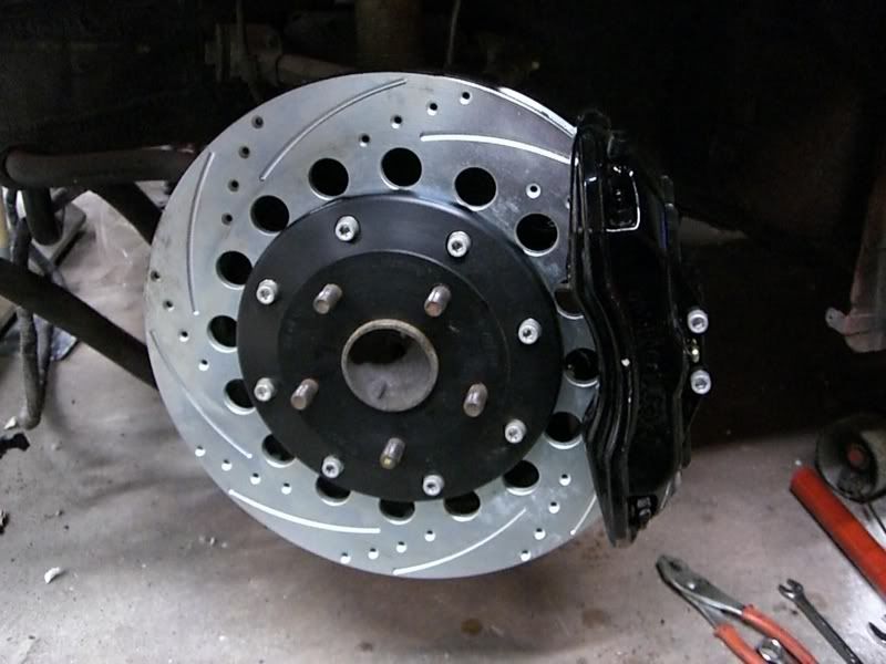

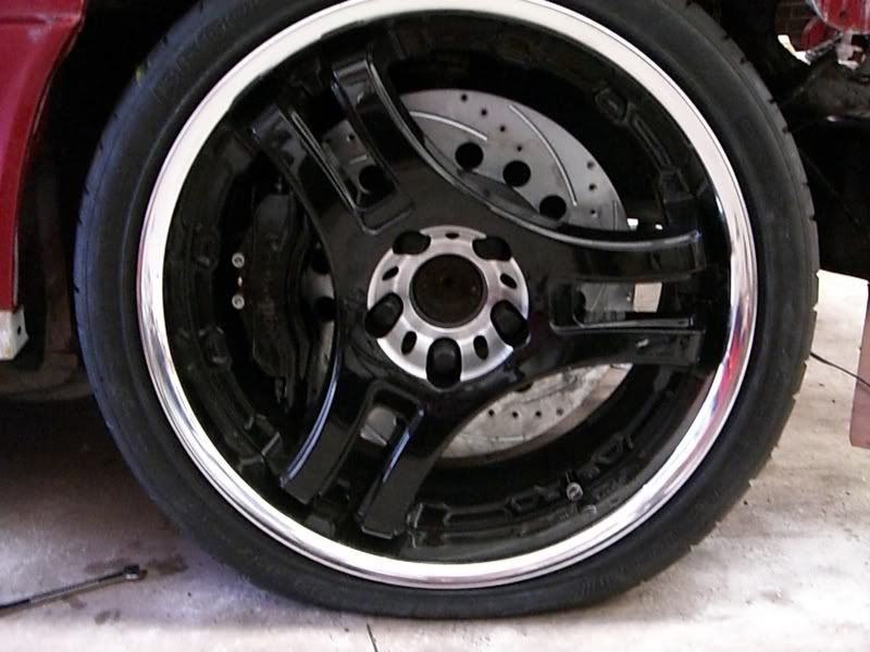

Ok so i mounted the first side today with the 6 pot monsters. All was going well until i mounted the wheel. It won't clear the caliper. The way i see it is i have two options. I get wheel spacers to push me out at least 5mm or i start grinding on the lip of the caliper. It seems worse on the ends of the caliper, i think the middle would only need a few mm shaved off. The 14" rotors have loads of space around the wheel. Must be the style of the wheel as the spokes slant inward.
Open to suggestions guys. I don't want to weaken the calipers by grinding them if that is what will happen. Not to keen on spacers as the wheels fit nice as they are..

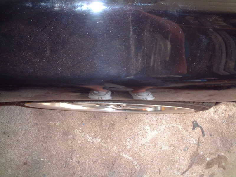

Here are the pics, me a and my mate recon that a 5/7 mm spacer should be enough to clear the caliper. Don't really want to be grinding anything.
Quite clear where the problem is as the new paint is already scraped off.

Get spacers for now to clear them, when you have the money, sell the wheels and buy some that have the correct offset to clear your brakes. If you can get the same wheels in a different offset, good, if not, you'll have to compromise on the wheels. Don't start grinding calipers, IMO.

Yes, I agree with everyone else. DONT grind the caliper. Those are old GN calipers, they were just regular cast calipers, that stiffening rib is VERY functional. All the newer calipers are forged, or the billet is forged then machined, either way those older calipers are not near as strong and subject to bridge flexing so definitely DO NOT grind that rib off. Im not knocking that caliper as it will still be 100% better than the stock brakes, but its just not as good as Wilwood's current calipers.
As for "OFFSET". Everyone keeps referring to Offset, and that really has nothing to do with it. The term you guys are looking for is "Caliper Clearance"!!!
Since all newer car manufacturers hang the caliper outboard of the wheel mounting surface all newer cars require more caliper clearance than the the older ones. If you look closely the factory MKIII caliper required almost NO caliper clearance, yet look at the back side of a factory sawblade wheel and you will see there is a TON of caliper clearance. WHY, Im not sure, maybe they did something different on the racing circuit, maybe they anticipated a change later in the model year and nobody but old people bought the car and no one complained and they left well enough alone.
I have had another customer in Germany that had these really cool old school 17's that had 43mm back spacing but had ZERO caliper clearance and wouldn't fit without 35mm of spacers. Needless to say he just got new wheels. Im sure you can find a photo of these wheels but they were bronze on a bronze 2 tone car (I think) and had an awesome lip on them, bummer they didn't have any clearance for bigger brakes, because they looked VERY COOL.
Remember its not offset, its caliper clearance, and the only way you are going to find that out is to make a caliper template and fit that template to the wheels in person to make sure.

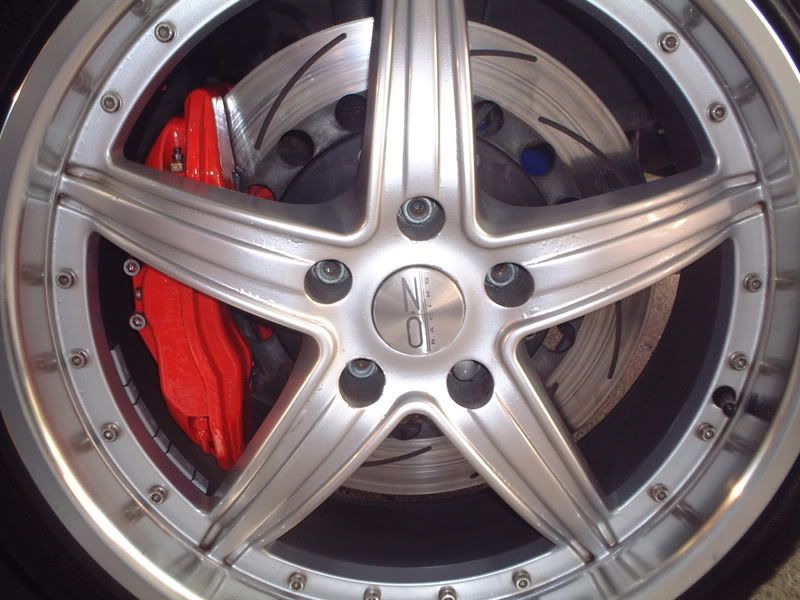

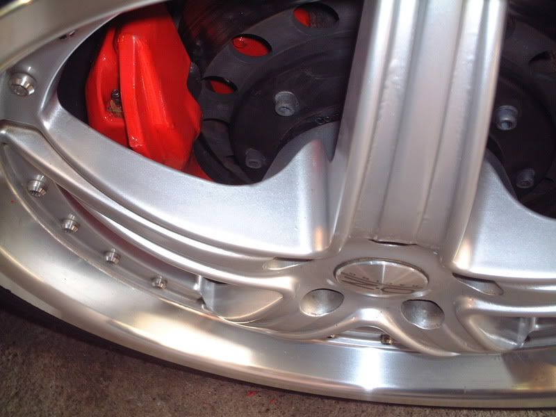

Thanks for the reply, would your calipers be the same dimentions as these ones?
I have played about with some washers today and i need 10mm to clear the caliper min. I think my wheel is bent as it is very close on two spokes about 2mm clear and the the others are nearer 5mm clear. Not sure if that is enough clearance or wether i8 should go for 15mm adaptors. Going to be really close on my fender running 8.5 wide with 35 offset.
Pics fitted
Best clearrance
worst clearance
fitted pic with the caliper on the right side, got them wrong first time, lol
wheel flush

Washers are a very poor way to confirm that your wheel is true. Were you able to check this trueness before the brake install with the wheels installed properly?
Mine are flush front and rear, I think that looks great, as long as it doesn't touch the fenders too bad.
