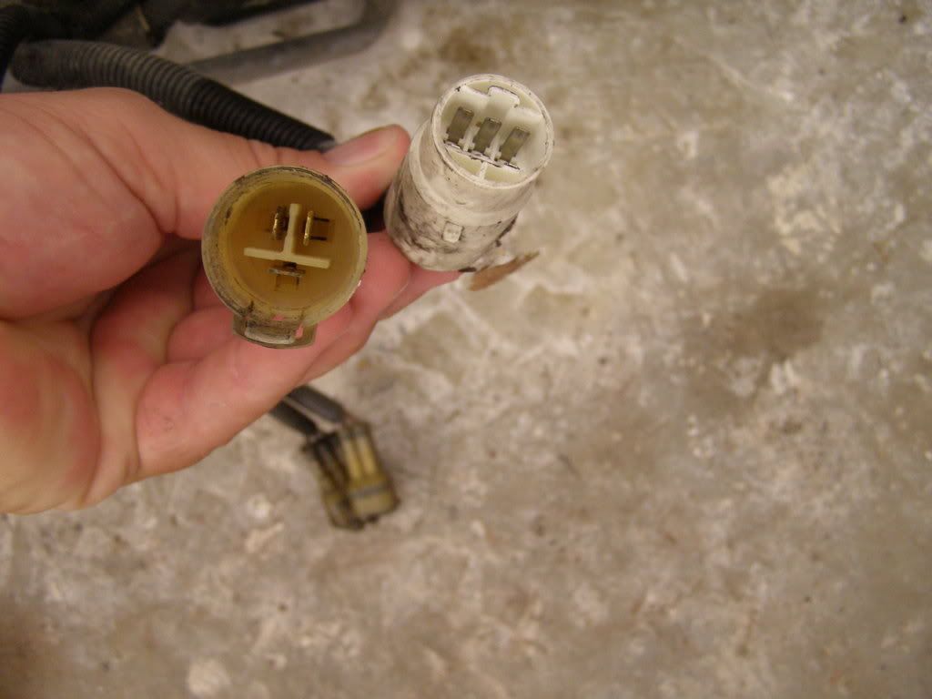

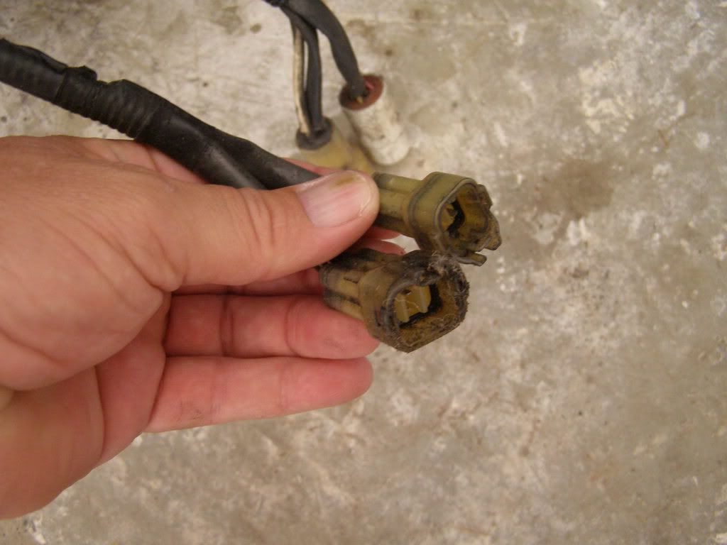

Okay so I'm in process of doing this.
here are the two plugs from auto tranny.
on my car w/original harness there is the 6 pin plug that is not attached to anything.
in second pic is the 6 plug that it should go to. which wires should I keep and what should I do with the others.
