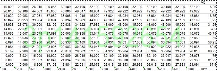

Would it be possible to post an excel style rpm vs load Ign timing chart? the graphs you posted are great, just difficult to nail down specifics.

I'll post the timing map shortly. I'm sure the standalones could use it.

Jon, I figured you didn't post the timing map in excel intentionally to encourage others to find it themselves. Posting or sending it would be most appreciated.

Attached is an image of the timing map. Haven't figured out how to attach files to this post. I would not use this map without a very capable knock-sense algorithm monitoring things. The stock ECU knock sensor is fast and pulls timing a lot during normal operation.
Wow those numbers are aggressive!
