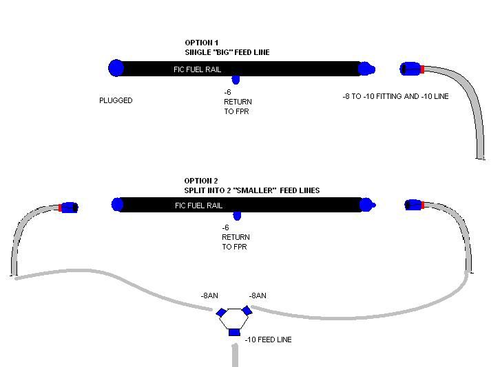

My current issue is the following. I'm contemplating in either running my -10AN feed and divide it into 2x -8AN and feed those into each side of the fuel rail. OR should i keep it simple and feed a -10/-8 AN in the rear and will it be enough? I can only go as high as -8 fitting on the rail so im not sure if it would make a difference in using a -8 to -10 adapter fitting.
Also the return is a -6 all the way through, is there an advantage of running something bigger? I dont think so but i may be wrong.
I will post a few sketches to help you decipher what i'm talking about lol...

The first option is simple and easy but would there be a bigger advantage in doing option 2?

James had ID1000 with Precision 7675. built everything, dual bosch 044 and only made just shy of 700 IIRC. he had to upgrade to the ID2100, now is making 800 something
---------- Post added at 11:48 AM ---------- Previous post was at 11:46 AM ----------
Oh ANd do the 2nd option. or at least if you do option 1, make the return on the opposite side of the rail

not to sure. Either way they are in parallel. I dont prefer this setup. Id go with an option 3. that is just me. But this is the way im doing it with my ProEFI and Bosch 044:
Run 1 Bosch 044 intank, fused relayed. This pump will run -6 all the way up to the front port of the rail. it will be running 95% of the time.
Run the 2nd bosch 044 in-line, (-8 suction. -6 feed) run it to the other side of the fuel rail. This is fused and relayed to the computer to ONLY kick on when I go past 5psi.
the middle port of the rail obviously would be the return.

Go option 2, -8 to dual -6 feeds or keep it all -8 but T off near the rail. Unless you are completely set on a -10. Keep an eye on that pump pressure full tilt either way. I know my Magnafuel 625 will flow enough E85 for over 1000rwhp, and it's only a -8 outlet. Flows more than my A1000, I am certain of that. Go with a good FPR, it will help you go further with a pump maxed to the limit.
I would get high imp injectors, at least 1600cc. Any newer injector is going to win, there is nothing wrong with older units. Give yourself some headroom on injectors and buy them once.
If you decide on option 1 for the fuel delivery, I would suggest blocking the middle return. Run a single -8 into one side of the rail, and straight through. Simple, easy, least expensive. Run the -6 from the rail outlet all the way through the FPR back to the tank.
I know of no negative reason for a -10, other than the more fuel in the line to push all the way up to the rail, the more work the pump has to do to meet the pressure demands.

already have the ID1000s and already have the -10 line ran from before.
gonna go with dual -8's on each side of the rail and -6 return to a1000 FPR.
