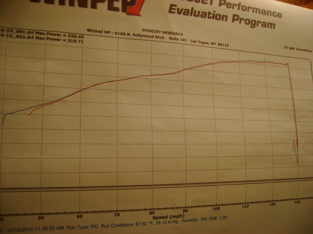

I have a cammed (Brian Crower 264) and ported 1jz. The car has a 3" y-pipe and exhaust, everything else is stock, down to the air box. With this combination, and a silencer in the exhaust, I made 320rwhp (~400hp at the crank if considering a 20% drivetrain loss). The car is VERY smooth, power comes on somewhat abruptly, but if you're above 2800 or so, it boosts nearly instantly. See the graph, lots of "under the curve" power for a more or less stock setup:
Unfortunately, that doesn't show rpm, but speed. Around 80mph in 4th gear, the car is making around 200-220whp, from about 3500rpm onward.
Personally though, if you're willing to spend some money, a 2j is certainly a nice option. High compression AND boost? Yes please.
