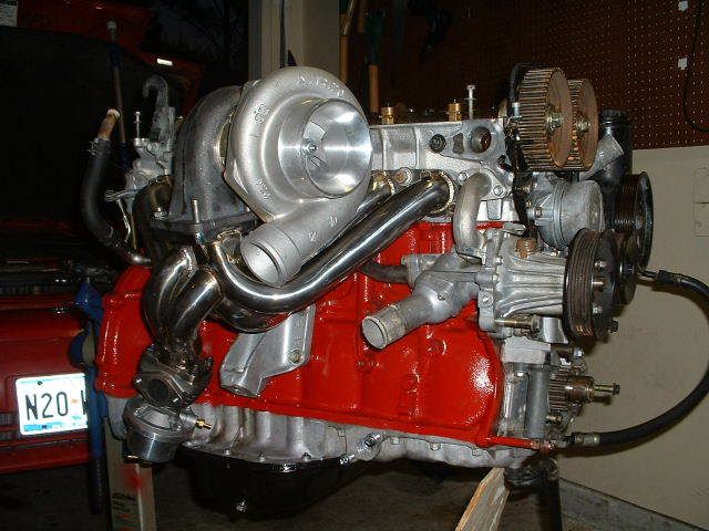

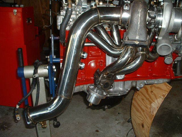

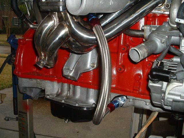

Here's a few pics.
I remember now the main reason I used a spacer was that the outlet on my S cover would sit on the #1 runner. If I clocked the cover to clear the runner it faced into the strut tower, so to clock it down enough to clear the tower, and also give room for a silicon hose/clamp a 3/8ths spacer was needed. Obviously this issue would depend on which turbo you run.
The last small issue with my setup was limited space for the oil drain. I needed a 45deg fitting off the drain flange to clear the line away from the runners. Worked well but you can't drop a drain line straight down. The position of the drain then also limits how far down I could clock the cover....
Pics before any modification/spacer.
Pic of oil drain.
Best pic I have installed.
