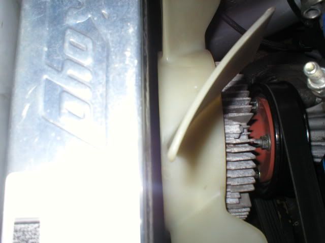

You should, that's ALL I picked up. The clutch and fan assembly came as one, I pulled my radiator, installed the unit, tightened it up, put the rad on, and fired it up. Worked great and I highly recommend it :) Here is how close it will end up sitting (hence remove the radiator)

Hell yeah!!! them pics are awesome... I now know what radiator will work... I guess the Koyo is ~3" think and seems to fit like my stock one (as far as distance to the fan). Can you do me 1 more favor tho?????
Get a pic with a ruler, going from the core support to the fan itself. I am now VERY curious to see if the 1J and 2J actually sit at the same distance from the core support. I'll try and get a pic of mine when I get home. I've got some very spiffy stuff going into my engine bay within a few weeks and replacing that fugly, leaking radiator is top priority. What are the dimensions of that Koyo anyways?

Will do, I'll take the car out later and snap a quick shot. The dimensions I will also get.
