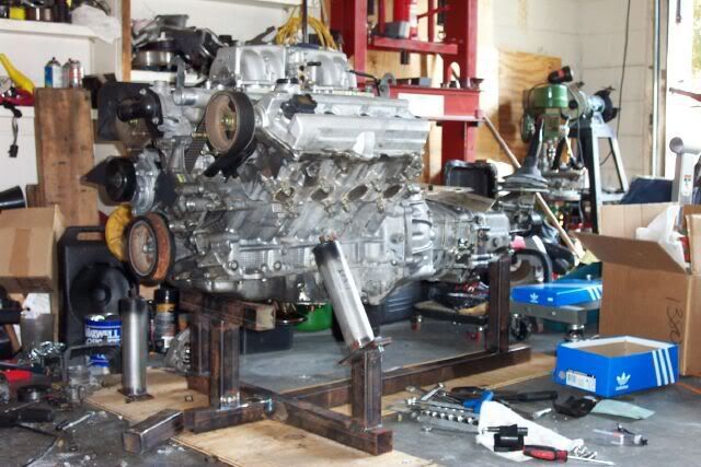

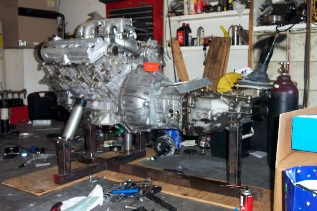

Well didn't really get a chance to do anything with the motor or anything that has to do with the swap, but did get a few pics to add.... (damn I need to do some cleaning in the garage)
View from front (obviously), sitting on jig.
View from rear.

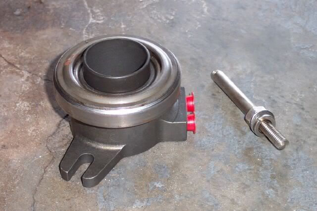

Hydraulic Release bearing assembly. Had to change the bearing on it to work with a toyota clutch and fab a new guide pin as the ones that come with it are SAE thread and it needs to be metric.

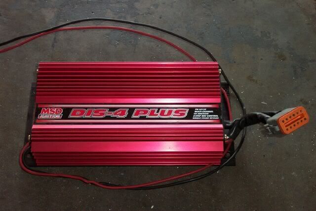

MSD DIS 4 Thanks to Ian.

IJ. said:
Nice clean motor Chris! :)
Actually its really dirty, especially on the heads. The cam/valve covers were leaking in a few spots at one point and I guess that they never bothered to clean the heads off before they fixed it. (nice thick, oily and gritty paste)

souprat said:
lookin sweet, your using an r-154? cant really tell, where did you get the bellhousing?
For right now, I am using a W58. The bellhousing is the stock V8 auto housing with an adapter between the bellhousing and the trans. When the time comes for the turbos to be installed, I am either going TKO (i.e. Ian) or might take on the trans tunnel mods and go T56 6 speed.
Will not go R154, I hate the way that those tranny's shift and I have had the W58 in the car now hold over 400whp with out any problems. (My secret treatment. ;) )

IJ. said:
Cad plating on the bolts!
It's usually the first thing that goes a bit crappy on motors! :)
Ah gotchya, I thought that you might have been refering to the guide stud for the release bearing. I was gonna say, that should never go bad being that it is stainless. Yeah there are still gray as can be for the most part, just dirty.
