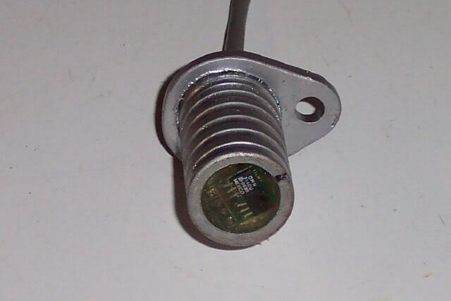

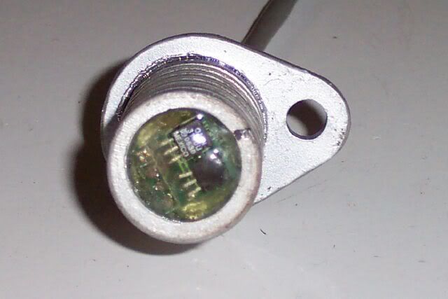

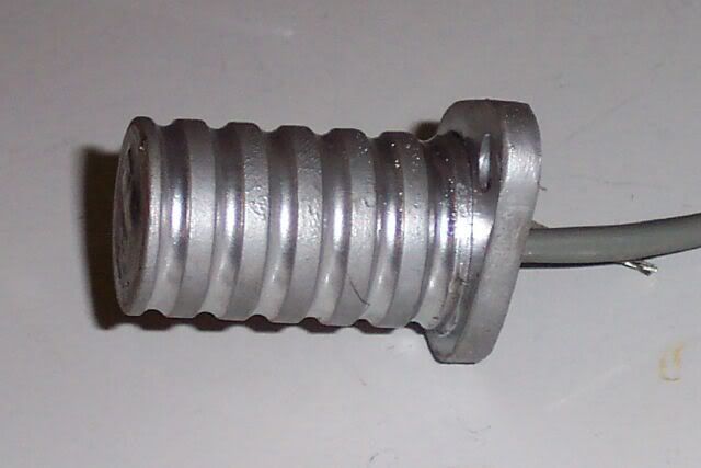

Well, its been a while since any updates but I finally got around to atleast doing something for the swap this week. Below are some pics of the crank trigger sensor that I had to fabricate from scratch. Although its not much, it is a major part to the motor actually running with my standalone. SDS sent me the tiny trigger elements and PCB and then the rest I had to do.
