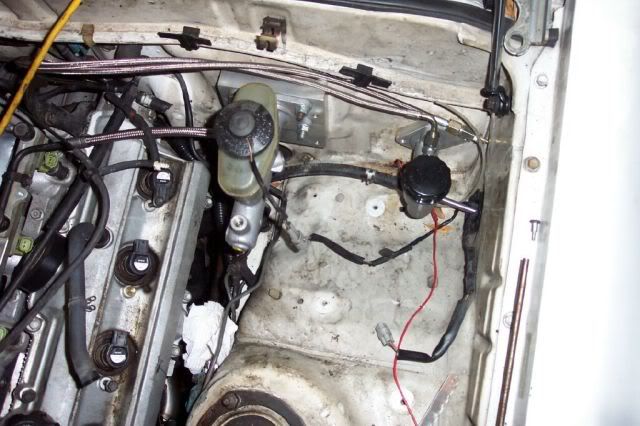

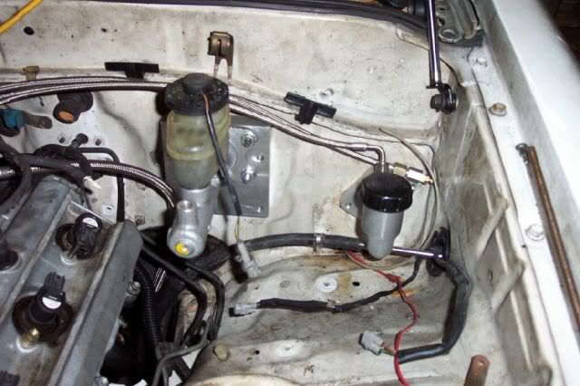

Well like I said before, I didn't get much done today between being tired, watching some football and having it raining here most of the day just made for a lazy day.
Here are the pics of the Manual brake setup and the adapter for the clutch master cylinder.
Brake pedal hager out to make mods to change the pedal ratio to a more manual brake friendly ratio.
Mocked up and ready to go back in.
Stuff installed.
Another of the stuff installed.
Still haven't made up my mine whether or not I want to take the time to bend up some new metal hard lines to reconnect to the Proportioning valve or run braided SS lines.

Small update....
Just got back from getting a few needed bits and pieces. I decided to go with SS braided lines from the Brake M/C to the Proportioning valve so I got those and had a P/S Pressure hose made. About to fit that stuff and get started on the rest of the exhaust....
Wiisass
I wouldn't use braided line for the brake system until you get to the wheels. If you need it for a weird section that you can't bend a hardline around, then I guess it could work. But I would still recommend a hardline from the master up to the inside of the fender, then braided lines from the inside of the fender to the wheel. Braided line will flex under pressure and it will be very apparent if you try and use it all the way from the master to the calipers.
