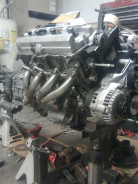

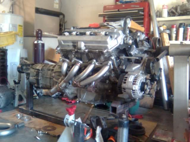

Time for some updates,

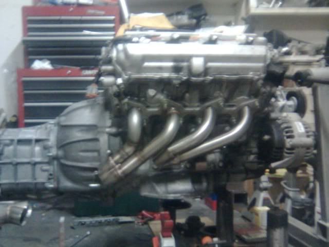

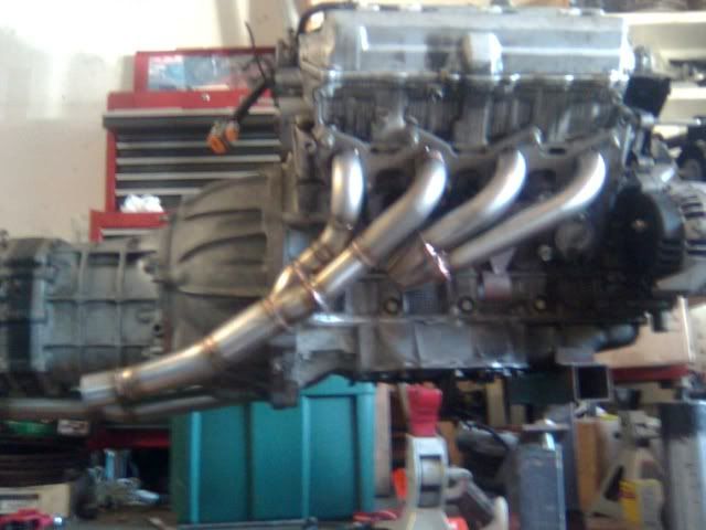

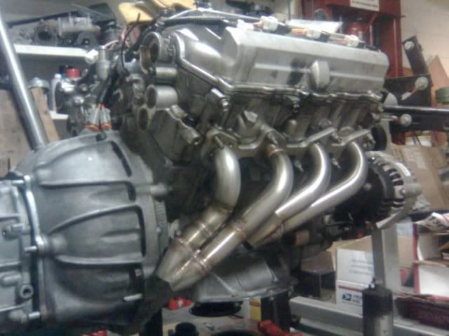

The drivers side header is complete and the passanger side is about half way complete and will be finished tomorrow.
Here are some photo's
Completed Drivers side (Left)
Particially completed Passanger side (Right)

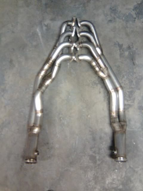

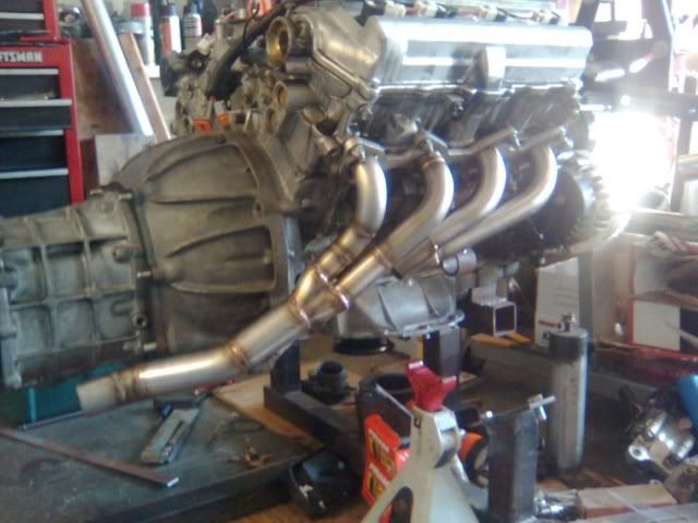

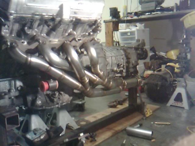

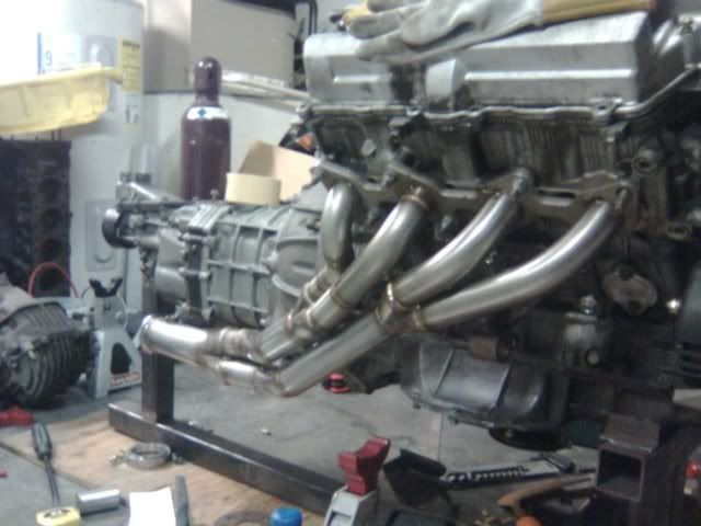

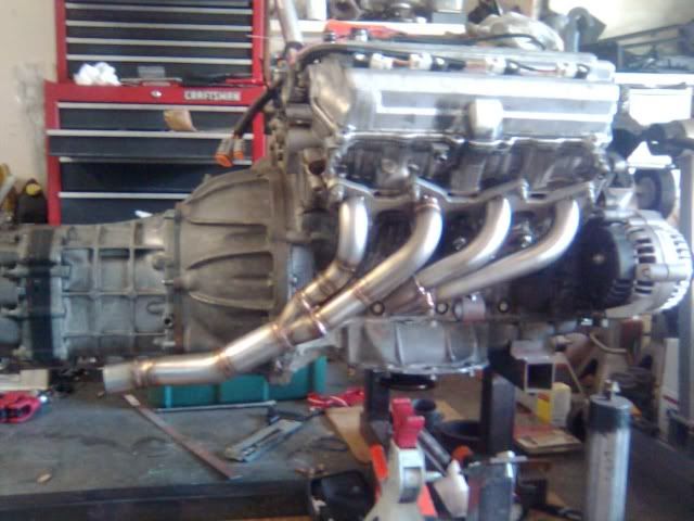

Well the headers for the swap are now finished.
Here are some pics of the passanger (right) side in progression and completion as of this evening...

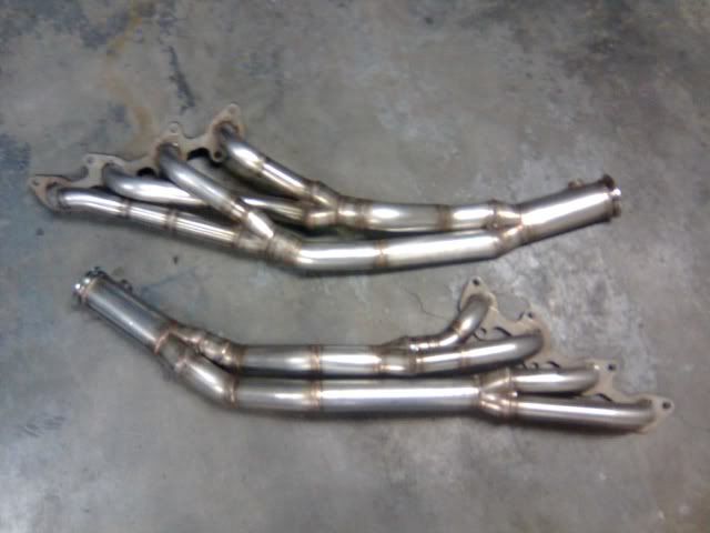

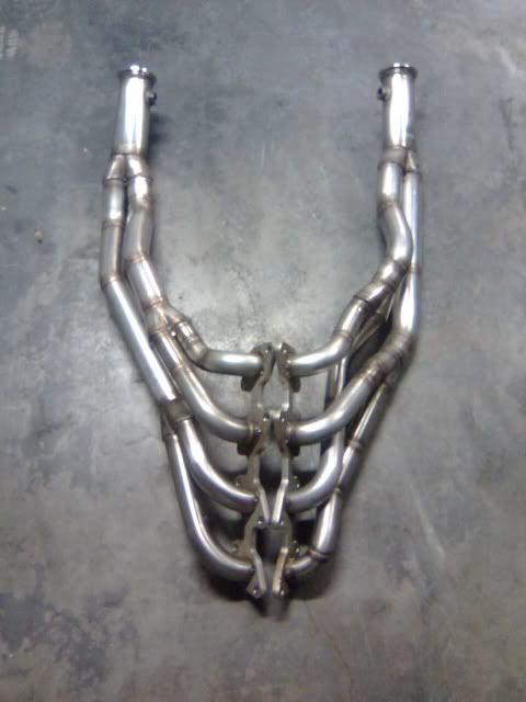

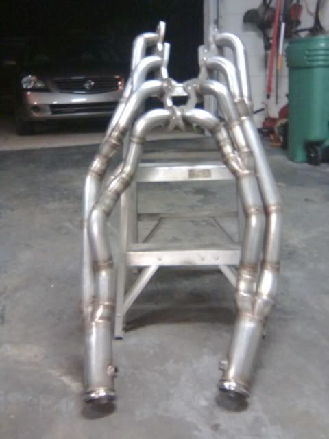

Here's a few shots of the two headers (left and right).
Now that the headers are done, its pretty much time to start yanking out the worn out / limping around 7M to make room for the UZ.
Now here is the part that Im sure some are going to flame me for or what not but although this might seem backwards or what not, alone with the actuall swap, I am going to be converting the car to manual brakes.... Yes, I did say manual brakes.. No more power booster.
The initial conversion to manual brakes is still going to be using the stock master cylinder. The reason behind it is cause I am working on a dual master cylinder conversion that would have a ballance bar and all just like a race dual master cylinder pedal assembly except that it will use the stock pedal. The pedal wil be modified to change the pedal ratio but this is just a simple drilled hole. The conversion and modification does not hinder the ability to go back to stock power brakes if I so choose to do so.
Any question, feel free to ask... Flame away too if you'd like...

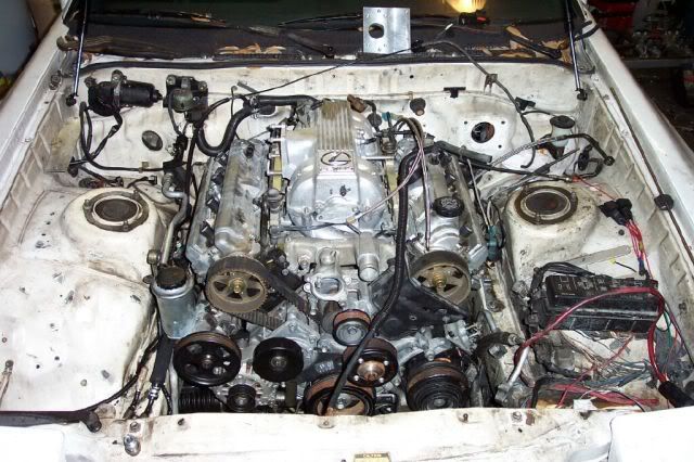

Hey gang, a bit of a small update. The engine is in the car. I'll get some pics uploaded later on this eve after I finish up for the night and get cleaned up......
One thing to note is that to my amazement, then headers do not hit the floor/ firwall area like I was afraid they would so Im prett happy about that and that I dont have to hammer in that area....

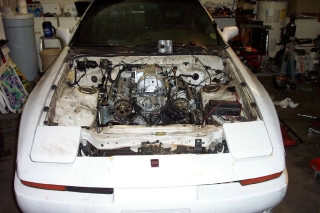

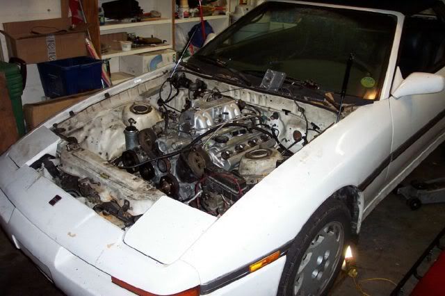

As promised, a few pics now that the engine is in. I just wish that I had a bit more time to be able to clean the engine bay more and paint it cause it looks like total shit...
Engine about to go in.
Engine in....
