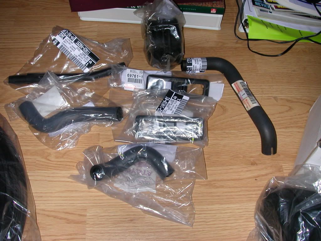

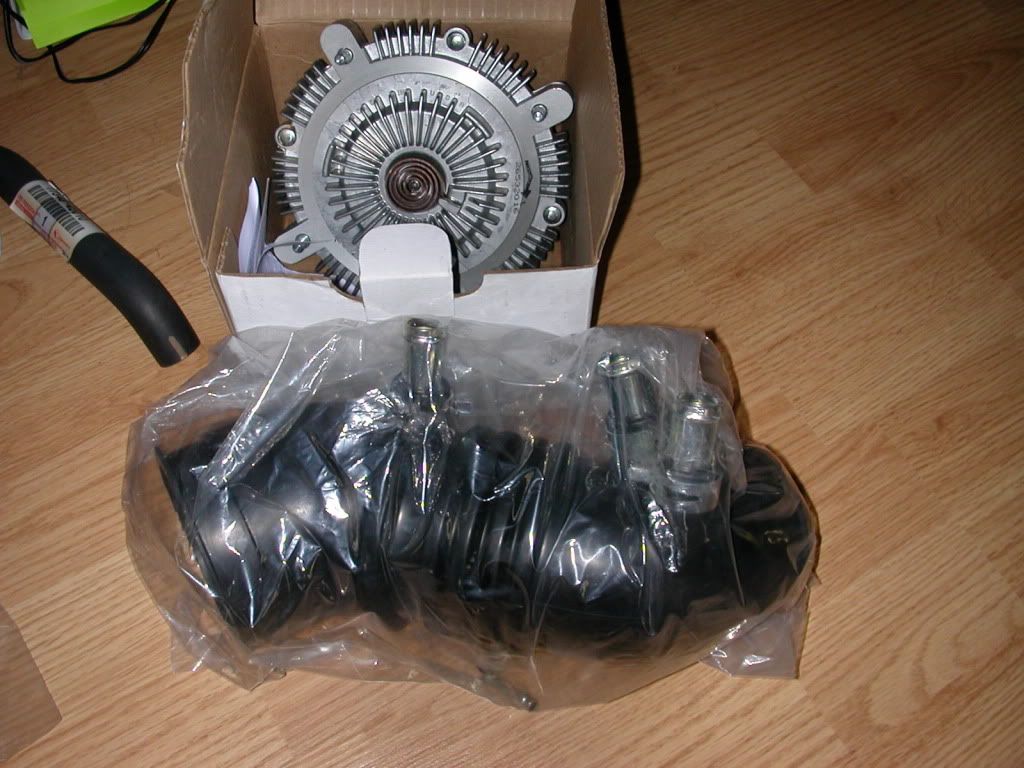

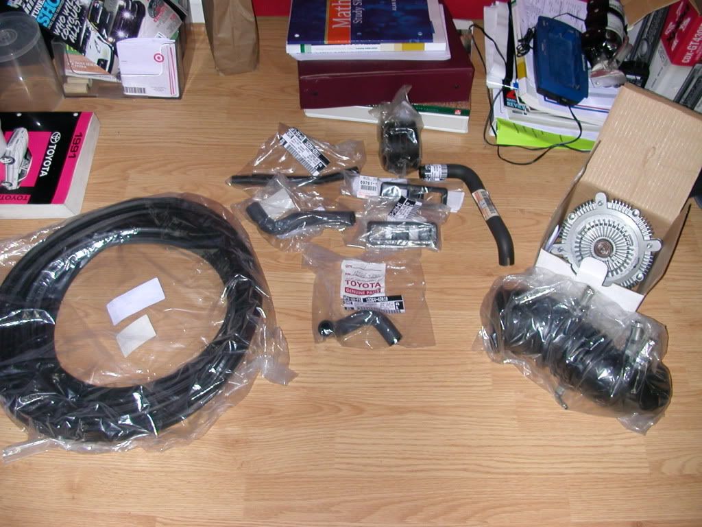

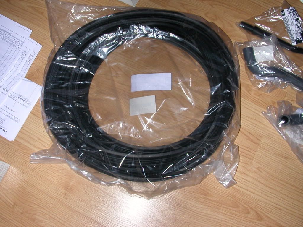

well i cleared the codes and ran the car around the block check engine light came on pulled it back in the garage and checked the codes without the AC button pressed and the car in park. still got 51 i am putting a new blower resister in it and i am sposed to get my knock sensor rewire kit this week hope that gets rid of 52. sorry it took so long to post i had a severe allergic attack on Tuesday and couldn't breath so Ive been in the hospital but i got home and found this on my bed :evil2:
