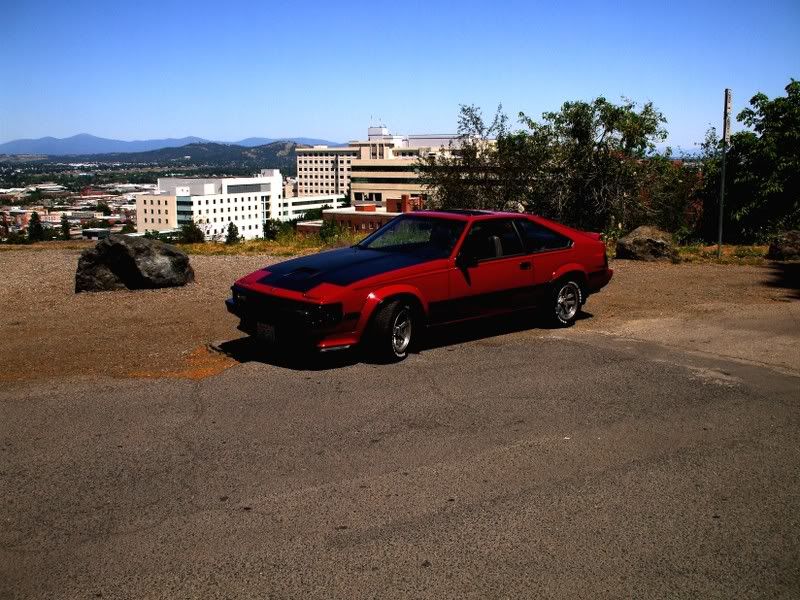

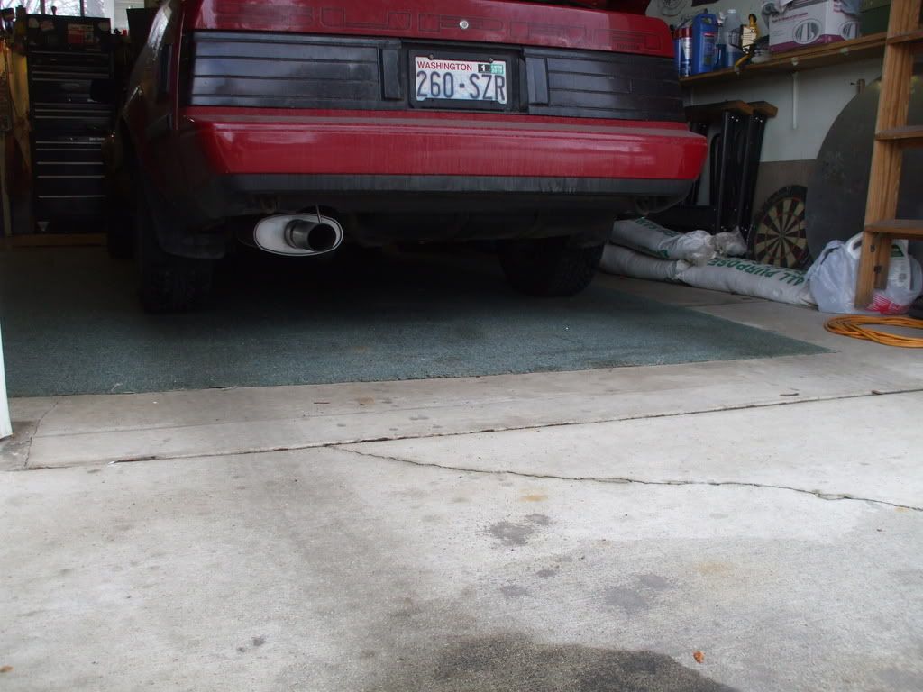

Little background behind this.

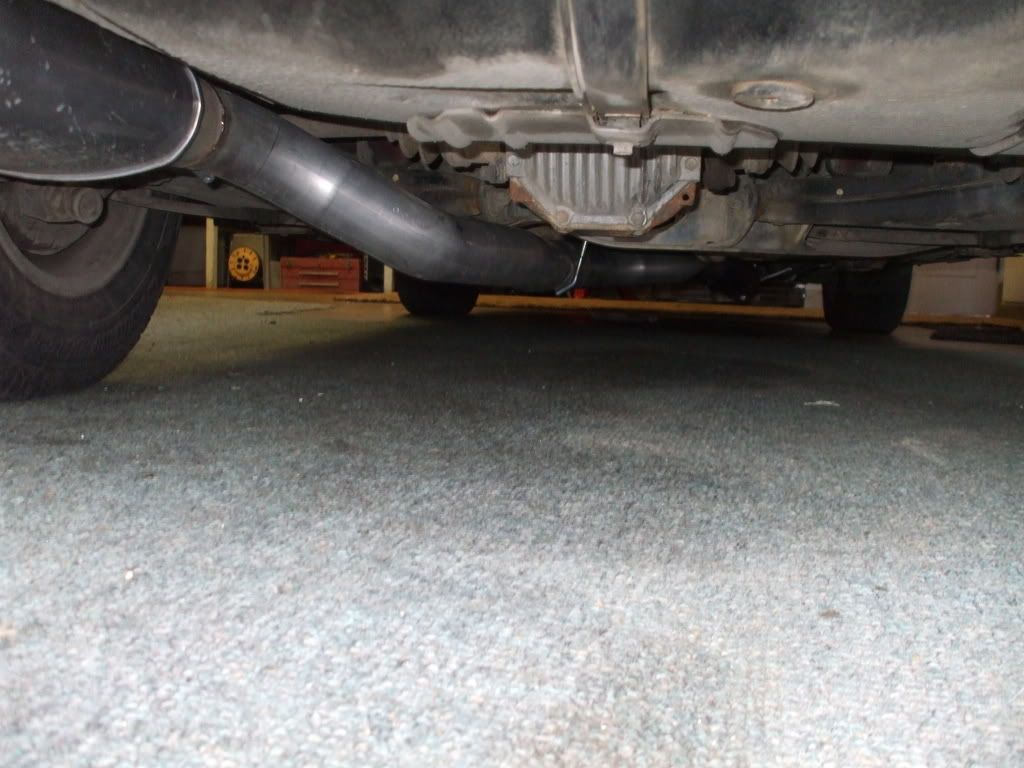

Bought the car for $900, the guy assumed cause he snapped the timing belt that he did valve damage, tho everything was absolutely freakin filthy, I could tell that it was all in mostly good shape, especially the 25 year old leather. Stock motor 150k. Full 2.5 inch exhaust on it. Towed it home, replaced the timing belt and ran till I pulled it for the turbo build.
Pictures of the pick up:::

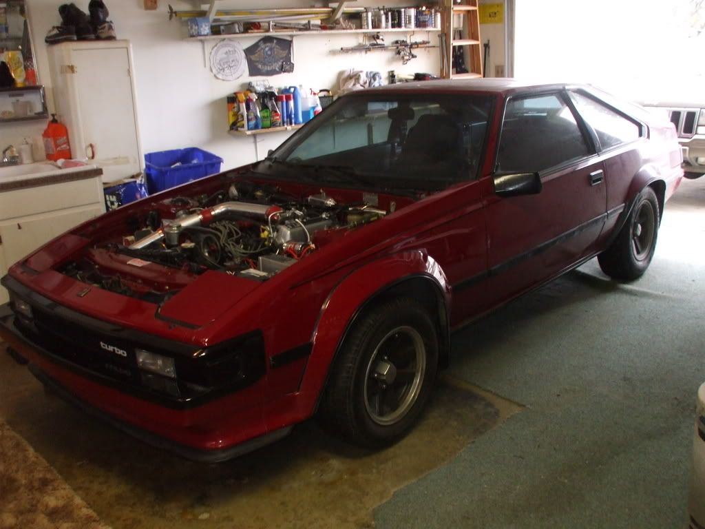

here was the car when i went to pick it up.
Then I got it all cleaned up and did some work under the hood aswell (still NA, this is how it was for about 8 months)

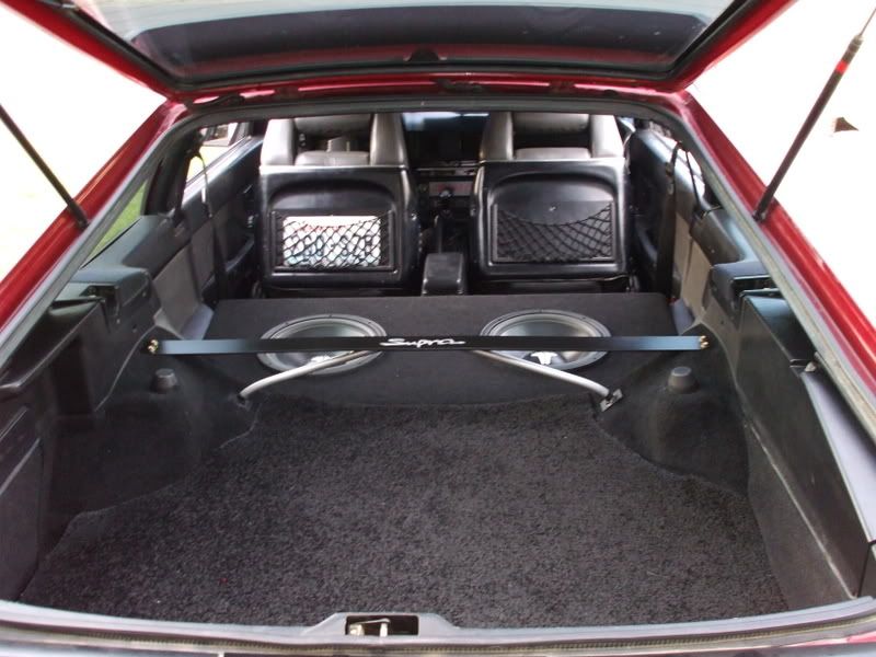

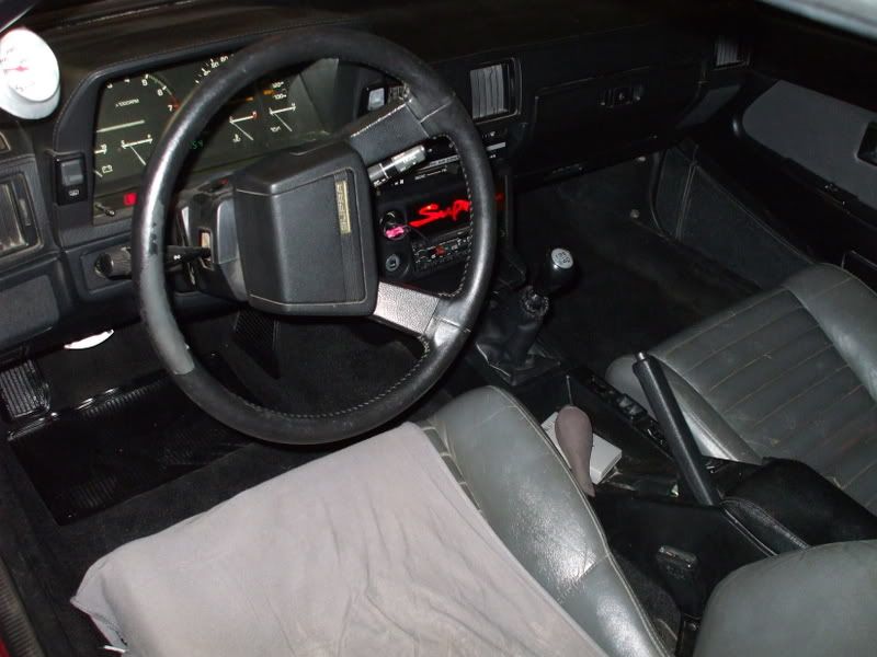

Then I did some stereo work and got my subs in and the rear seats out.
Then I dyed the carpet.
before
after

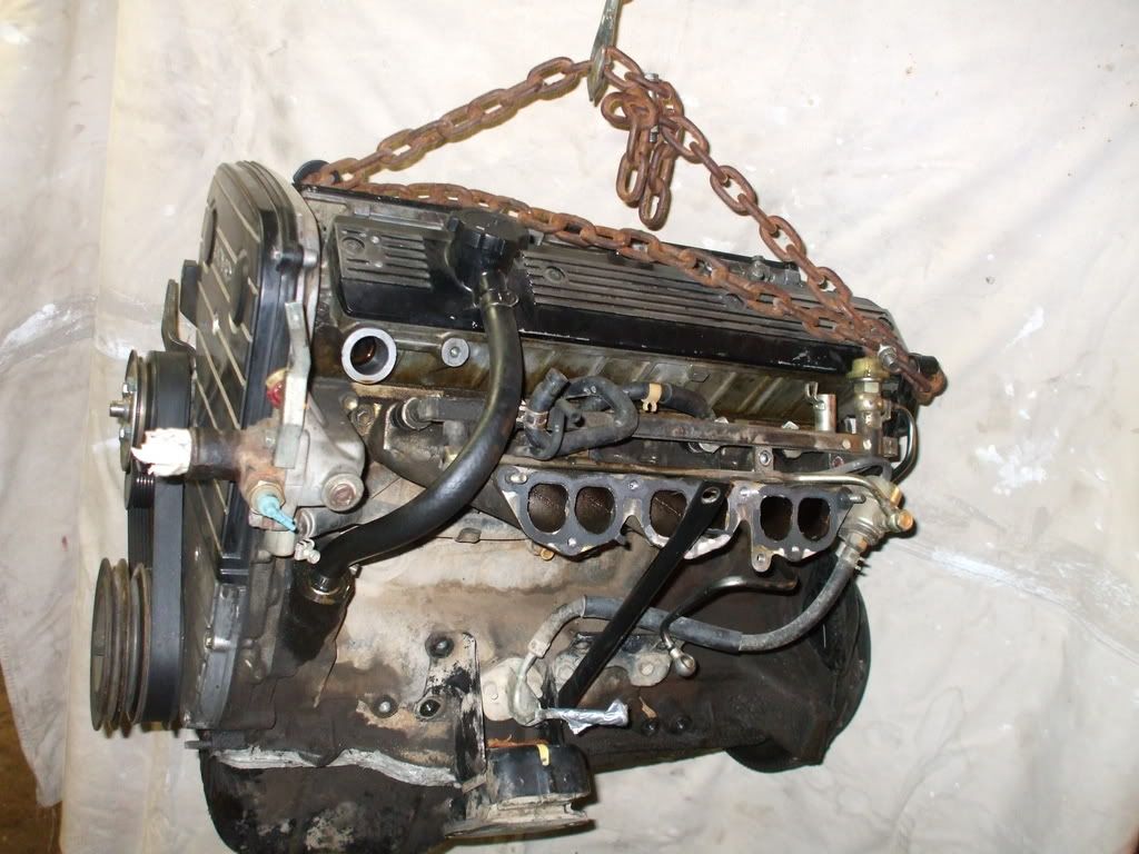

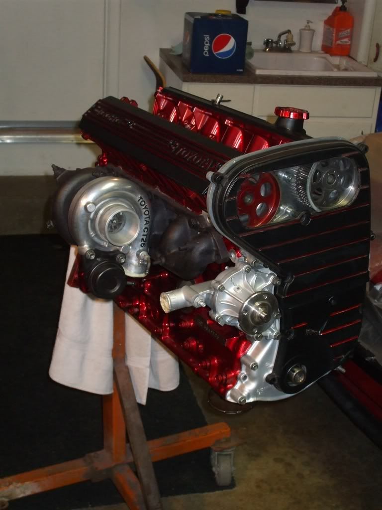

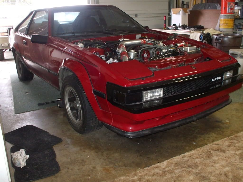

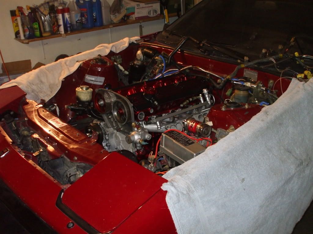

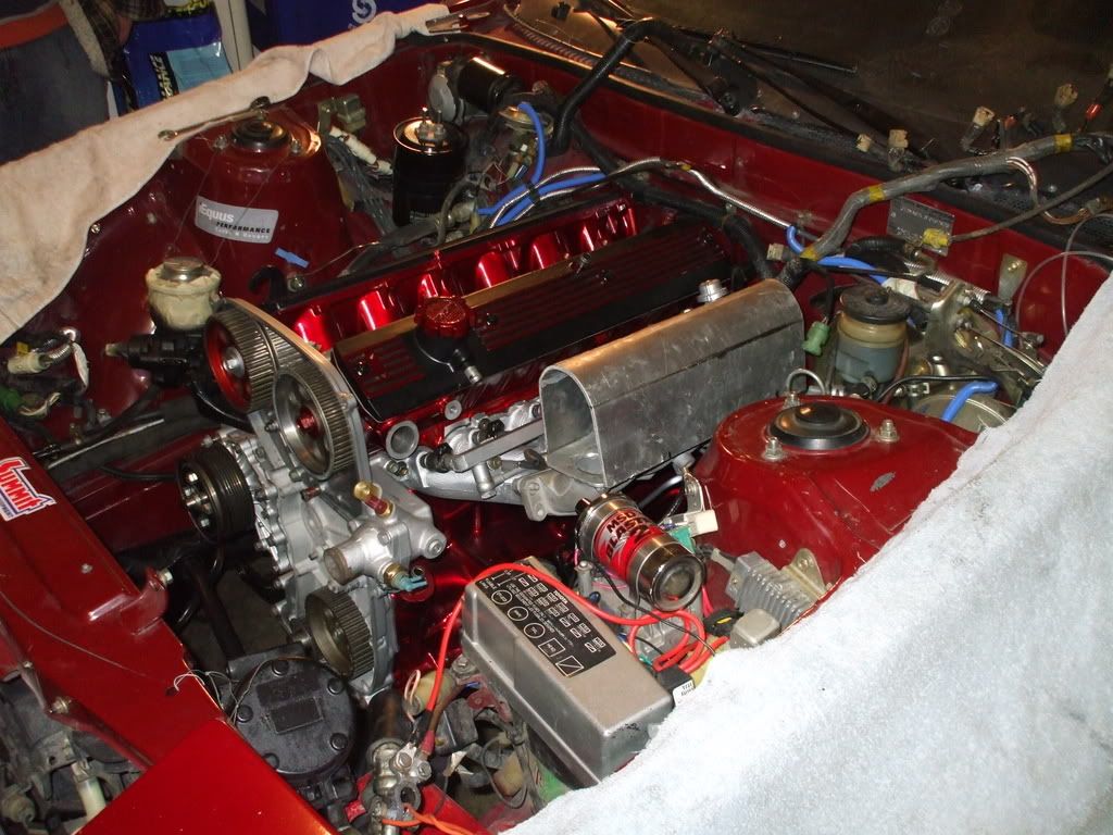

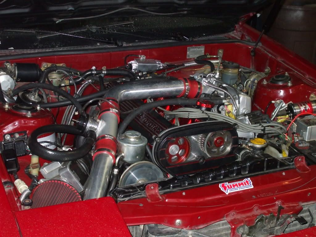

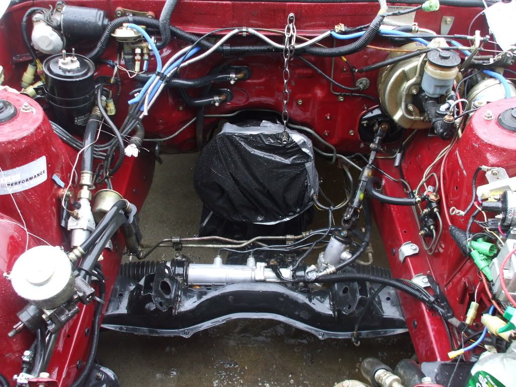

now for the motor build....

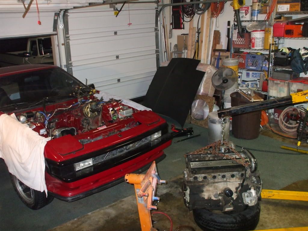

old engine

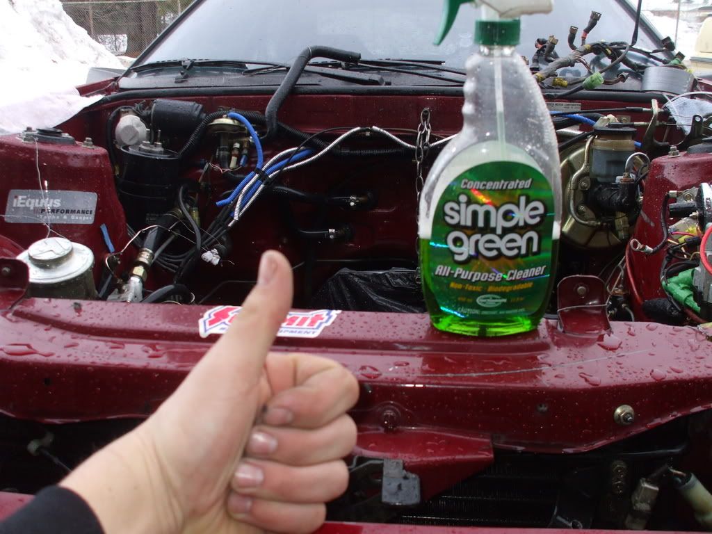

nasty engine bay
clean
simple green for the win
Painting some shit
Parting ways

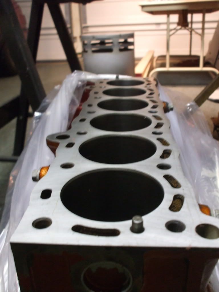

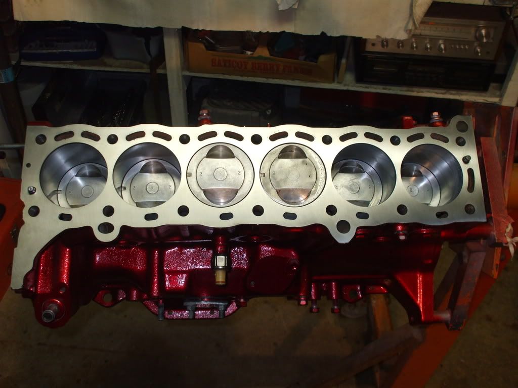

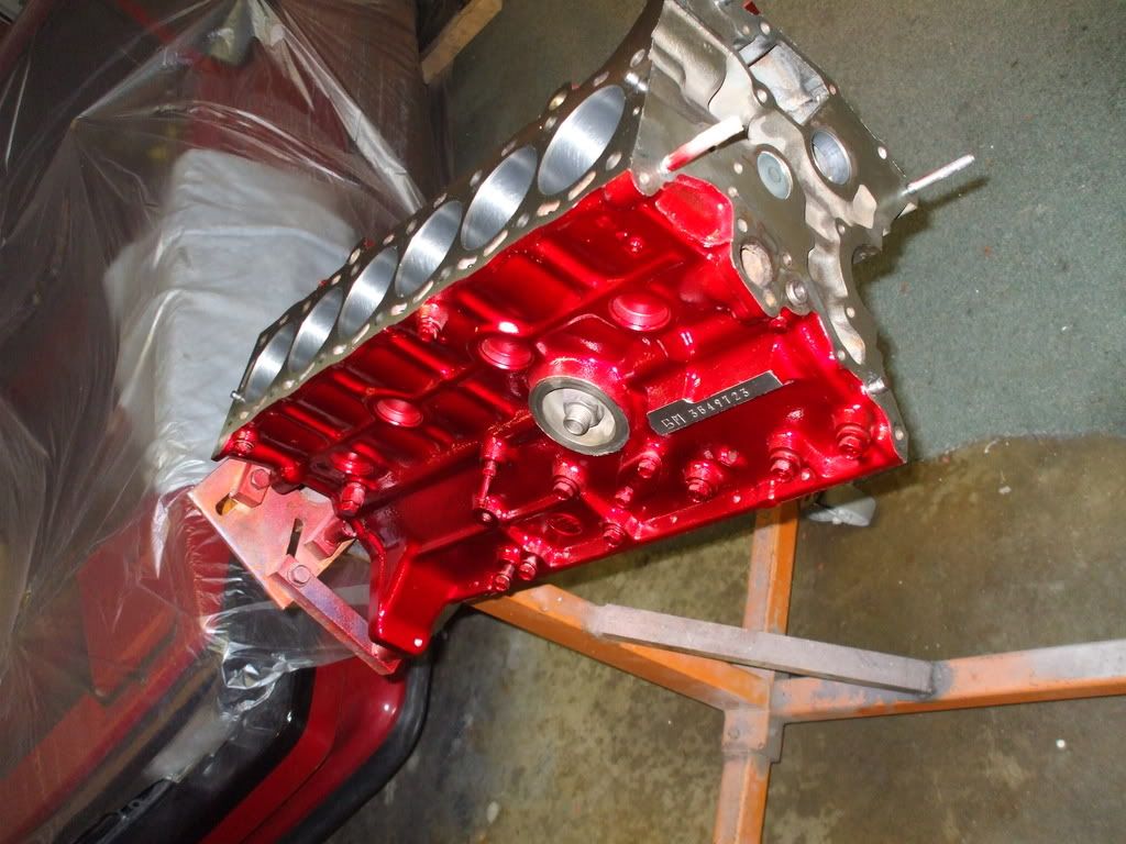

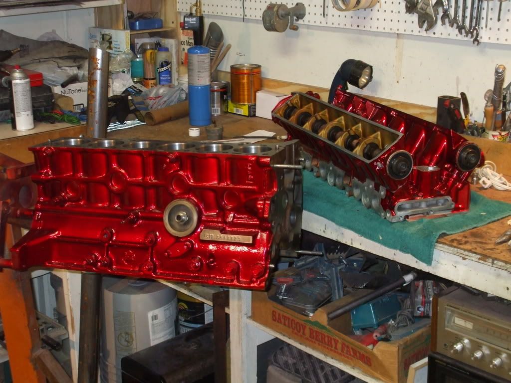

I get it back, and the assembly begins:
1.4mm MHG
1982 5mge low compression pistons
New Rings
New main, and rod bearings
Knock sensor installed (84 block)
Fuel restrictor (J-tube) deleted because RRFPR is added (there will be plenty of back pressure)
Pics:
Fresh Block
Yay for sexy paint::
Coming Together:
Doin Work

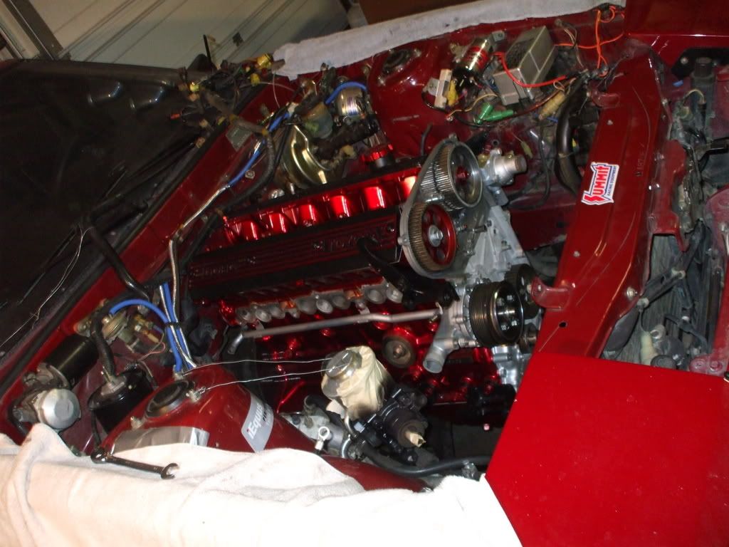

What will be put down into the engine bay: (more bling to come when its in)

thank and more pics will come as I get more done on it. Like my custom FFIM I am making.
