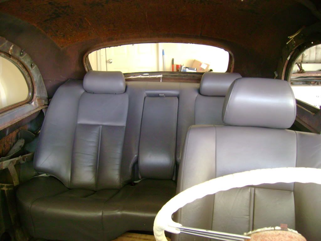

Pictures as promised:

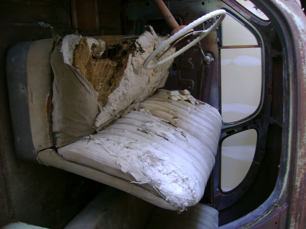

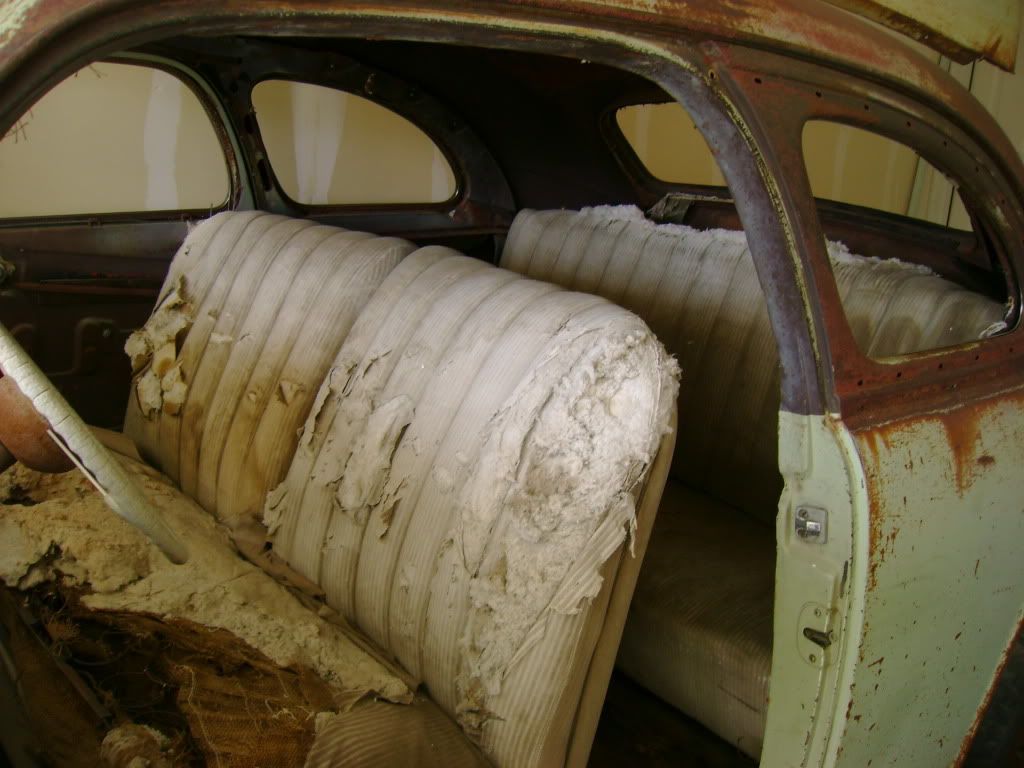

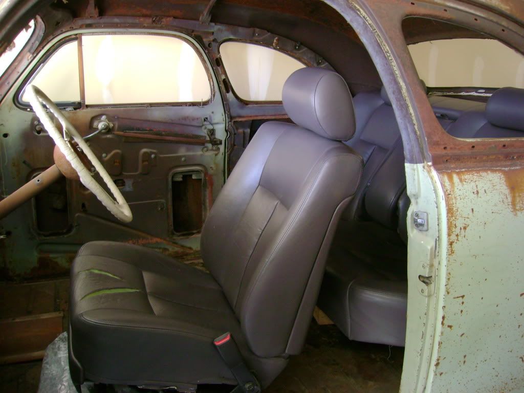

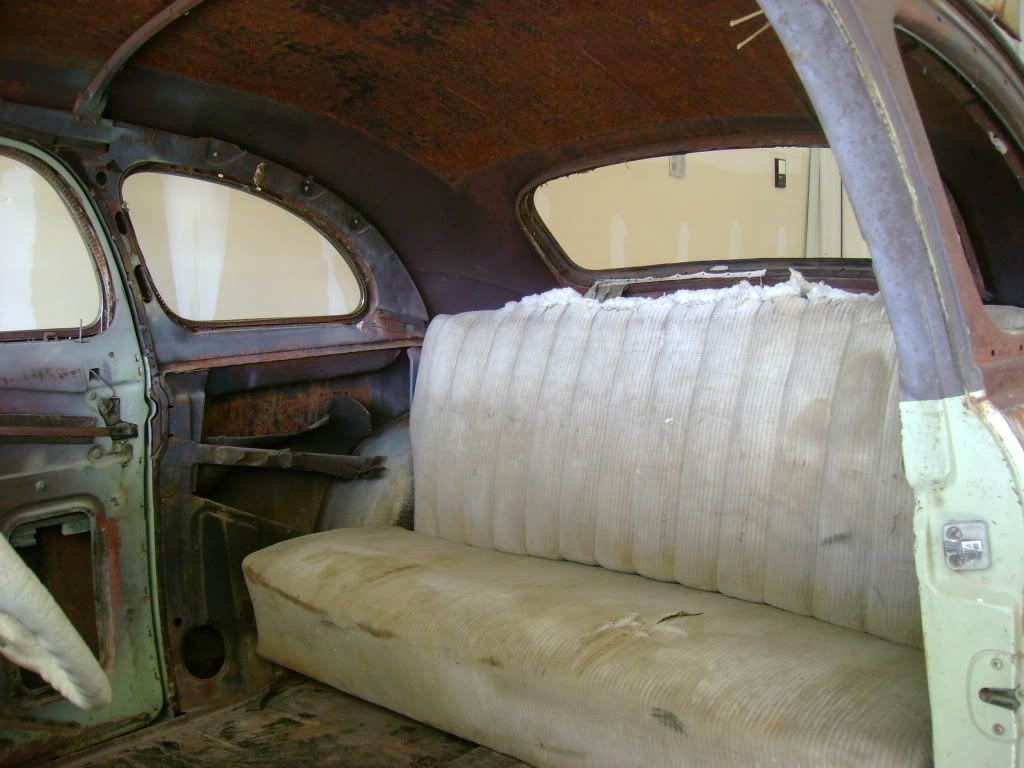

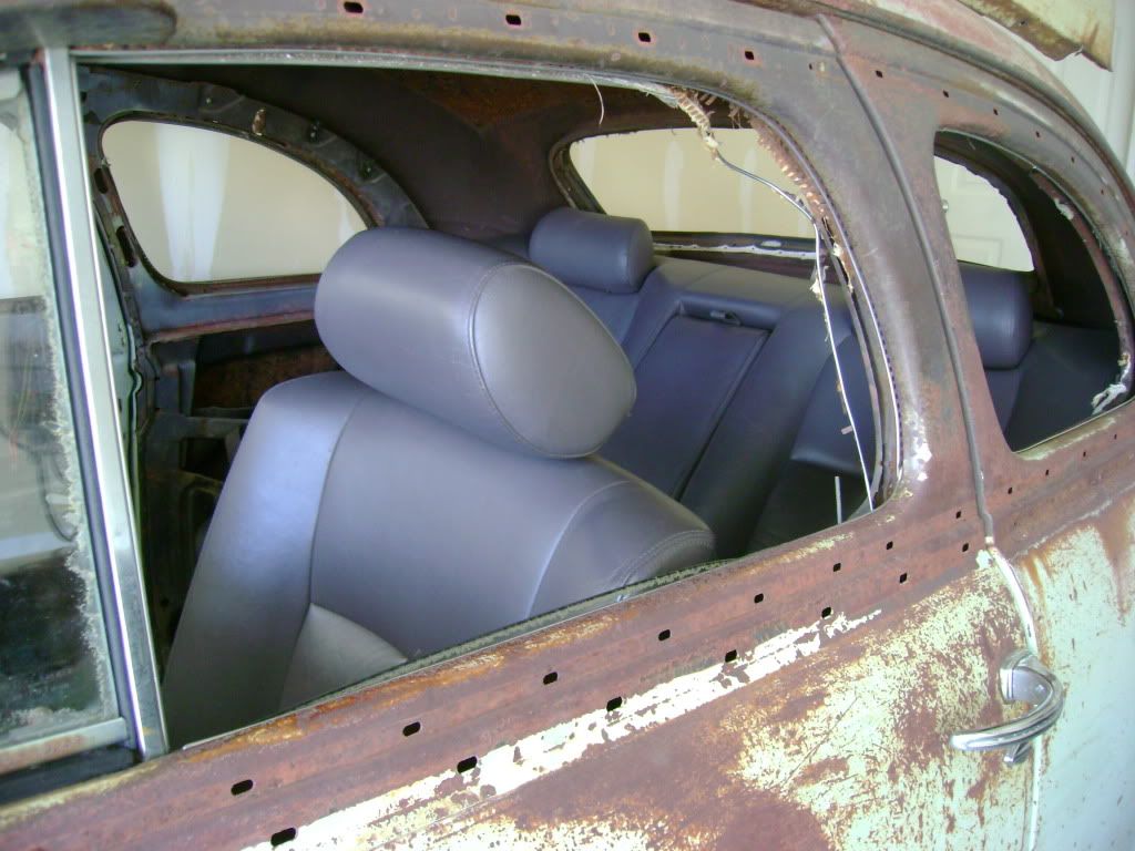

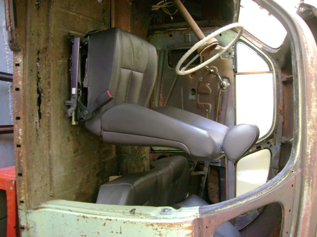

Couple things about the interior:
-Yes, I have the original interior. Yes, it could be restored. Yes, it would be fairly comfortable, however...
-You sit even higher up (I'm not tall, as mentioned), and your head will hit the roof if you're sitting in the rear and the car hits a bump. Also, I would have to drive with my legs bent like that tall guy on that episode of The Simpsons where Nelson makes fun of the tall guy in the little car. Stupid non-adjustable seats... oh, and...
-The LS400 stuff fits quite nicely. I'm thinking even the console might be able to be adapted easily enough, which would be awesome since it has air conditioning ducting inside it for the rear passengers. :)
-We're most likely keeping the stock dash, since it is metal, and in decent enough shape. However, I like the Lexus gauges, and honestly, I think they can be adapted to the stock dash without *too* much trouble, and would look really cool since they black out when not in use.

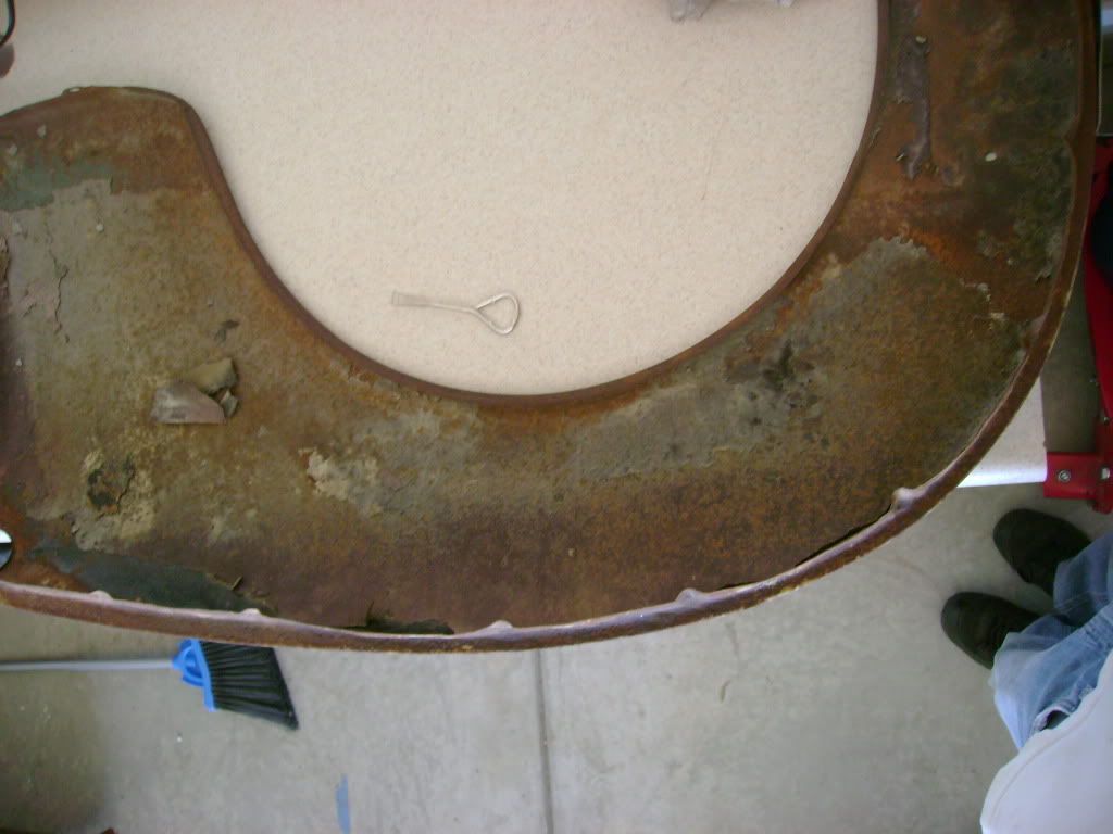

Scraped out the anti-rust coating that was on the inside of the rear fenders. Was not fun:
Don't think I took any other pictures, but they cleaned up nicely. Just gotta pound out a few dents , sand, and fix a hole or two and they're ready for primer.

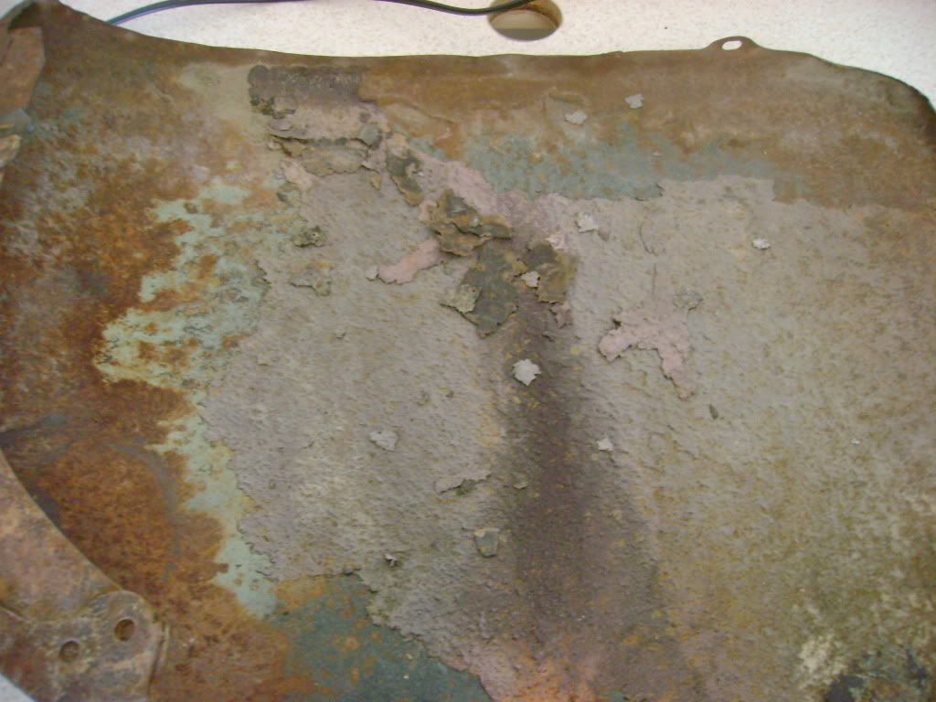

6,622
That's a panel that is pretty much trashed anyway. You can't really see it in the picture, but the metal is so thin that welding on it is out of the question, so we're going to try finding a replacement anyway.

I have no reason to doubt you there sir. Mind my asking where the harm is? I am pretty good about cleaning stuff up and tearing things apart. Making them look pretty has never really been my specialty though... Will a couple coats of primer and a few coats of paint not be enough to cover any imperfections I have caused?
Also, the pictures make it look pretty bad, I'll admit. However, the "touch" test is telling me the metal is pretty smooth still. The only areas that are still pretty rough are where either rust pitted the steel, or where I can only assume the body panels were welded together. That diagonal line between the side window and where the trunk/rear fender area meet is pretty bad, I must admit.
