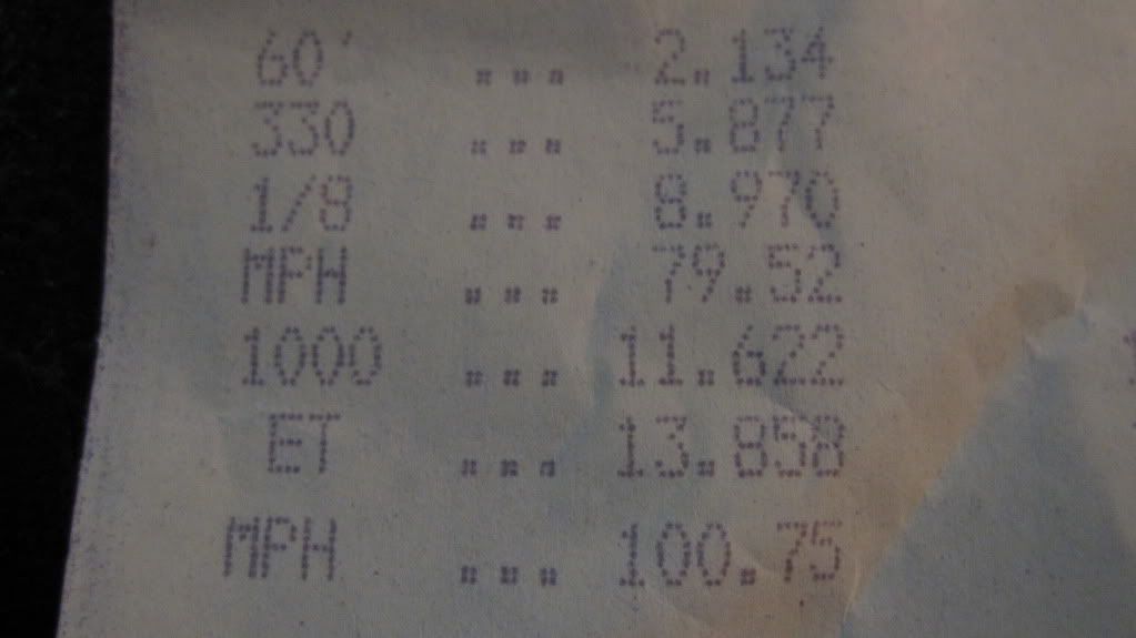

Just got back from Street wars Wednesday night drags, Took a few runs to get dialed in but finally was able to get a 13.885 @ 100.75 MPH with a 2.134 60 ft
Mods:
Original 88 7MGE 140,660 miles
CT 26 Turbo 9 PSI
Drift motion Front mount intercooler and 2.5 inch piping
Drift motion NA-T turbo oil line kit
2.5 Inch Exhaust with Catalytic converter
AFR's iin the mid 10's under full boost
Automatic
Stock Sawblades with falken zeix 225/50R 16 on the rear
I think it was a good run, Full interior and full size spare was in car at the time too.. Now time to get tuned with the Neo and up the boost a little :)

Oh yeah forgot about this.. Here is the slip and video.. Sorry for the crappy video.. My camera is awesome but the digital zoom sucks :(
