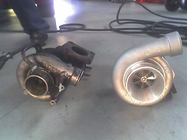

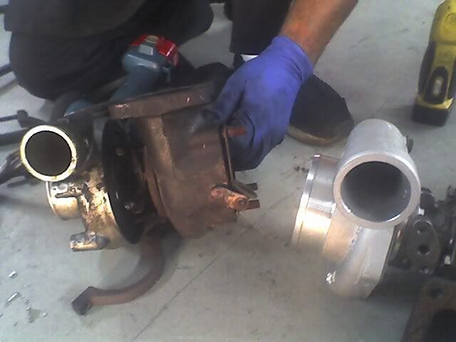

Thanks Suprahero, it's on 93 pump gas on a conservative timing map. The turbo is a T04 60-1, .68 exhaust housing, .70 cold side. Here's a couple of pics of the turbo next to the ct26
