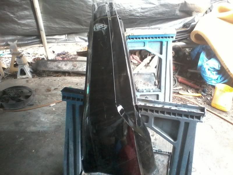

I have been working on the replacement door for the drivers side, I took the crash beams out of both doors as well, its good for about 40 lbs and since I have plans for a roll bar in the future anyways then they wont be necessary, first you need to drill the spot welds out that are holding them in
Better get out your impact chisel for this one....
Then you need to make two cuts for the beam to fit and slide out
You need to cut the beam to make it managable and move inside the door to slide out
Another plus to this is I can pull this dent without a uni spotter once its out

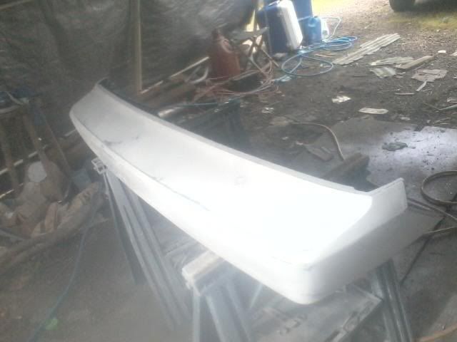

Well I got some paint down this weekend
Well other than the bumpers and the remaining flares that I need, the car is all painted.

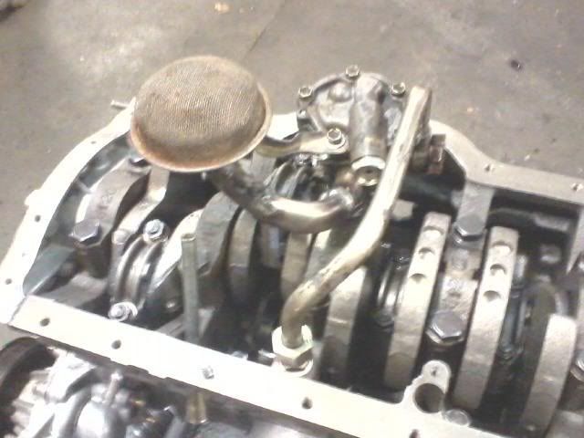

I started on the 7m reassembly finally... cut the oil pump pickup and re welded it

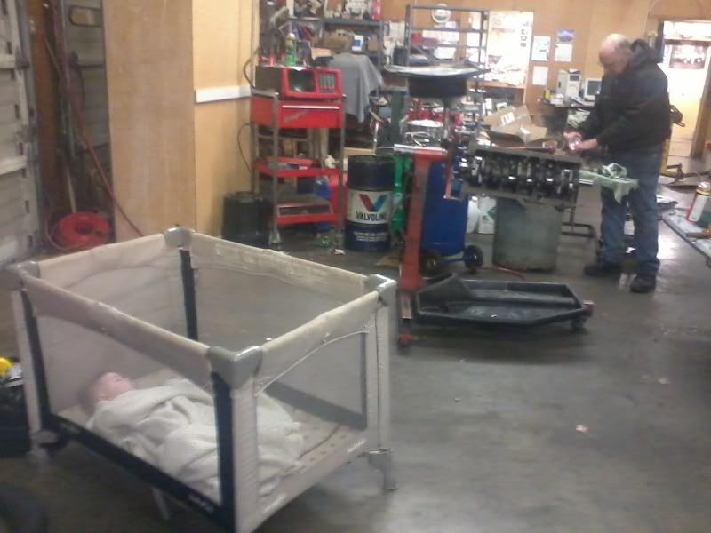

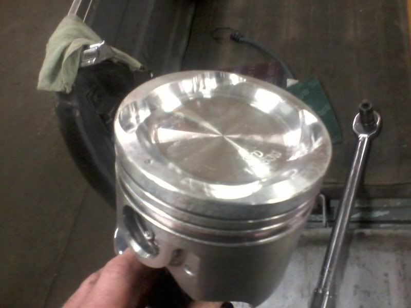

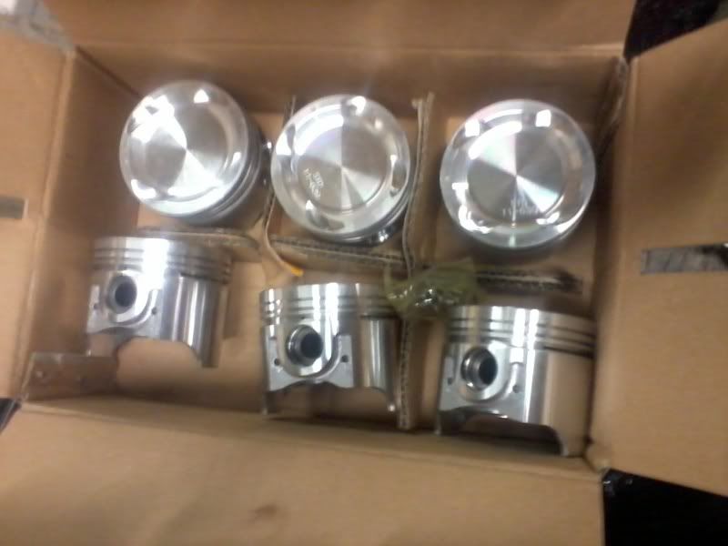

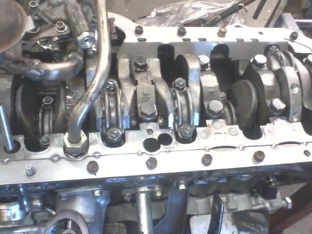

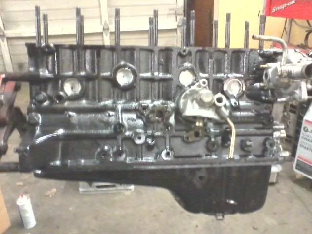

So with the huge help from my dad I was able to get a short block together last night. The pistons showed evidence of scraping on the skirts from lack of oil (before I owned it) So it was decided to get new pistons. Found some real good lookin standard bore ebays from NPR for around $100 with rings.
I even had the kiddo there for support thought about gettin a sitter but hes not even bad while we work =)
So the head studs are in
So everything clearanced out well though, and once my oil pan comes in from another member I will slap that on along with the head. I welded on the stock one to put the return bung in, but getting your welds air tight will prove to be a bitch. I wouldnt say Im a really bad welder... but putting them to the test and having to grind them down after they leak in one place or another thats hard to get to has got me taking the easy route.
I got an 88 cressy oil pan with a return bung, It needed a bit of love... but after an hour between the hot tank, rolock wheel, and ball peen hammer it turned out okay. I hot tanked and painted some parts. Got the oil pump all sorted out, I found a tiny air leak on the weld for the pickup, grinded and rewelded it, bent and drilled the support to work with one of the bolts on the pump, packed it with trans assembly lube (didnt have vaseline) and installed.
Then I painted the block and oil pan, installed the rear main

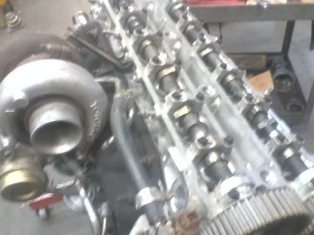

I got the head back from the machine shop after a full valve job, upgraded to an HKS 1.2mm headgasket, got the head back on and torqued again, now I am on the daunting task of adjusting valve lash (yay!)

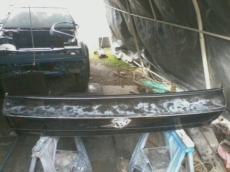

While I was waiting for the machine work I tackled some bodywork

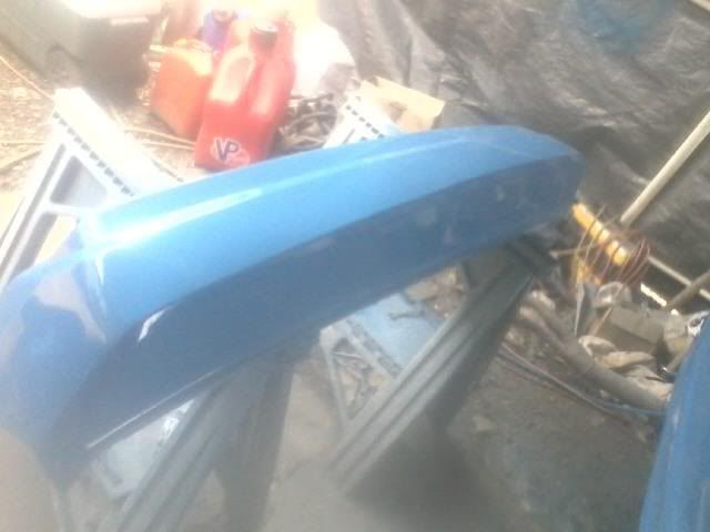

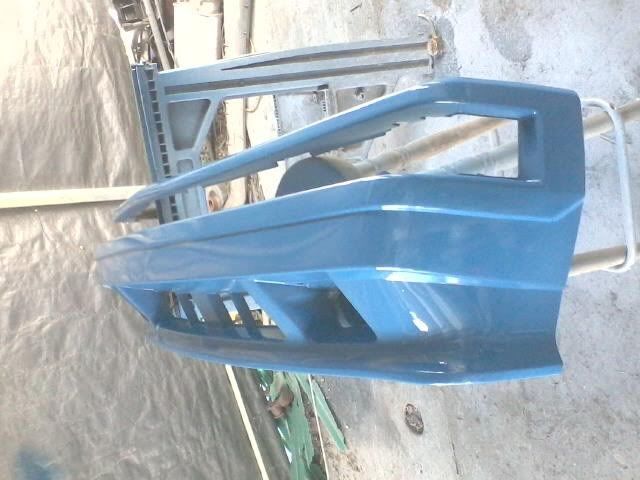

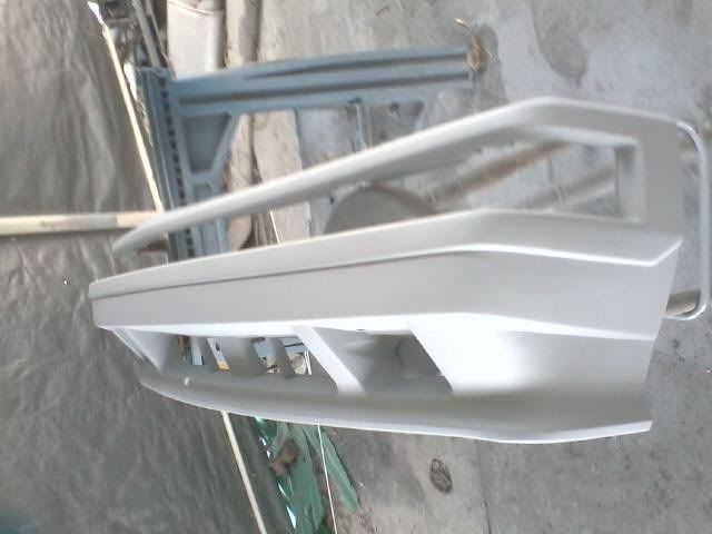

I painted all the plastic parts - bumper, mirrors, headlight bezels, and put them all on. Its coming together and looking more and more like a complete car =)

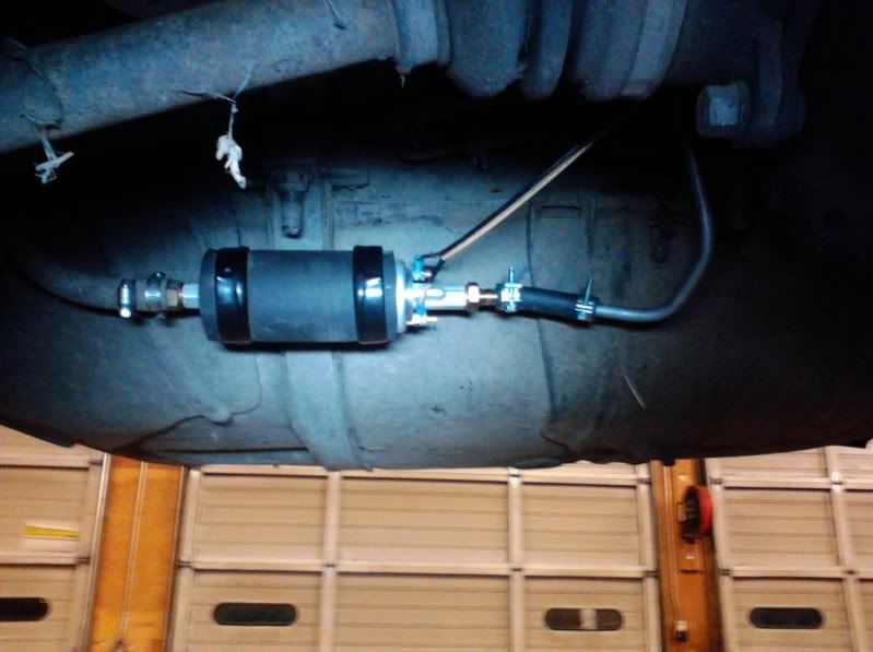

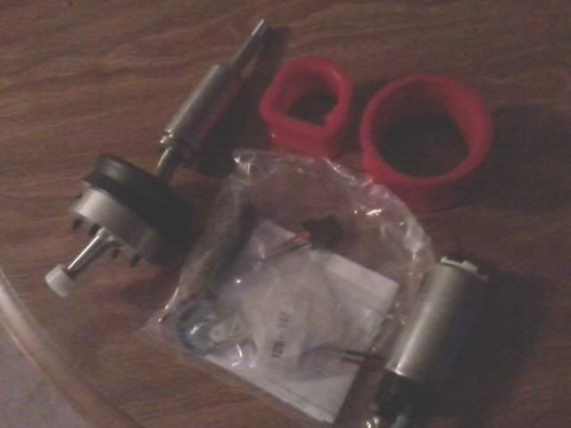

Got a package from raptor racing of poly steering rack bushings, the S3 short shifter, and a fuel pump. It was supposed to be an external one, so its going back, but still looks cool! :)

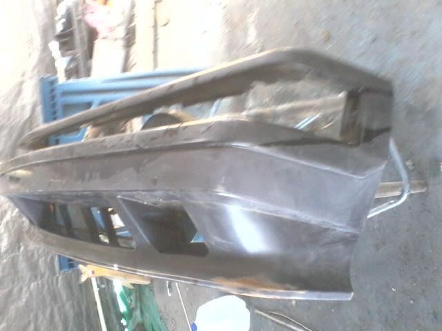

Also got my newer style front bumper from greyhound today, the newer style is a lot better. More lip at the bottom, and different cut outs on the lower part. Thanks mkii maniac!!

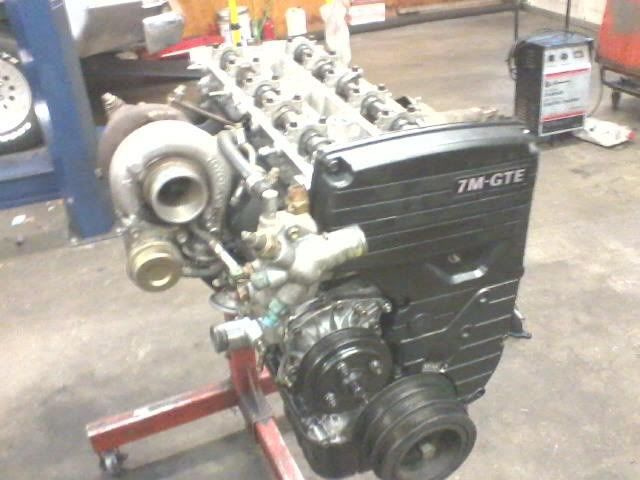

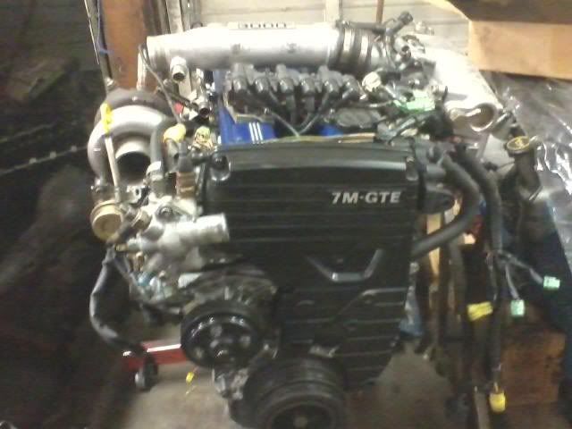

Got all the valves shimmed to specs, cams are in

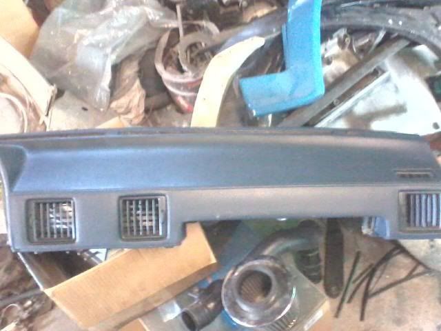

Got a minty dash

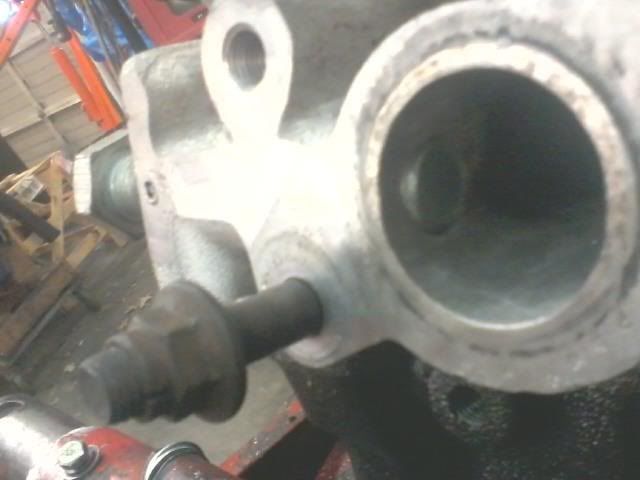

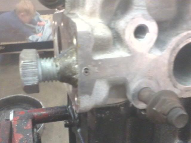

Blocked off the EGR with a bolt, drilled and cotter pinned it, and used this super strong epoxy for extra assurance. They use this stuff underwater to fix holes in ships, and they even use it to repair cylinder heads. Yeah bolt isnt goin anywhere!
Put on the timing belt and timed the engine, cut myself too :)

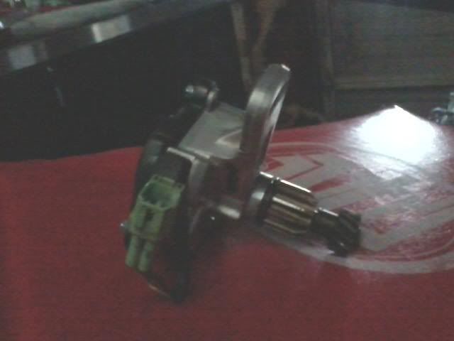

Got some parts! More on the way.... CPS sensor

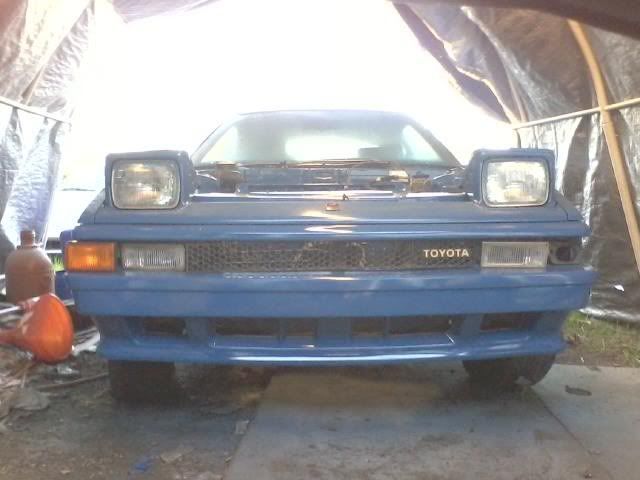

Got the front bumper on
Still waiting on the other side marker, crank scraper, O2 housing, interior parts.... it is definitely coming along though. What do ya guys think, should I have left the normal part of the bumper black? I can always redo it if it doesnt look right but I wanted to try painting all of it

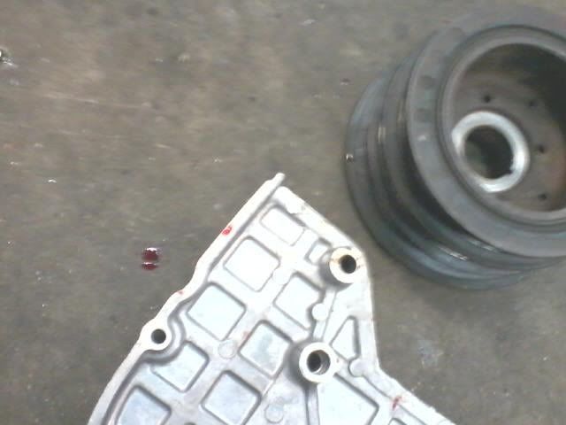

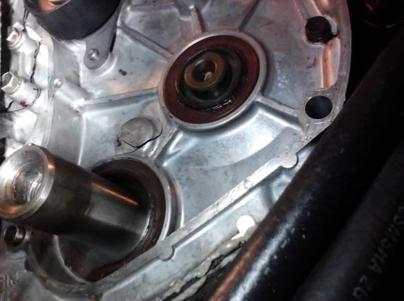

got a crank scraper
I was a little worried about all the trimming involved with this, but it wasnt bad at all. Little bending, marking, grinding, done

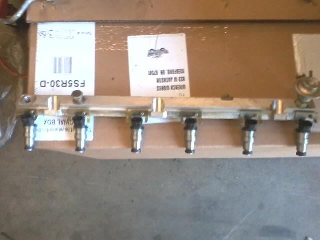

Got my injectors back after a full service

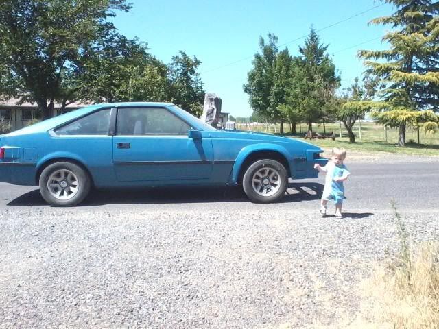

It feels good having this car out of the shelter at the parents house that it drove in about 2 years ago. (yes 2 freakin years) Its coming together and I'm happy!!
here she sits

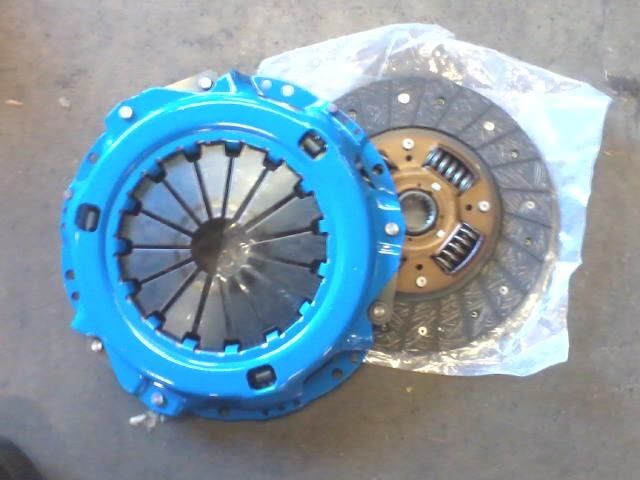

Flywheel resurfaced, New clutch, pilot, and pull out bearings all on

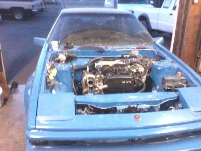

Engine is set in after all the last minute touches and steering rack bushings
Notice the ugly looped heater hoses... I might clean them up later but I just wanted this thing in. Oh and now that the trans is secure I got to put the S3 short shifter on and pretend drive and shift thru gears! The throw on it is pure bliss. Huge difference and although its disgusting that I got a short shifter for my eclipse off ebay for $30, and this one close to $300, its every bit worth it

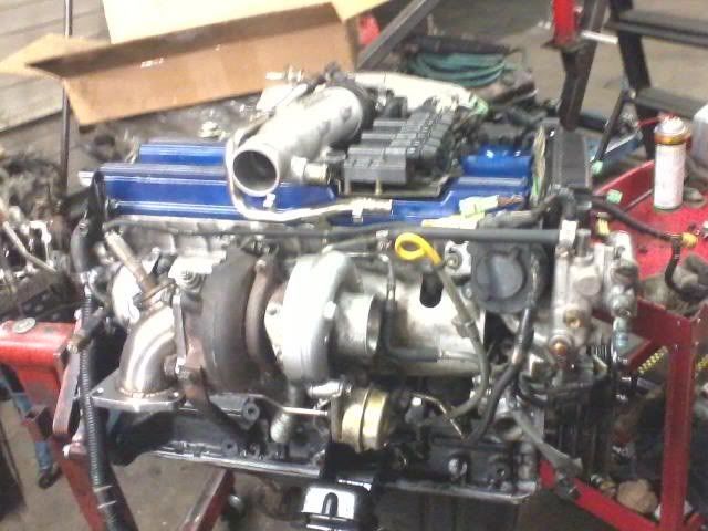

Been doing wiring

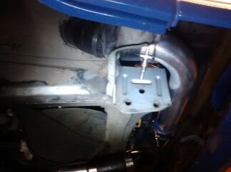

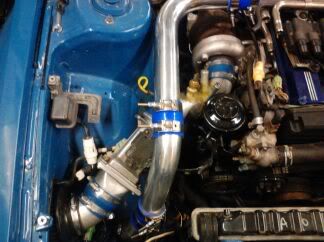

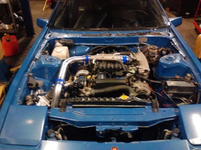

Intercooler piping
Cold Air, Hard turbo inlet pipe, ect
Update.... UPS and DOWNS.... that is the motto of tonight... I have been stuck and frustrated with wiring so I said, "oh how bout Ill put some oil in this thing... well not even half a quart in, and I see drip drip drip.... I was so mad I just left.... I didnt wanna effing know... well here it is
If you use a 12mm head bolt here this is what happens. but the up is I got the wally 255 hooked up

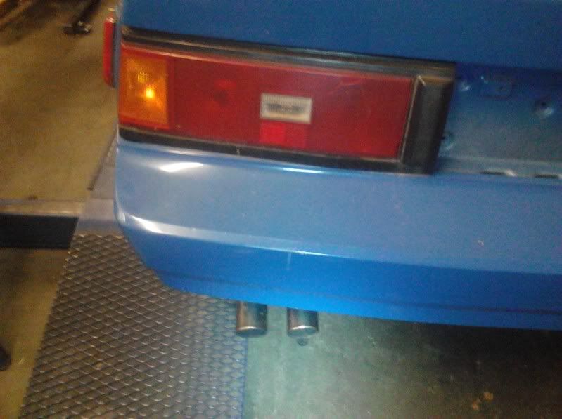

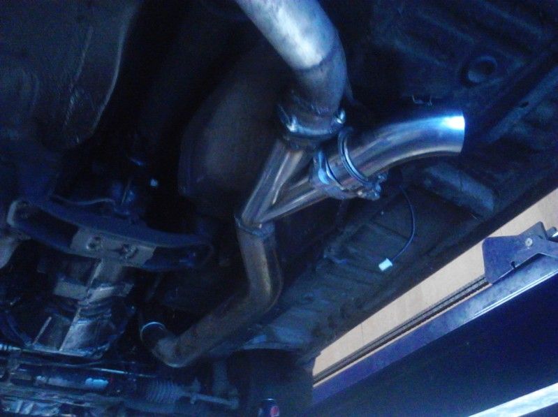

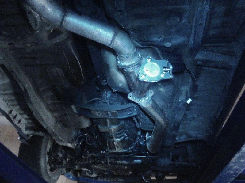

Fabbed the 3 inch exhaust all the way to where the muffler will be, with exhaust cut out!

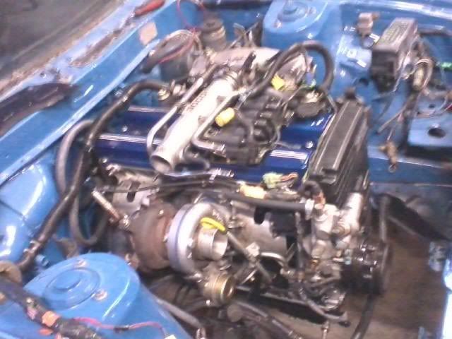

and after a few odds and ends, this is where Im at now... The engines back together, wired up, turns over but no spark, been troubleshooting it forever!! When it runs youll be the first to know lol

after OVER A MONTH of troubleshooting and getting rid of gremlin after gremlin, (why is it not more public that the black wire at the fuel pump is POSITIVE? lol) SHE RUNS! HASNT RAN IN OVER THREE YEARS, AND SHE SOUNDS GREEEEAT, EVERYTHING SEEMS TO WORK NICE, Tach works with the adapter, oil pressure light/charge light go off, oil pressure looks great at 50 psi cold idle, no leaks, Im ecstatic. Hoping to take her for a spin tomorrow if Im lucky

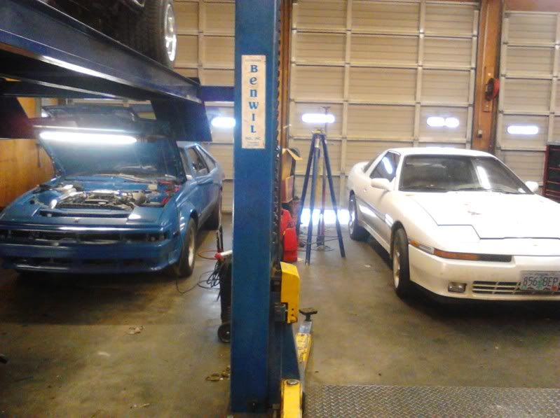

My car next to a running 7m for reference

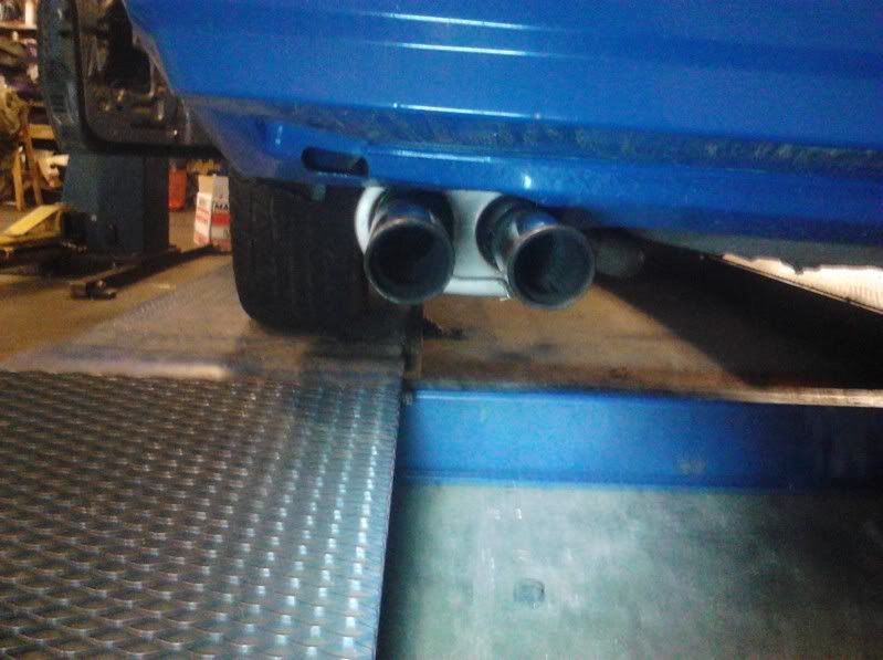

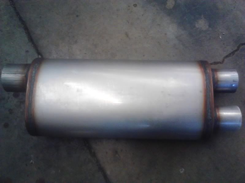

This is the muffler Im doin... hard to see but its 3" in, dual 2.5 out. figured a dual chrome tip might look really stock and sleeper, and after hearing how quiet an open 3" 7m is I know this will be nice and mellow... until I flip the switch for my dump of course lol
