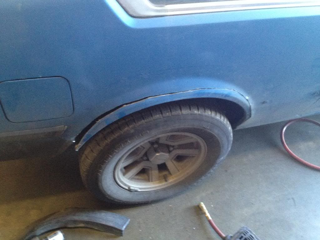

Wheel Flares
$100

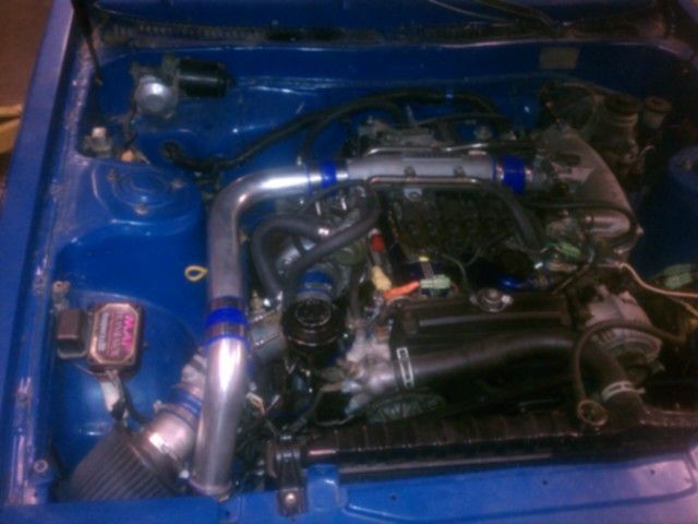

PS- Do you have a closeup pic of your turbo elbow installed?
mk2 supra
Nov 28, 2009
106
Oregon
supraguy@aol;1902808 said:
Don't feel bad- you have a running, painted car.
I've spent more than that already on suspension and engine parts alone, and it doesn't run, isn't painted yet, and still needs the interior done.
Thanks that helps... Its nuts how much it really takes to have a nice car your way isnt it? I dont even wanna think what it would take if I wasnt doing this shit myself and instead $65/hr shop rate.

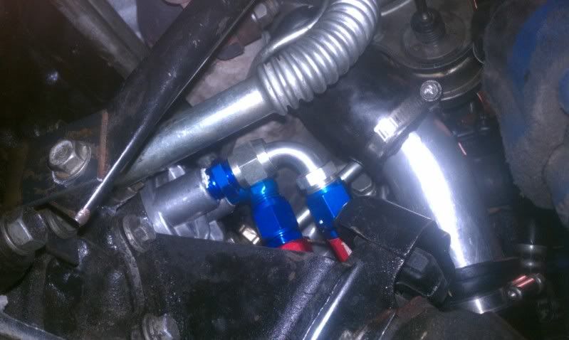

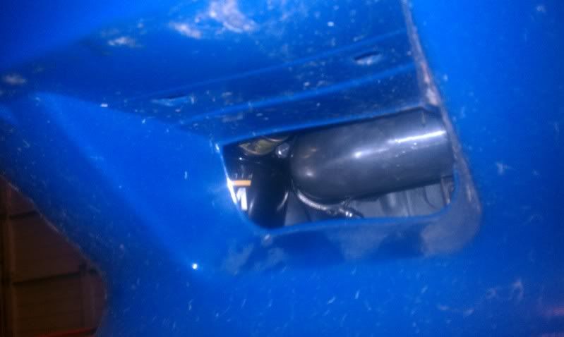

No I cant say that I do... Its 2 pieces of 3" mendrel pipe, and it had to be the tight radius bends, and then all the bungs from the stock one. If I could do it again Id use a PS resivor from a NA car so I wouldnt have such a tight space to work with

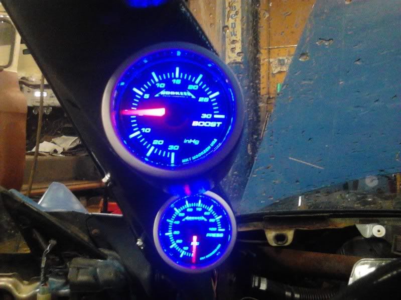

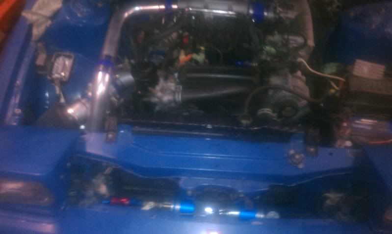

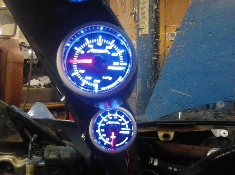

Got a ton done today. Wired up a cooling fan with a relay and lighted switch
hooked up a boost gauge to match the oil pressure. Theyre white daytime
Blue nightime
Wired up my fuel pump the right way, to the FC signal so its on with CPS signal. Timed it at 10*
Put my interior back together, man I forgot how haggered it is.
.....and the best part
I drove it! First time in 3 1/2 years I trolled her around. Man... it sounds totally mean, exhaust open or closed. The dsm bov pops off nice, but its recirc so still pretty quiet. I had some crap gas in the tank and I think it clogged the fuel filter even though I drained the tank. If I stay on it a little while it started sputtering. But rings are seated under some boost non the less.

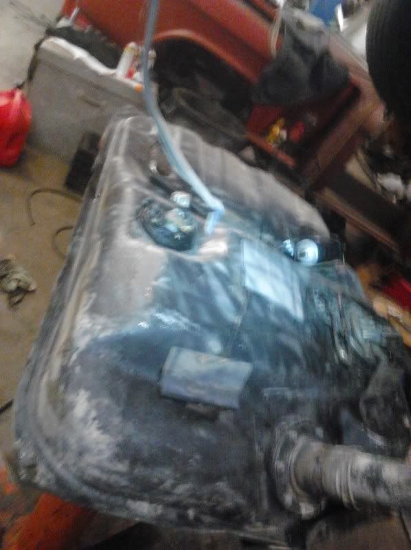

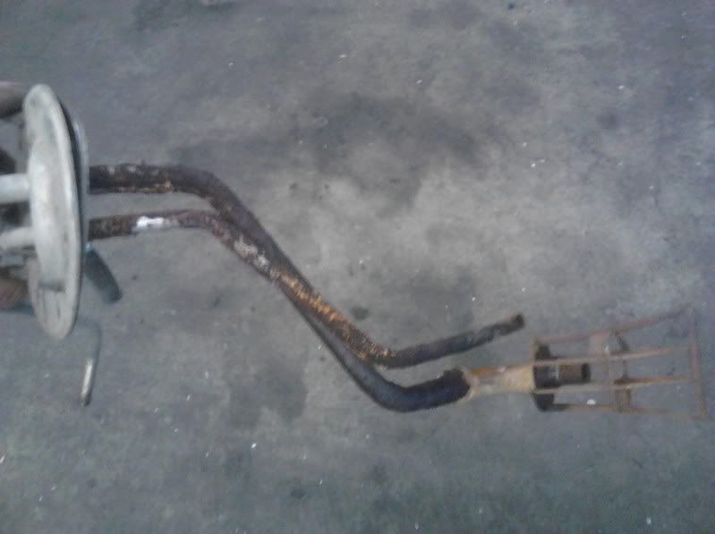

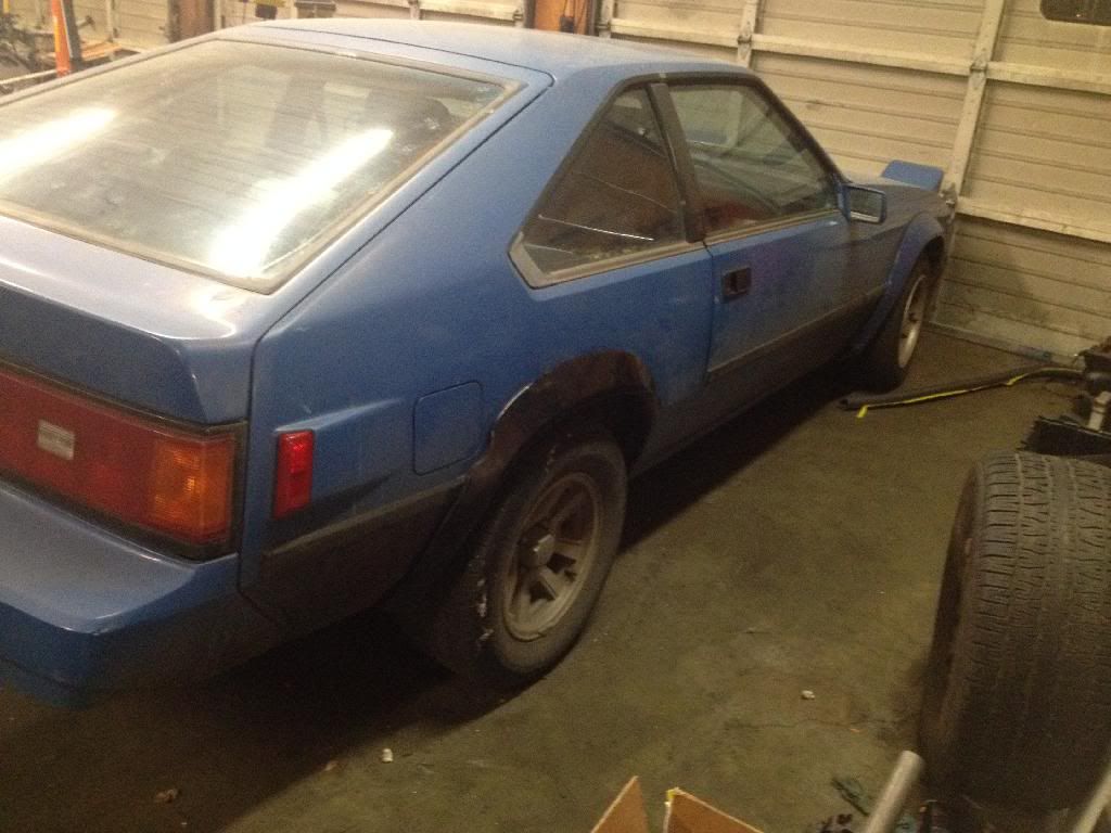

So I Pulled the tank. I said YOWZA
The inside of the tank didnt look much better. I scrubbed/pressure washed everything
The inline fuel pump had a pre filter and it already had crap in it so I flushed it out the best I could, and put in an inline filter just before the pump. Now instead of with a sock, Ill actually be getting any of the crap picked up OUT of the tank :)

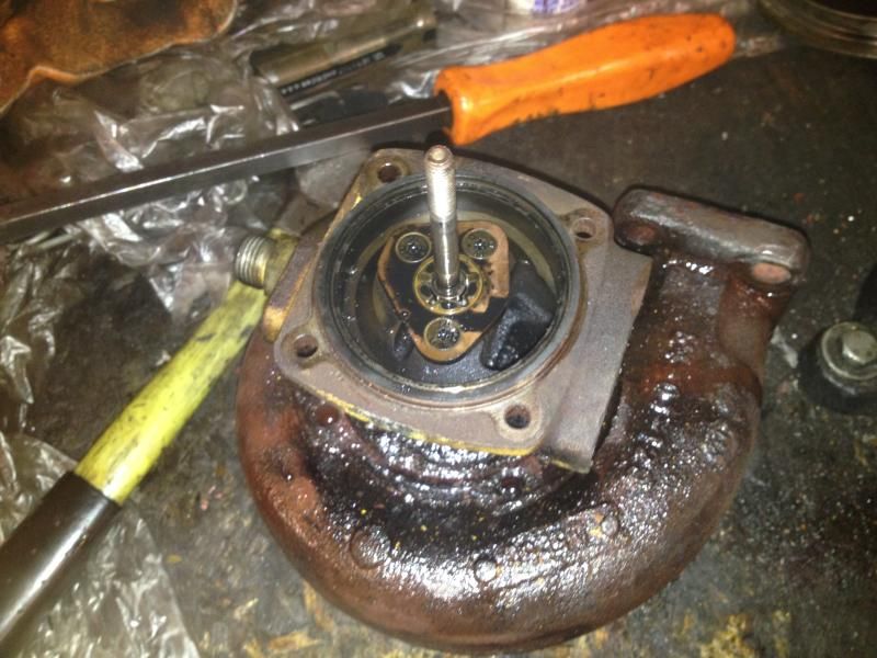

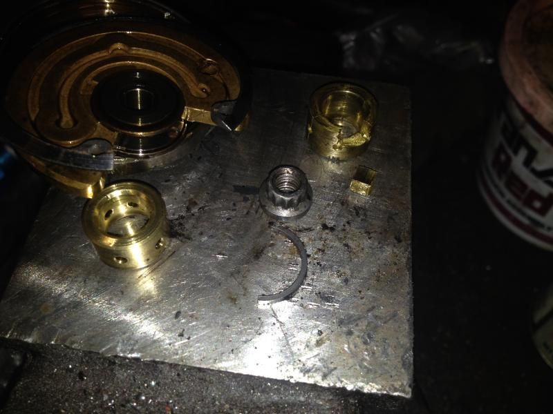

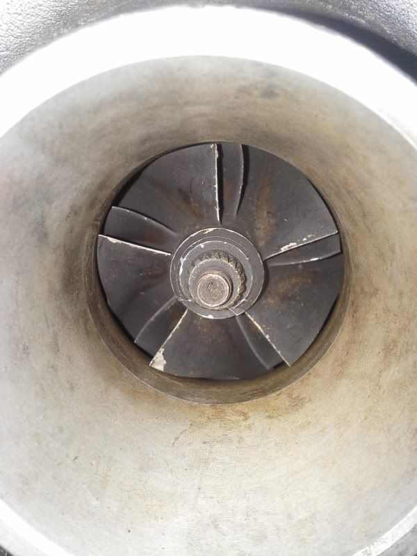

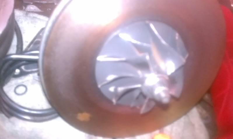

Turbo inlet before rebuild

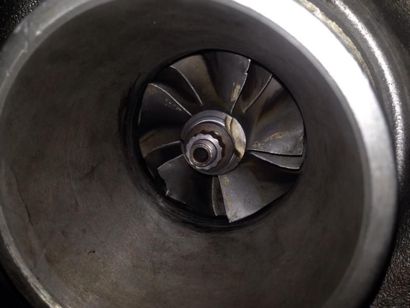

After

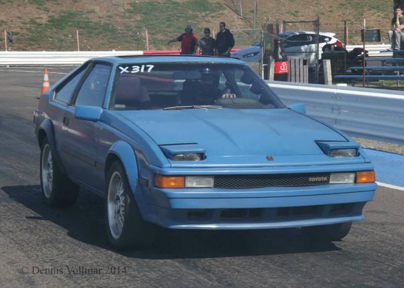

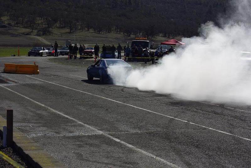

So I made it to the drags right before they closed for the season. Still on stock 7 psi boost, no tuning (wideband wasnt working that POS) and like most mk2's... no traction lol.
Impressed a lot of people, including me since i didnt even bring a helmet cause I didnt think I'd need it until I turned the boost up! So since then Ive been daily driving the supra off and on... the wideband started working, and after tuning and leaning the thing out the turbo started to hit harder, and its slipping the very fresh kevlar clutch. I really didnt wanna spend a lot on another clutch kit for the W58, since I have an R154 sitting in the shop, So Ive got a 6 puck disk on the way that Ill just use with this stage 1 pressure plate. Should be plenty for the W58. Ill also look at the rear main and try and fix some oil leaks. Ive got my first drift comp coming up Feb 16 so Im scrambling to get it ready. Theyre actually drifting in the staging lanes of the drag strip. Screw it right?

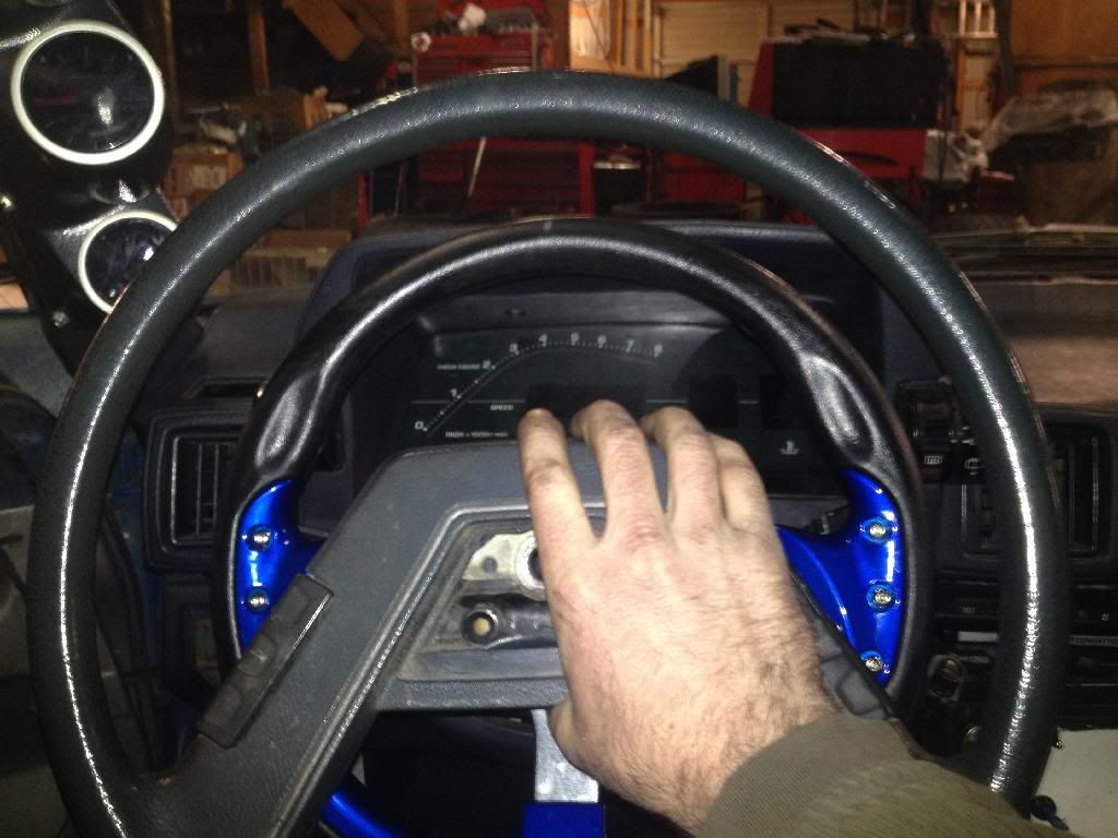

Still going on this thing. Gettin better and better. Tuned it out after the WBO2 started working, been getting some surprisingly awesome mileage! Better than the 2.0 DSM. I updated the steering wheel

P-type conversion complete! The 235s were rubbing so this fixed it. A lot more is in store here shortly, Im scrambling to get this ready for the drift comp so stay tuned

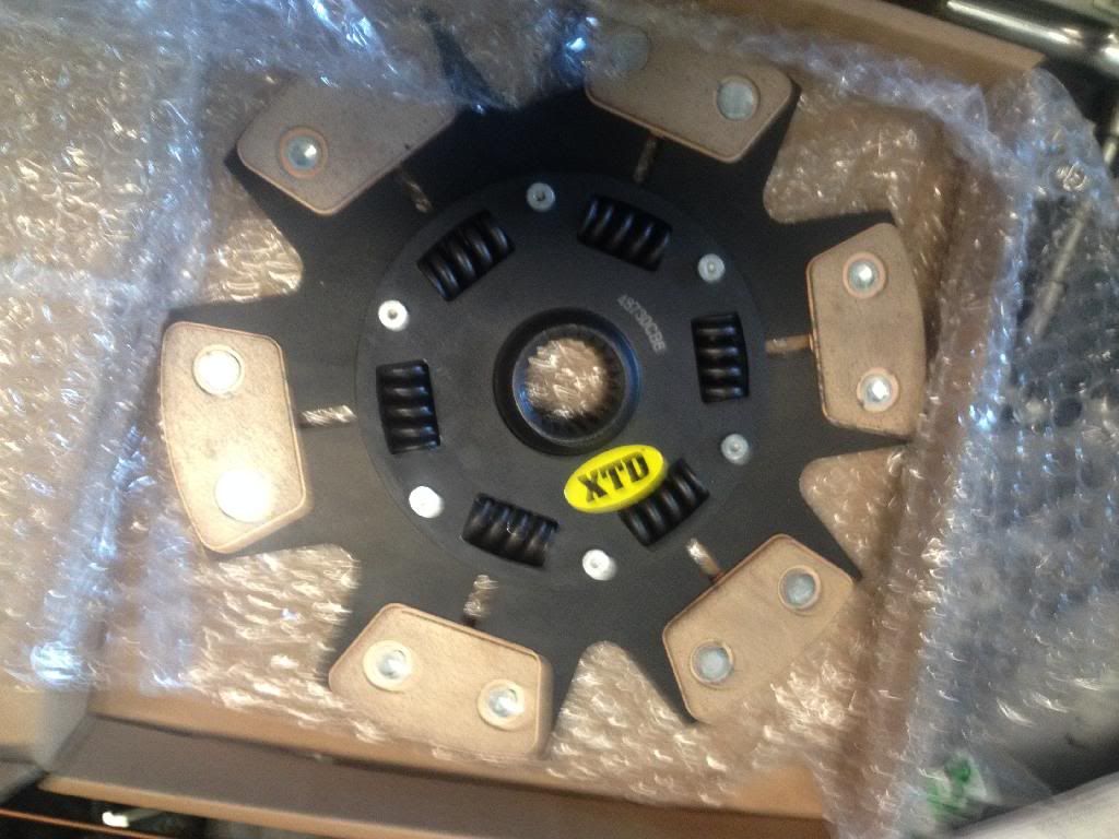

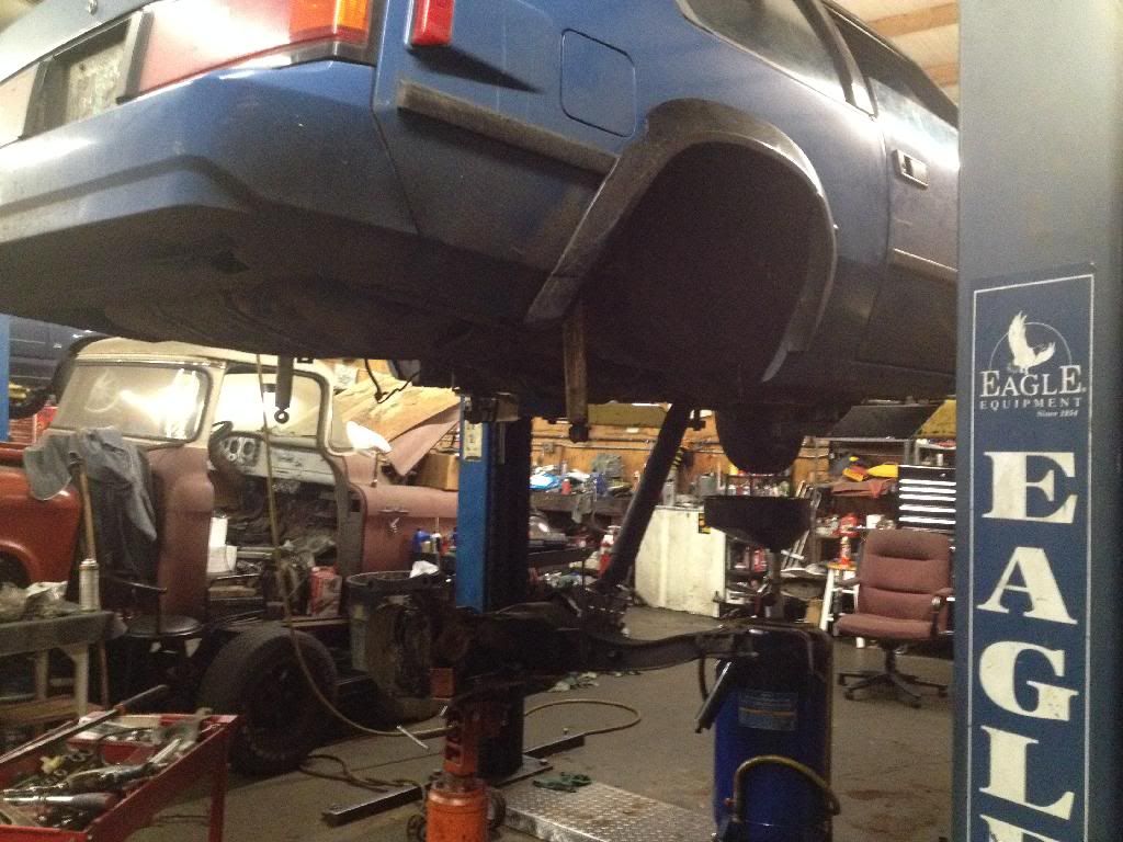

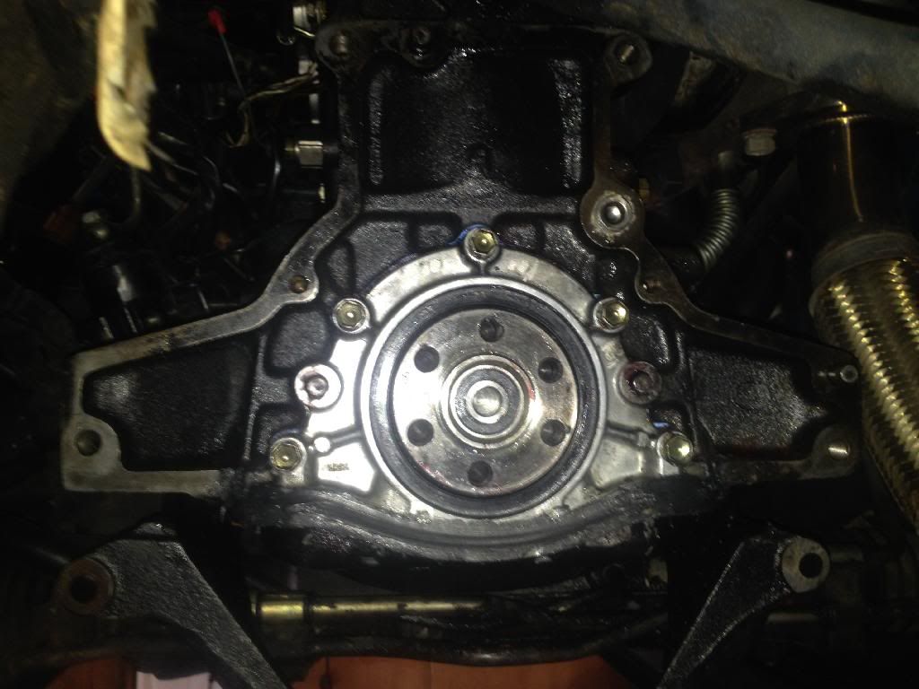

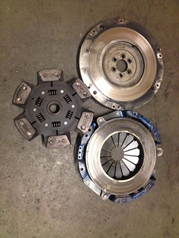

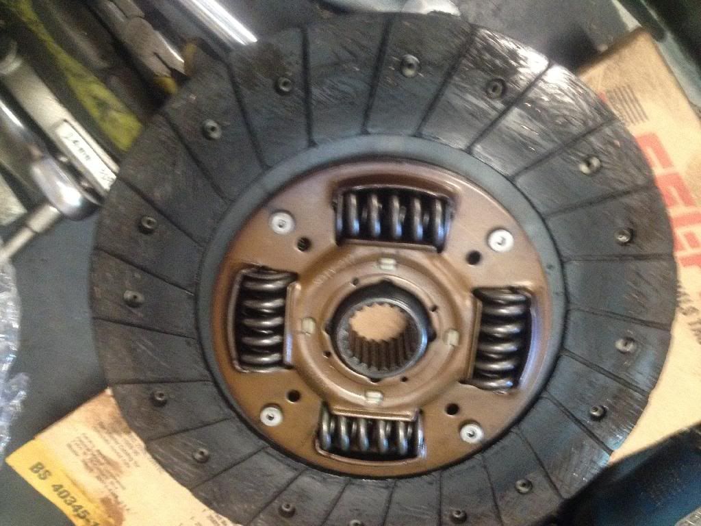

Clutch job
rear main

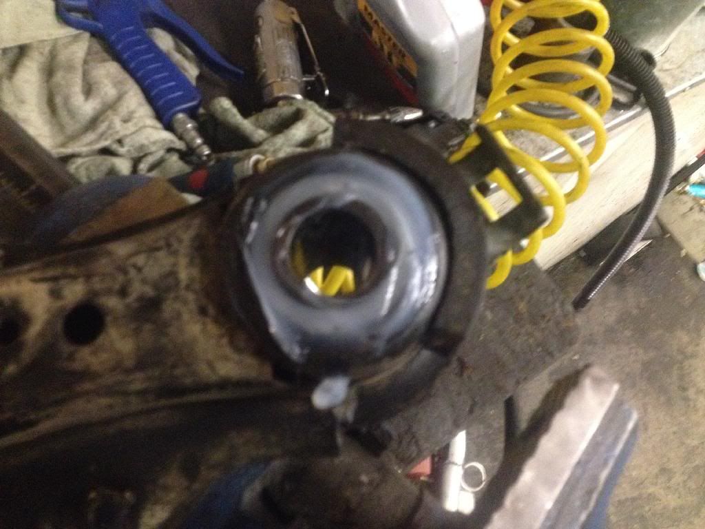

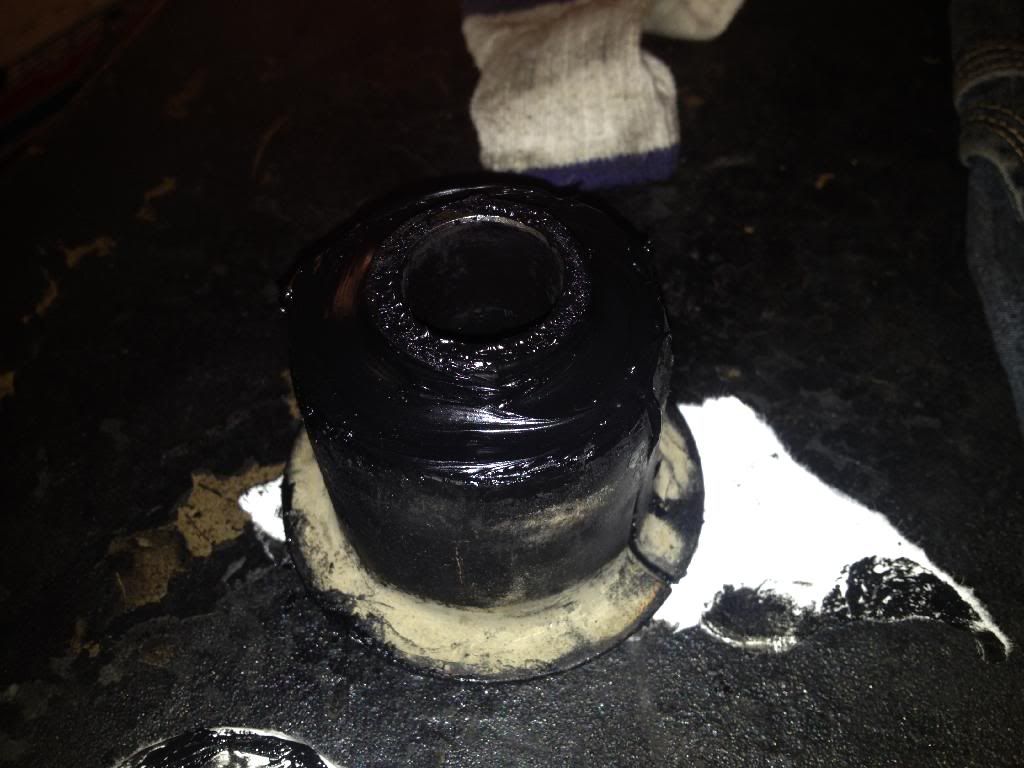

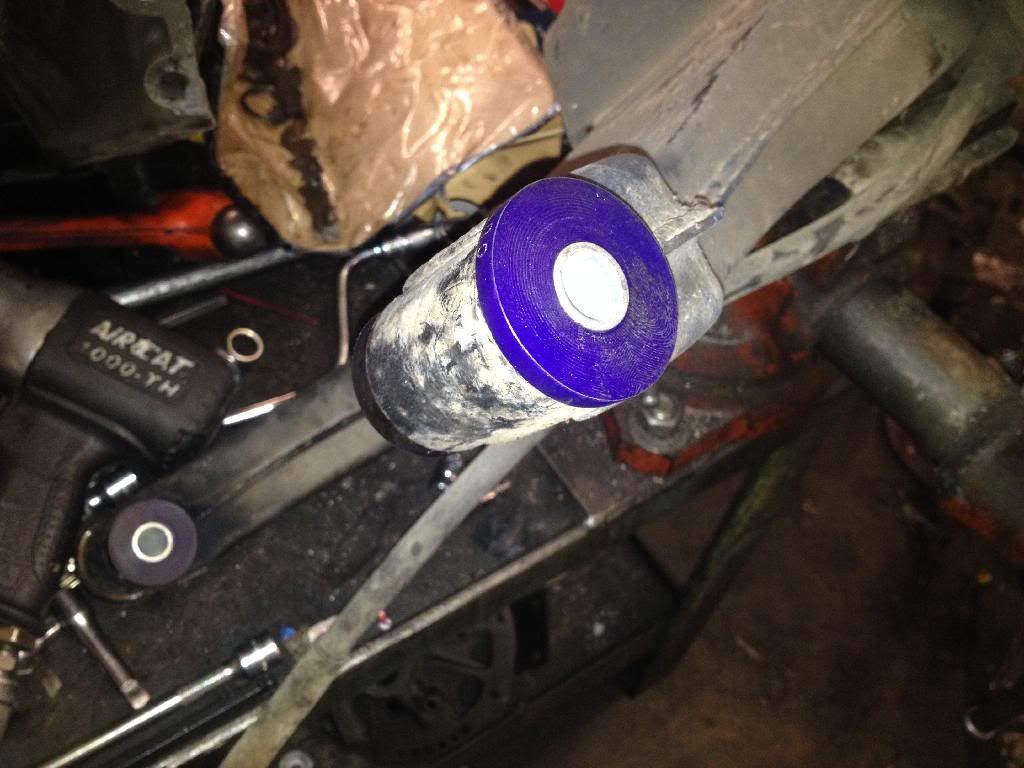

Pulled the diff subframe to do poly bushings...realized the full poly kit doesnt come with diff subframe bushings. Did an old DSM mod and filled them with silicone
mk2 supra
Nov 28, 2009
106
Oregon
Silicone too soft, window poly better

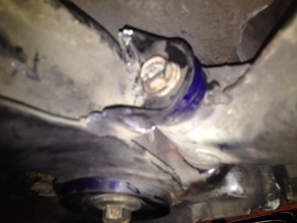

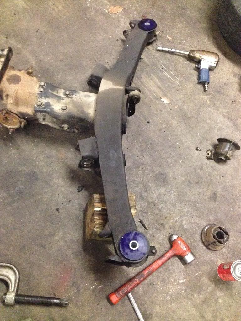

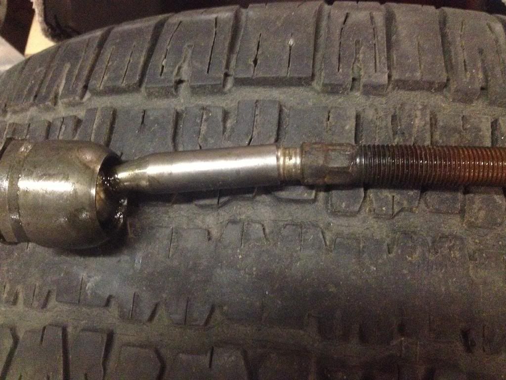

So this weeks updates- suspension, suspension, and more SUSPENSION! Still not even done either. Working towards stiffness and steering angle. So first off was fixing a bent inner tie rod
Next was centering the steering rack to get equal angle both directions, and poly sway bar bushings up front

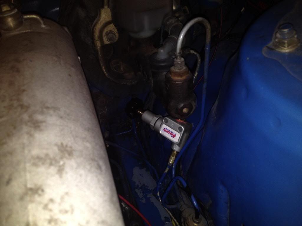

Adjustable brake prop valve, flush brake/clutch fluid
Poly bushings went in the rear control arms
and rear subframe

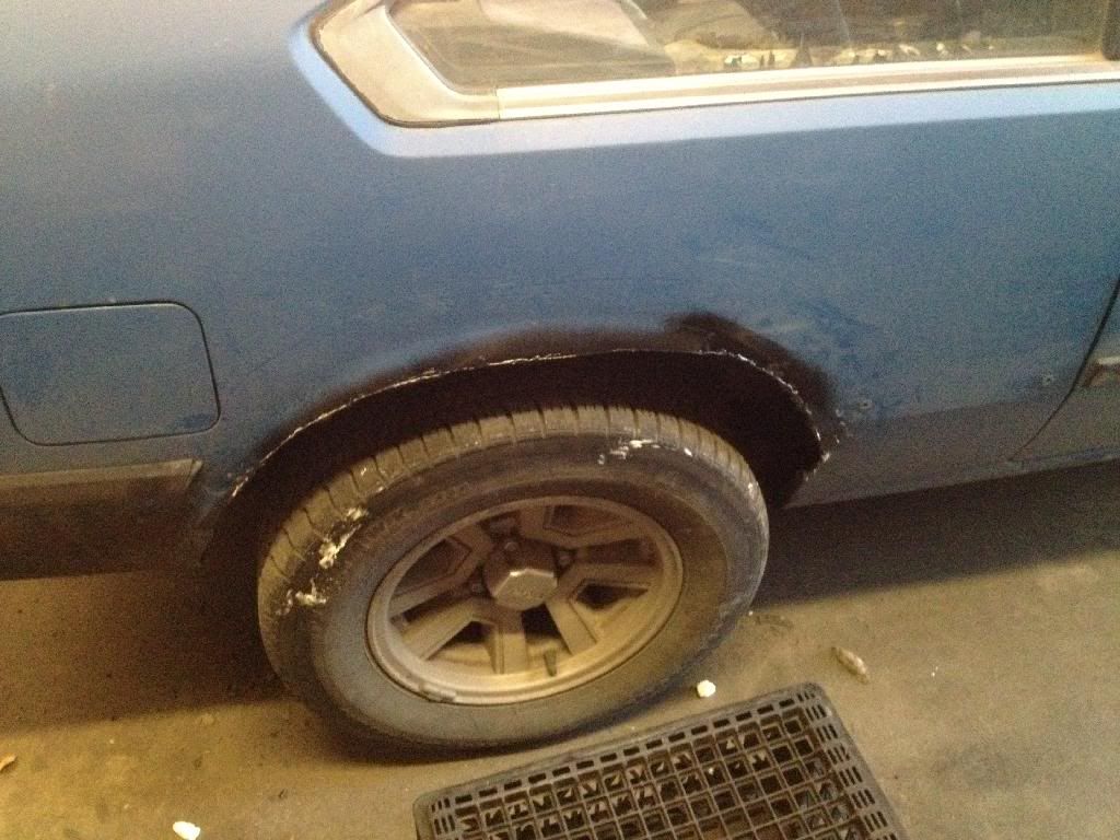

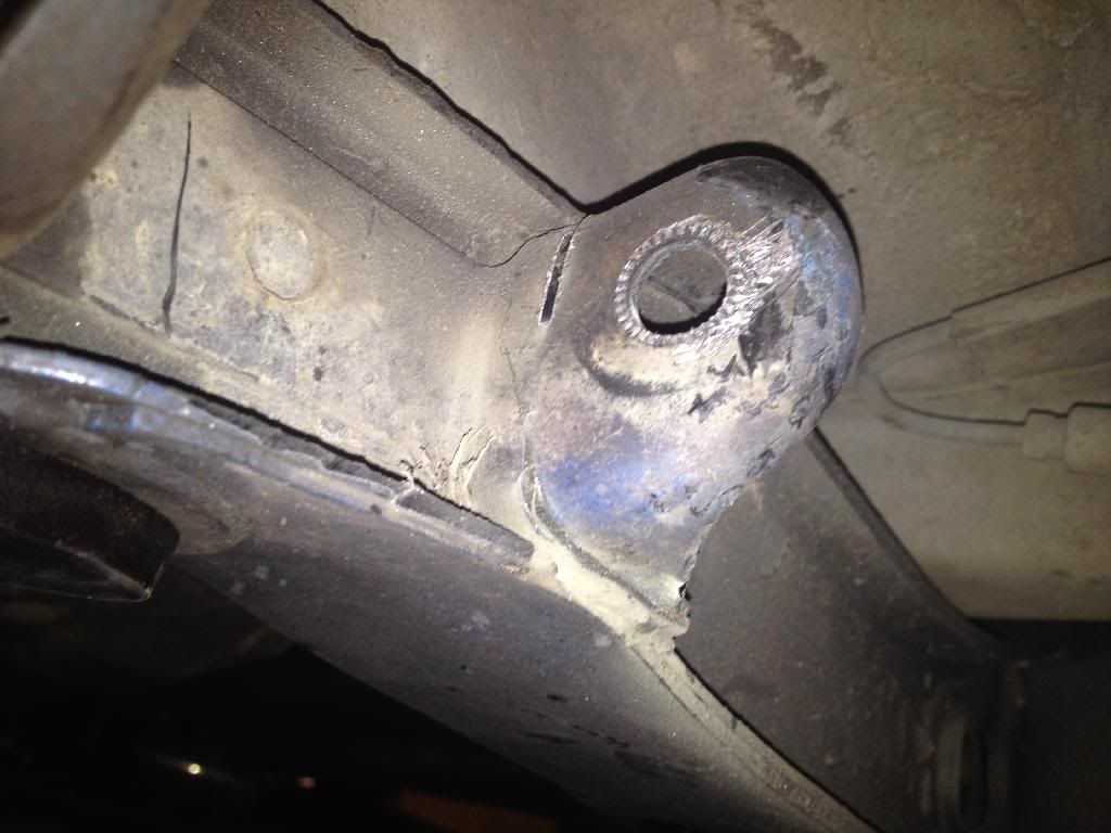

The control arms were wider with the new bushings so had to cut/bend/weld the tabs. That made it a real pain!!
So this was my weekend non stop. After fixing the rear main I havent had to add oil, which has been over a week! Thats new! Next will be valve cover gaskets for some small remaining oil leaks, a manual boost conroller, and retune

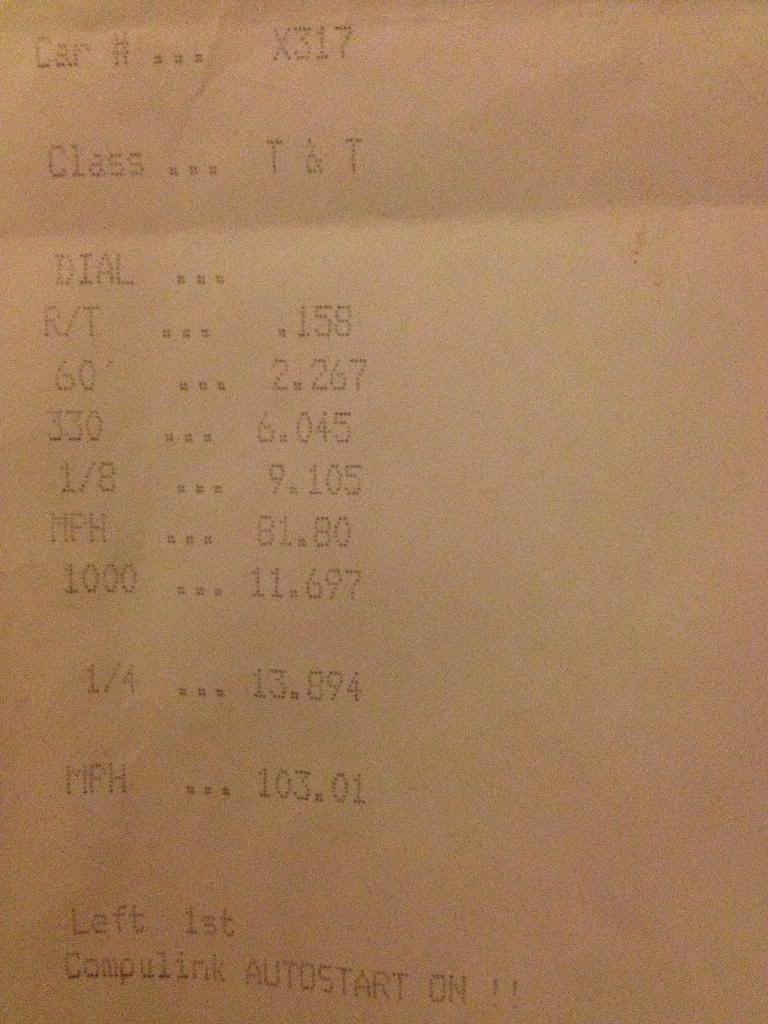

Some updates... Boost is at 12. I found/fixed some boost leaks. Got some 17s
Ran it at the track, did a tire burning 13.44@107

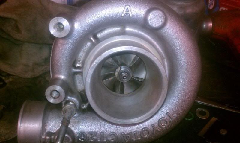

Updates-the CT went bad, again.

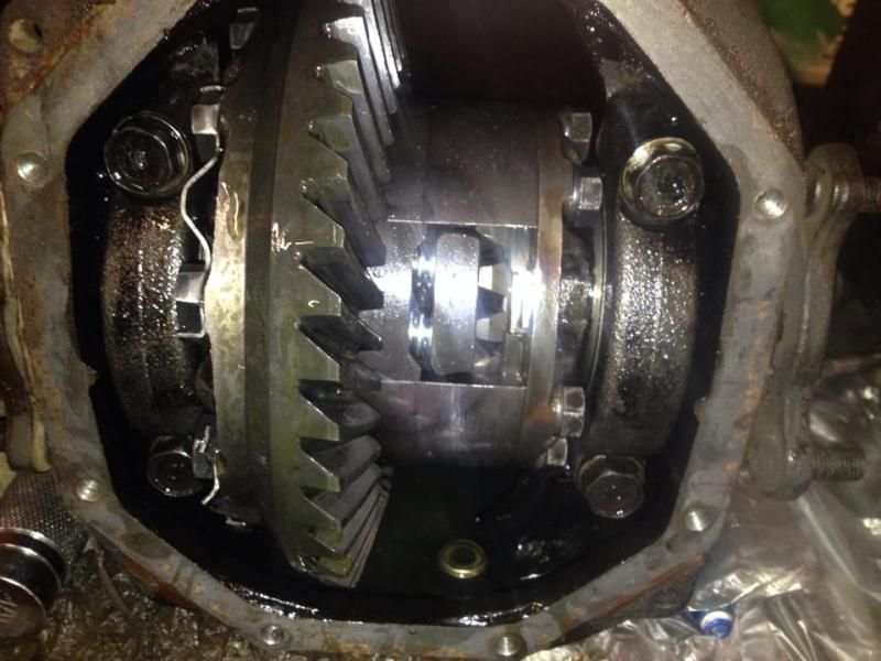

Rebuilt a 3.70 LSD rear with the Weir clutch pack. Tired of the welded 4.10, doesn't work for the car have to 4-5 shift at the track

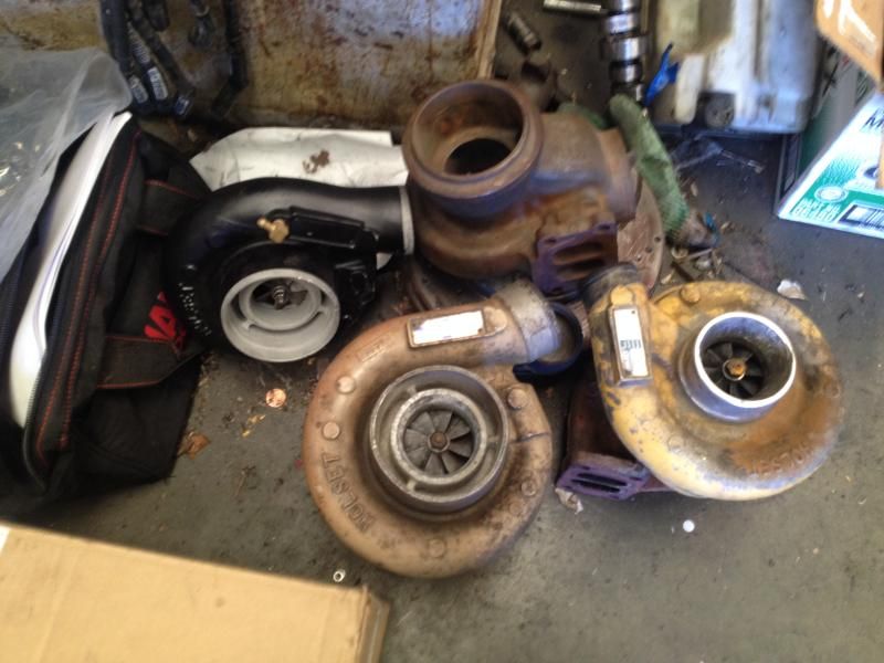

Okay, the planning stages have gone to the buying stage. I've decided on Doing an HX35 Build. Should be getting a lot of packages this week

Transmissions out, Flywheel gets resurfaced tomorrow, then 3.7 lsd rear will go in with new clutch
