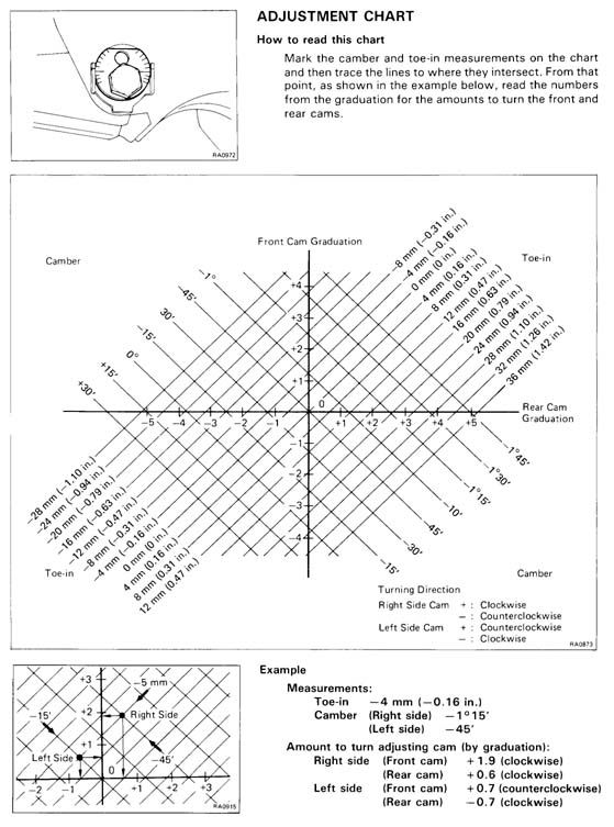

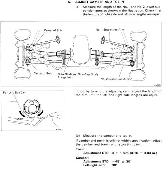

Camber:

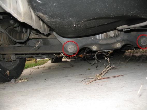

If you dropped your car, you now more than likely have negative camber. When you launch an IRS car, the camber moves to the negative. If you are already there, launching just makes your tires have a small little contact patch. This is a big reason why you dropped folks launch so shitty. Yeah your JDM dorifto million degrees of negative camber crap looks cool (to you), but it sucks for launching. Dial in a degree or two of positive camber before you go to the track. When you launch you ideally want zero camber, a flat contact patch. So if you are just a degree or two positive before you launch, when it squats you zero out. Perfect.
Where do you adjust it? Right here. See how easy it was to find it?
When adjusting the camber you also have to adjust the toe in to go along with it. Here's how to adjust both.
