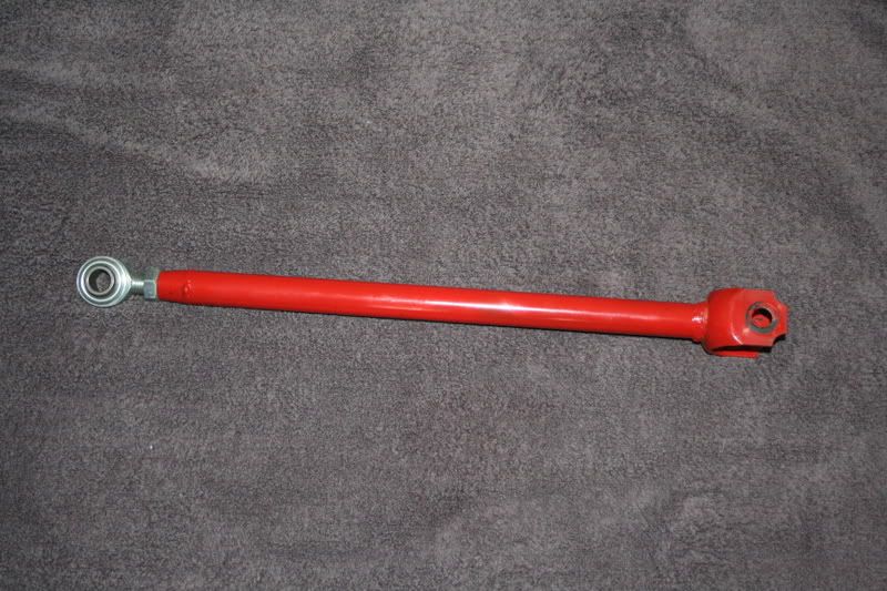

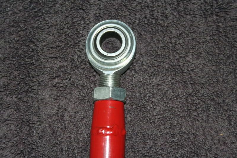

The lipp traction arms are pretty damn beefy, but the A1's are also better than what it came out with from the factory, plus the A1's have heim joints whereas the Lipp use poly bushings.

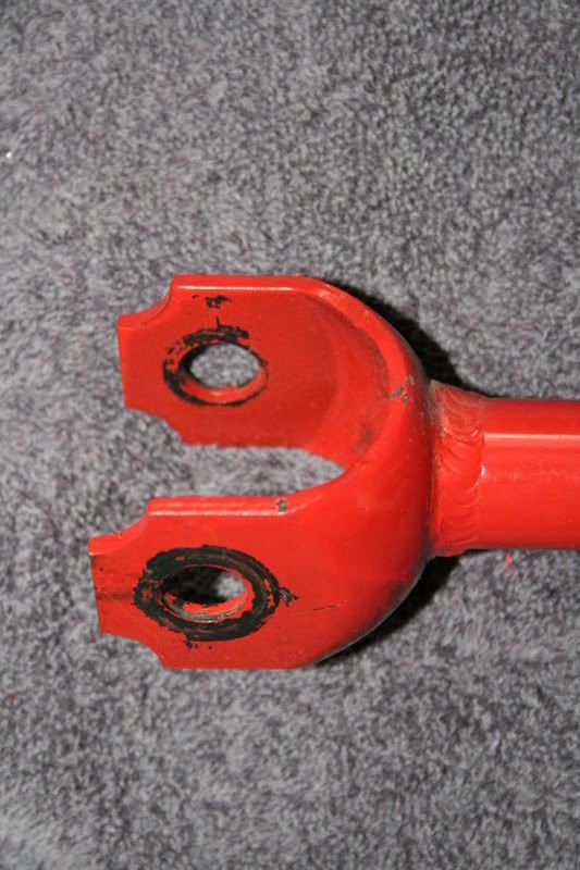

i bought the a-1 arm's.they don't replace the rubber bushing's in the spindle,so maybe some play there to contribute to wheel hop

pay a decent fabricator to make you some out of cromolly w/ a hiem joint and uses a 5/8 boilt
I built these.. what I ended up doing was sleeving the factory shaft with cromolly and adding the joint at the end it was realy simple and there is no way im going to break them unless somthing else is wrong
