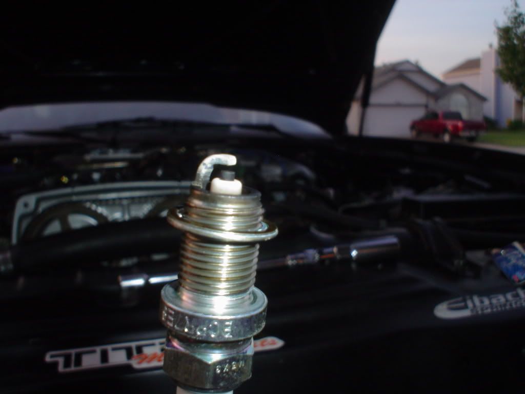

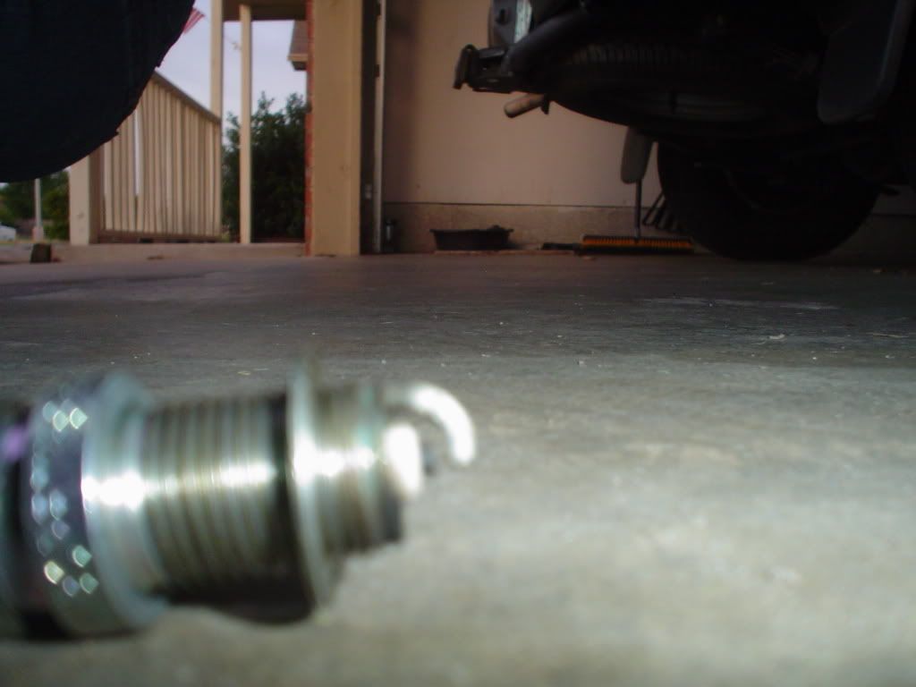

ok i replaced the plugs, all 6 with ngk iridium 1-step colder, part 3330..... and it ran amazing all the way to redline. after about 3 full pulls from 1,2, and 3 all the way to redline, after the three pulls it began to sputter. so i went home pulled #1 spark plug and this is what it looks like....i know the pics are big but i want you to be able to see them. the second pic kindof sucks but you can get the point

well i don't think it's low octane cause i'm running 91 (thats the highest we have) the timing i set at 12*. i found that page confusing as well i didn't see one that looked like it....maybe i'm retarded

antman said:
i believe your timeing should be at 10*
yea i know but would it being off by 2* be the problem....i'm not being an ass just asking a serious question. cause i've seen guys on here with their timing at 15*.....

don't know. i don't mess with my timing. i try not to gamble to much. i just let the ecu advance it for me.

mioght even be wrong heat range. how much boost r u running? im doing 94 octane with 14 degree timing.. my plugs kinda have that same white crap on them. im on stock ct26 though... 12psi
i'm running 91 octane w/ stock ct @ 16 psi when it doesn't sputter, no bc

mkIIIman089 said:
LOL, who sold those to you as iridium?
why? do you think this is my problem......i just looked it up and these aren't iridiums....:rant: .....now i'm pissed of....s o is this the problem?

well it definetly is a problem. i would change the plugs for sure.
of course it could be the problem
the base timing sets up the ENTIRE timing map.
btw you see guys here running 15 degree base so that makes it right? So if you see the next guys jump off a cliff into the sea to go drown (my lemming suicide influence in effect yet again) you would do that too?
