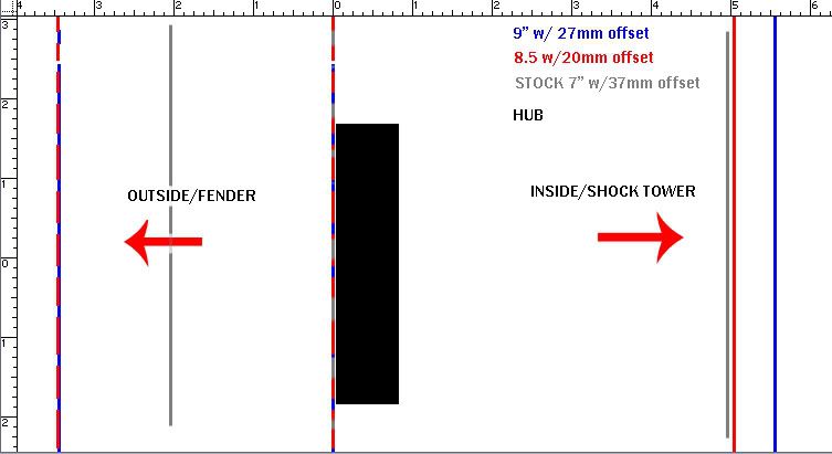

IMO, It would be close up front, but close enough that rolling would take care of any problems. If this info helps any: I'm running 17x9 27mm offset up front and I rub a little on the fender so I will have to roll'em soon.

Spacers would make things worse, like if he got 5mm spacers he would now have a 15mm offset :aigo:

Ok, I did a quick measuering job for you. Up front the 8.5" w/20mm offset will put the outer lip the same distance away from hub as my 9" w/27mm. Here is a pic I did and it is all to scale.
