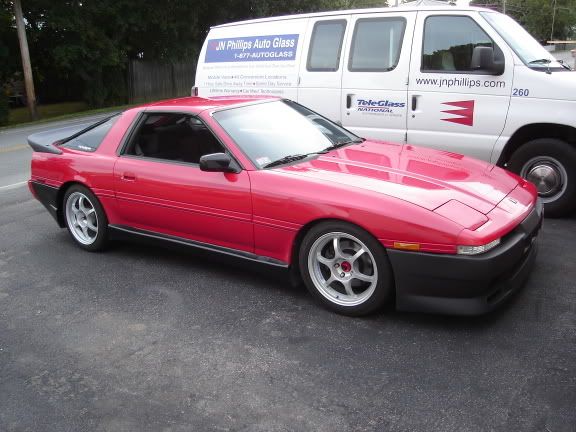

my supra on the side of my work van;)
Equalizer!
I wanted to make that same point, but was afraid I wouldn't do it properly. Man, that truck is eerie........my boss's name was Phillips back in the ole glass days.
