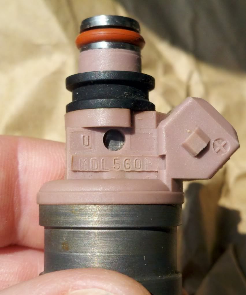

In my town right now on Craigslist guy has I set of evo 560cc injectors($150) came off a dsm will they work with a Lexus afm setup ? If i get a apexi safc to tune?

I wouldnt mix and match injectors. Who knows what there actually flowing. Yes you can use those injectors. Just make sure the impedance as to weather or not you need the resistor pack.

If there high imp you dont need the resistor pack. If there low imp like stock then the resistor pack is on the drivers shock tower.

Idk what the pig tails look like but you might just need to shave off the locating tabs and push the connector on.(not to be confused with the tabs that lock them in)

ya the pig tail is the connector and some wire. Doesnt plug into harness usually have to solder them in or get a jumper harness.
And ya you will need pig tails. Think there the same as rc.

I just picked up a set of 6 Evo 8 injectors today.
You need Bosch EV-1 type connectors. I just got 6 on Ebay for $35 shipped.

these injectors are like OBDII....i think... you can find a car with the same fuel injector setup and go to Autozone and request 6 injector pigtails for that car....i think mine were off some mid 90s olds. and they worked! bout the same price as others just no ship and way more convenient!
