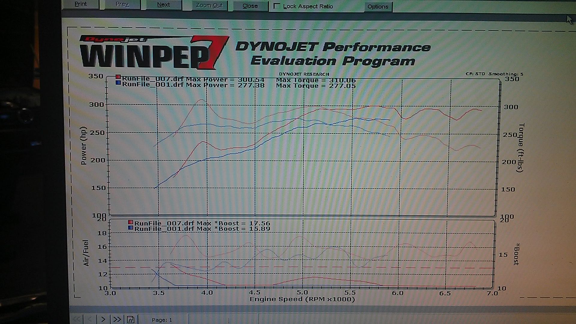

Completely stock motor here putting down 300 whp 310 tq. On 17lbs emanage blue and it ran fat rich 10.0 thru redline

Moves the band forward more.
Boost comes on more gradually and doesn't "hit" like a freight train like the stock cams. Full boost comes on later.
Pulls harder and harder until 7600 which is my limiter, Im sure it would go just as hard to 8k.
