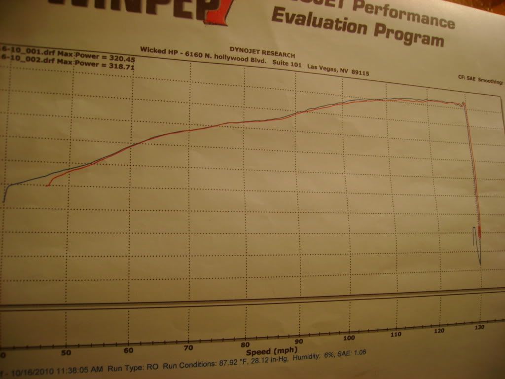

If my dyno sheet is to be believed, power doesn't fall off with stock ~7200 redline with the 264's:
53

mr2thomas;1681741 said:
te72, what engine mods and boost are you running on that dyno chart? i like this alot!
johnd;1681762 said:
I'd like to know what turbo your using also?
Power number was at the top there, only 320rwhp. Still on stock twins, that was at 12psi because I couldn't figure out how to set up the boost controller to run 15-16 at that lower elevation. Only mods are the BC264 cams, a port and polish, and 3" turbo back exhaust. Even had the silencer on the Blitz in when I dyno'd, not sure what extra power *might* have been there if I had removed it. Hell, I'm still on the stock air box. :p
