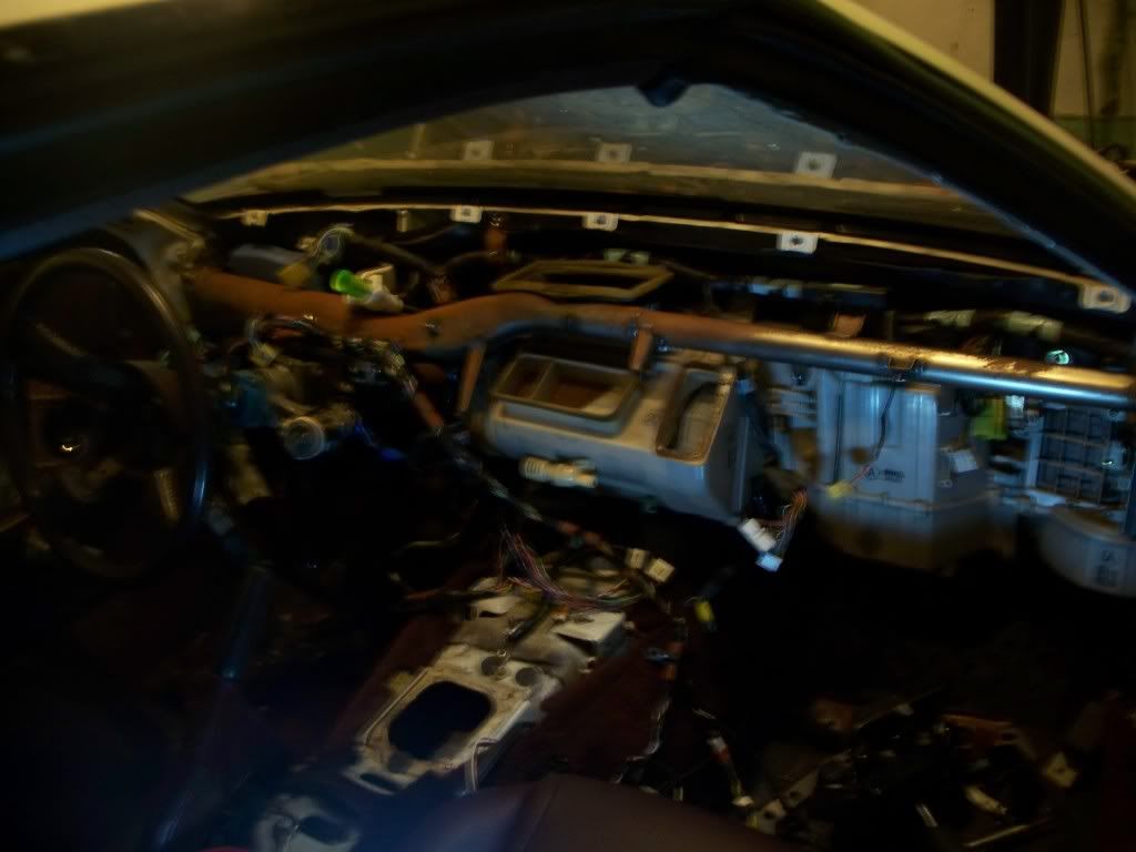

Yay, I got my new dash harnesses in today. Within 2 hours I had the main dash harness in, HVAC back together, dash bar installed and part of the small dash harness is throw together in there too. Hopefully I can get the camera out there and get some pics for everyone.
Anyone know if there's a control box for the power windows in these cars? As stated above I got the main harness hooked back back up, but the windows no work.
Also will there be any massive side effect of not hooking up the ABS plugs in the engine bay? The main harness I got is from a non-ABS car.

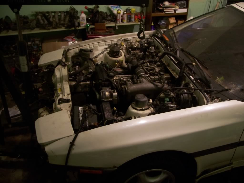

rawr! progress! Engine came out, hardlines got swapped, tranny plugs hooked up, vent pipe (side of valve cover, near oil fill) installed, ISC and TB coolant lines ran. AND engine is BACK in, and here's proof! On a side note, went and picked up another toy for the other project, I'll get pics tomorrow.
Also never mind about the power window thing, I was a tard and forgot that without the key being turned they wouldn't work, and key doesn't do much of anything if the ignition isn't hooked up.
