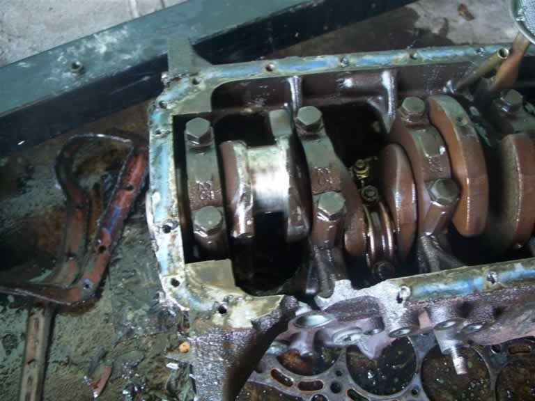

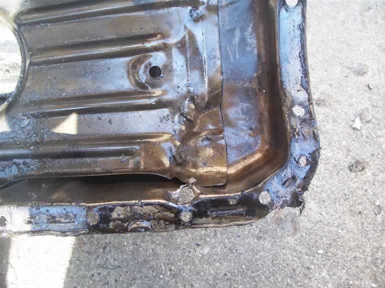

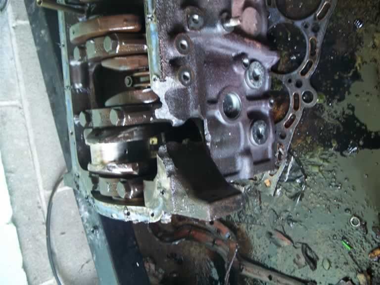

Well got the head off, took the pan off, the piston wasn't even the entire top, and had a rather good sized hole in it. Found atleast 6 parts of the rod floating around in the pan, and some more hiding between the baffle and pan. Oil pan is trashed with a 1/2" hole in it. I will try to get some pictures up here soon, after I get the garage cleaned up. On a postive note, head looks great, no noticable damage done to it at all, but I will send it to a machinist for inspection.
Also I guess I cannot use the CPS or coil-packs on my GE harness, so other than completely converting to GTE harness with ECU, I don't get to use them :-(. So they will be for sale soon.

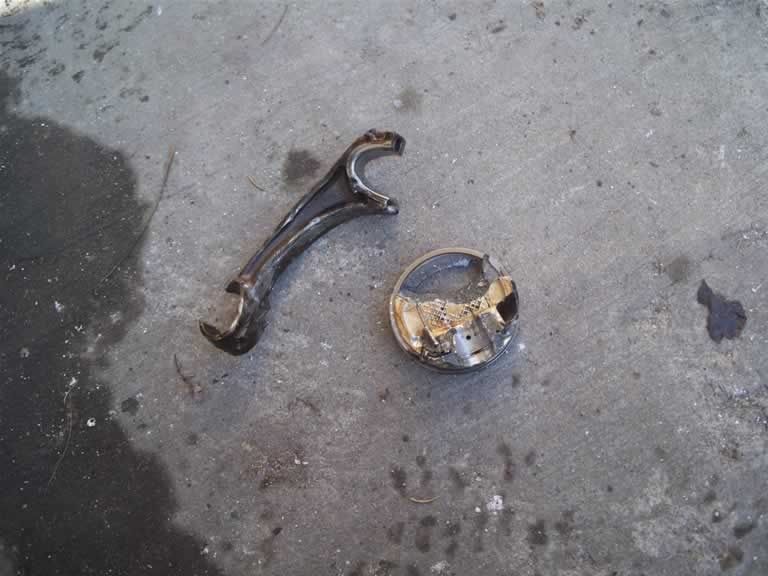

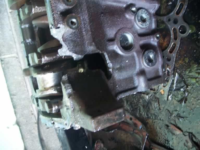

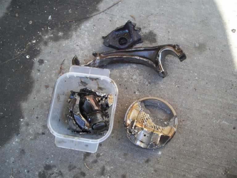

Since everyone loves pictures, here are some of the damage from the rod, including what's left of the rod and piston on cylinder #6.
The little bowl is some of the remains of the rod and piston that were left in the engine, there was still alot more, but I was lazy and pistons aren't magnetic, so I didn't feel like fishing them out. Piston gave out between the 2nd and 3rd rings, and completely exploded. From what I've seen of the bottom of the head, does not look like the piston touched it at all. I set the block out on the curb, and within 36 hours it was gone (gotta love scrappers), tried to get the crank pulley off, but even with impact and a old tire iron in the crank bolt wouldn't come off, so it went with it.
We have started sourcing parts for the swap over of my old 7mge from the Cressida, as my GTS is at the shop being fixed and will be driveable soon, and the 2jzge is at the machinist, so HOPEFULLY I can get the supra running in the next couple weeks and iron out all the little bugs and test out the suspension. Buying a new targa bolt didn't help anything as the former owner was using a larger bolt and stripped out the top, so I placed a washer on the bolt to give it something to grab on, and now seals. Need to go pick up an interior clip tool and start removing the passenger side door panel and see why the window won't top out.

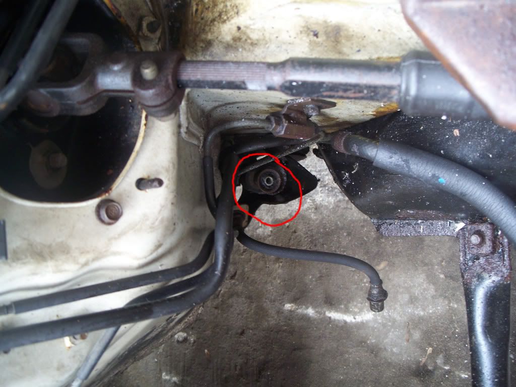

^ you need to get a better pic....
It looks like either:
1. a soft line thats been ripped off
2. that stupid anti-jerk thing they put on auto cars
3. the clutch slave w/ the pin pulled out
Thats all I got...

Well it's not the clutch slave, and the car is originally a 5spd turbo. I will try to get a closer pic.

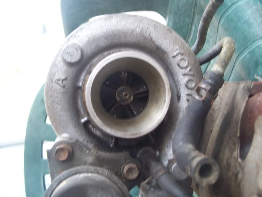

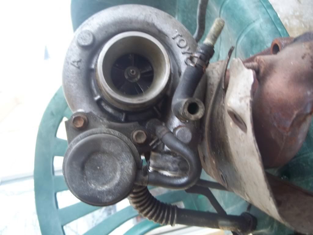

Well today is picture day for the business, and I figured I would drag some parts up into daylight (can't say sunlight, cuz it's a misty nasty day). For crisp that wanted to see the wheel of the turbo:

Good memory!
Yup... I'd say STOCK on the turbo. (It had "machining" like appearance from the earlier view... but that taper and entry dia. is very much consistent with the stock CT.;)
