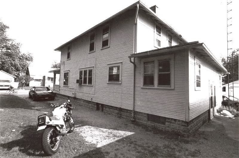

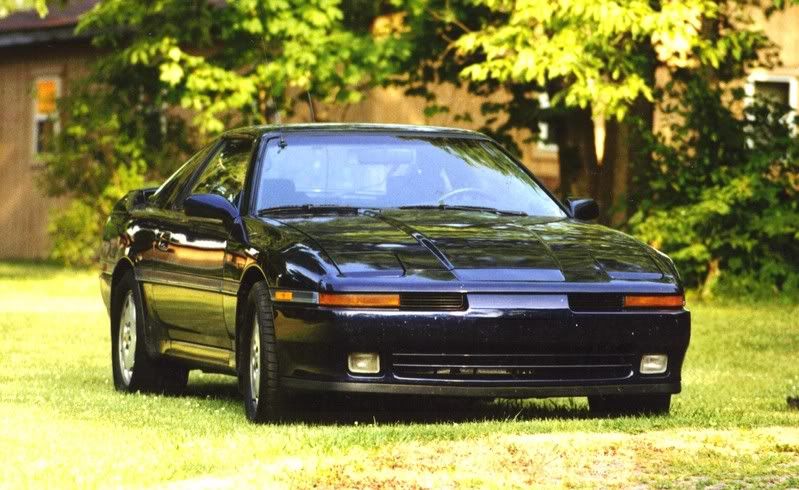

Hard to really tell in these shots, but the '89 turbo is running 255/50/16 BFG Comp T/A ZR's and the '87 NA ran 255/50/16 BFG Comp T/A VR's for many years. It was a VERY tight pinch on the sawblades, and I wouldn't recommend it, as the rubber "fatigued" over the years and began to "dry-rot/crack" where it was under such duress on the sidewalls. (Of course, the turbo car SAT for several years in harsh weather with the rubber on un-used for that time, which didn't help...)
I think 245 is a maximum that still maintains a decent profile to the road. I believe you LOSE some contact/traction with the tighter pinch... but I sure had a BUNCH of sidewall and good gumball rollers look! DONUTS for tires!:biglaugh: I actually always liked that setup...
...then again... I remember I had 245's pinched on my '84 back in the day on the stock rims!
^^^ Can't tell here, but that's some 245 rubber on my first supra. Always LOVED that black car with the lowered/aggressive stance! Rode like a go-cart... and screamed even after over 200k miles of abuse! Still ran when I sold it for $500 shortly after this photo... I think it finally seized a cam at the quarter million mile mark about a year or so later.
