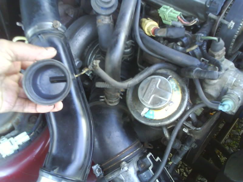

where does this wire go (its yellow with a black stripe and has a rubber cap thing on the end.. )
just a quick correct answer.. no need to discuss anything thanks
oil pressure sensor and its on the block next to the oil line for the turbo(not the oil return line). its domed shaped and that connector clips on top of it.
probably have to take off that intake hose
Shouldn't have to if you do it from underneath. I had to rewire mine and I was able to get at it from underneath.
