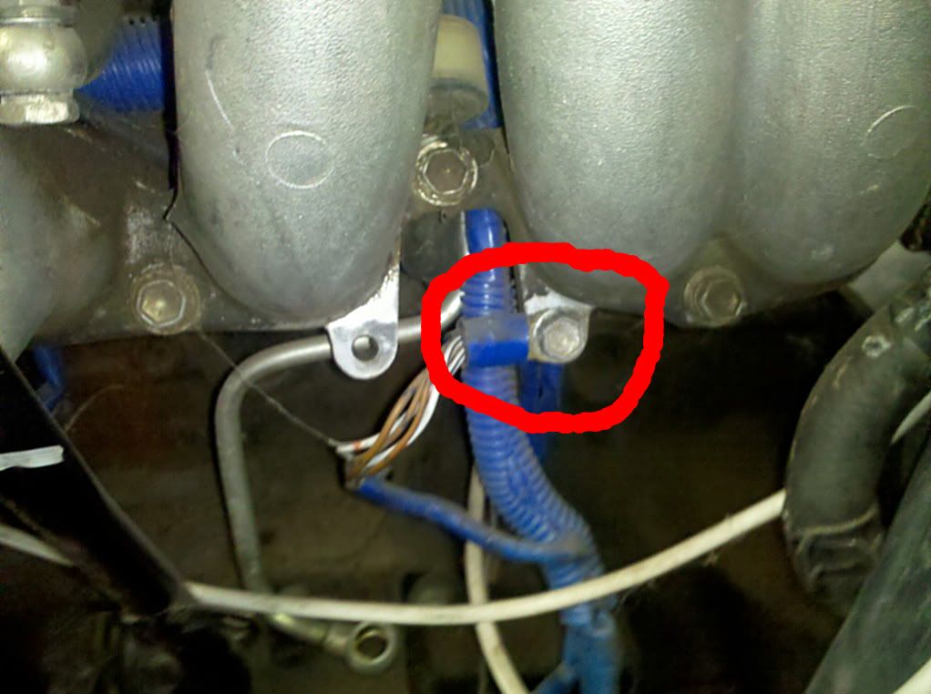

Where do these attach to?
Van
87t Hardtop
974
Oak Grove, OR 97267

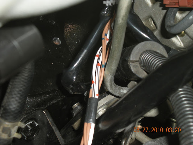

These wires are under the intake runners and I have no idea where they attach, or even their purpose.
Thanks. Van
radiod
Dec 13, 2007
1,342
Abbotsford, BC
I had the same question when putting my engine back together. I was told they're grounds for the ECU. You'll want to make sure that they're clean and the surface you're bolting them to is clean as well. Any of the bolts that hold the two halves of the intake manifold together will work fine :)

Brother! Those wires were connected to the battery positive pole of the starter when I tried to start the car last Saturday. It also caused the fuel pump relay to chatter and buzz. I disconnected those wires last week after another forum member suggested I had those wires connected wrongly. So now I'm not getting spark. Plug wires and plugs are new and within specs, the CPS and Igniter are newly rebuilt and in spec. I metered all the coils at 4 ohms (corrected). I note the TSRM has coils spec 2.4 - 3 ohms. So, they may be the cause for no spark. What do you think?
I'm guessing the ECU was damaged by sending voltage through the ground wires. That'll be the next item to sort out... tonight.
The engine turns over but won't start, due to lack of spark. Van
