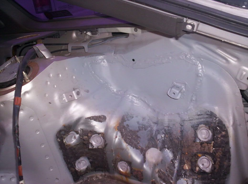

Looky what surprised me when I looked under the carpet in the hatch. :1zhelp:
Questions:
1. Whats the best way to remove the rust? Does that rust dissolver/converter stuff work?
2. How do I repair the damage and make it rust proof?
3. Whats the best way to avoid the rust next time?
4. Is this the worst you've seen?
Oh and I have found where it was leaking I think. One of the screws for the bottom window moulding was missing and the bolt was rusted quite bad. So I think it was coming from there, its all taped up now, I'm just waiting for a rainy day for it to proved. (We are on water restrictions where I live otherwise I could just use a hose.)
Thanks!

That really doesnt look too bad. Try to clean the rust away, first. Hopefully it is just on the surface. If that is the case, after you remove it all lay down some nice rust inhibiting primer, paint , etc. Whatever you prefer. If its not just on the surface you are going to have to cut and reweld in new sheet metal. Also check your tailight seals and hatch seal. That water had to get in there some how.

My wheel well has some slight rust as well, not nearly that bad, but similar. I just got a roll of shop towels and started to get all the loose oxidization off and it looked much better. I need to try to sand that like crazy sometime...

that's not bad at all.
now that I've tried them, I'm a fan of POR-15 products. grab yourself a starter kit from here. you may need to buy yourself some more paint as they can they give you is tiny.
http://www.por15.com/
their kit comes with degreaser, and rust neutralizer that eats away some rust and puts a zinc phosphate coating on it. It converts the rust to iron phosphate so it won't keep busting off new oxygen atoms and continue to rust. the zinc helps the paint stick. The kit also comes with their world famous very strong paint. the stuff goes on smooth, it's gas/chemical and water proof and if it gets scratched (hard to do) rust won't bleed past the scratch. It's so strong and flexible it can even be put on a piece of metal and not be cracked or split. well worth the money. I just fixed my leaky hatch with this stuff in conjunction with their epoxy putty.
of course, wire brush it as best you can before you put it on. the less rust the better IMO. However, the reps tell me it actually adheres better to rust as there is more of a "tooth" for it to hold onto. don't get the stuff on your hands! the only way it will come off is with the natural oils or your skin...which takes a couple weeks. also, scoop the stuff out of the can into another container when using it. If you get any in the lip of the can, you won't be able to open it. Put some plastic wrap between the lid and the can to help aswell.
hope that helps.

+1 to the POR15 stuff. I had a hole in the EXACT same place. I used phosphoric acid and POR15 with the black rubber paint on top.
