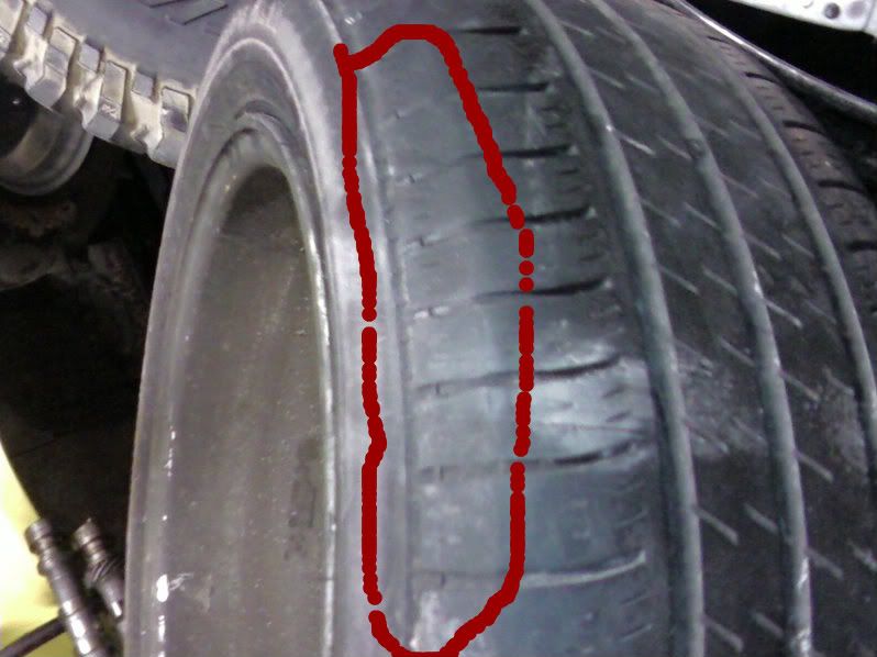

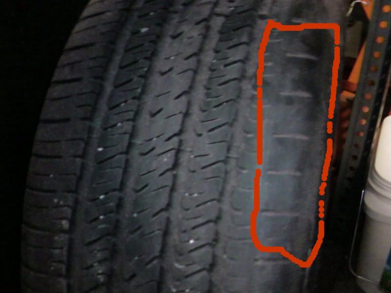

I know what bad camber is.. I probably have more then most on this forum. But as long as the toe is still in spec the tire camber wear isn't going to be super bad.

this wear is a little hard to see cause of my weak camer phone but its practically chewing into the sidewall almost, I just dont want to be buying tires all the time because I end up with a week side wall.
this one is a lot more noticeable and you can only imagine how much more its going to end up wearing with it lowered
