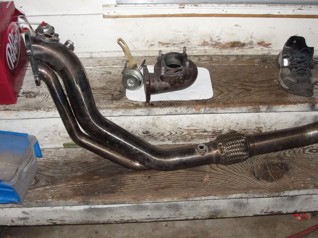

The wideband should not be in the elbow, it should be about 2 feet behind the it. Reason being, if the sensor is too close to the turbo outlet it could overheat and signal incorrectly.
You want it sonewhere around here to be really safe (look next to the flex section):
I capped and never used the forward position bung.
