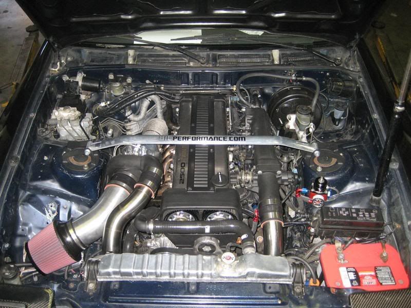

when.....anytime.....the car runs great except it won't boost....I've jumped the ecu to see what error codes come up but the check engine light must have been wired wrong by the previous owner. It revs up great but just won't boost. I've cleaned up most of the boost leak, just waiting for a couple more t-clamps...its running lean..white ash on the spark plugs...its possible that its a vacume leak somewhere, the previous owner took out the egr so I'm not sure how I'm going to get it through emmisions.

well if you've got tools I'll bring my car and the :drink1: :icon_bigg The car runs excellant, it just doesn't boost. Idles and runs great, as soon as I hit 1 PSI of boost :evil2: fuel cut, I jump the computer for error codes and the check engine light doesn't work. so this week I'm going to wire in a new check engine light. Hopefully when I have some codes it will be easier to find the problem

are you using a the stock boost gauge? cause my old gauge did that to me but i was properly boosting 9-10psi but the stock gauge would show 1 lol and hit fuel cut. try to borrow a aftermarket boost gauge and see if you hit any boost. but dont forget to disconnect the stock gauge as it uses a boost sensor. try that and see what happens.

I've got an aftermarket boost gauge, but I don't think its installed very well :sarcasm: but I didn't put it in either, my vacuum lines are all fubar so I know I need to go through those and reroute some stuff. I think there is a ton of small stuff to do to the engine, its just misleading cause it sounds so good when I start it up :naughty:
