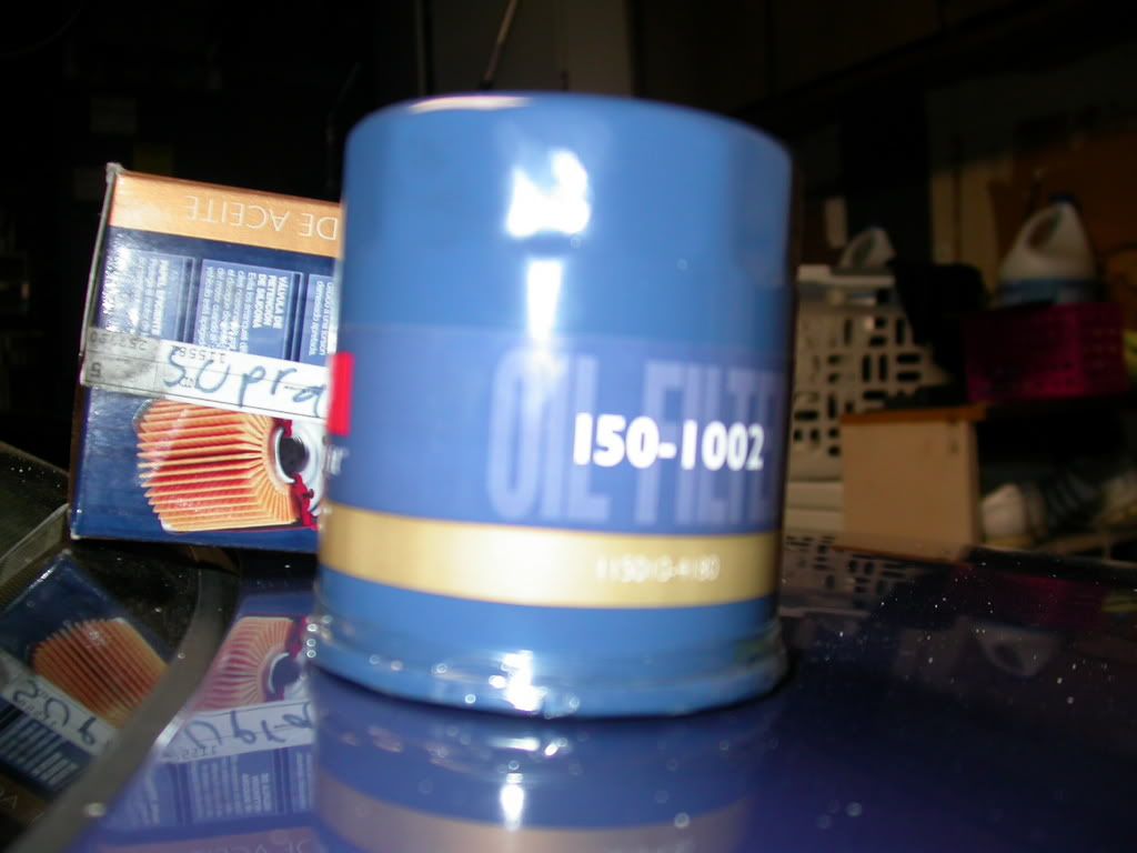

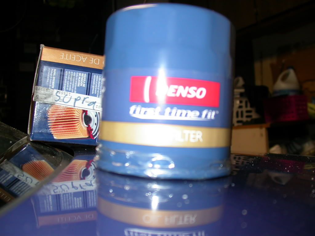

(EDIT: Sorry, I'm bored, lol. Just curious if you were using the Denso USA ones, as I was considering them a while back and never got really great pictures of them IIRC... maybe I did, was just curious. I have the Made in Japan 10004/20004 filters now though, and plenty of them, so no worries anymore, lol.)
